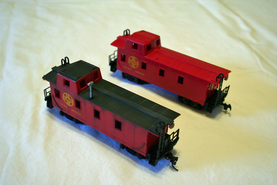

The first thing I always use on my Tyco and other "toy" rolling stock (about 75% of my collection, really) is my "Lick of Paint" rule...all it takes is a little paint in the right places to make even an outlandish Tyco car blend in with Athearn, Accurail, and the like.
Take this comparison shot of two Bachmann trainset-type Santa Fe cabeese, for example:
All I did was paint the roof black and weather the sides a little, and add knuckle couplers in the original pockets, but it's obvious which one a rivet counter might not notice at the end of a string of Athearns and such...
