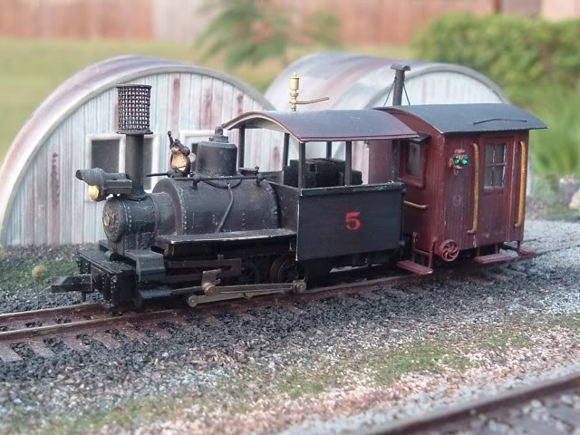

 Posted - January 02 2010 :  9:41:40 PM Link directly to this reply  Show Profile  Add shaygetz to Buddylist
The caboose is about 90% scratch, the loco is about 45%...the obvious things being mechanisms and brass details purchased from the LHS.
 Posted - January 02 2010 :  10:33:31 PM Link directly to this reply  Show Profile  Add romcat to Buddylist
Thats the kind of work I want to get to. Particularly like the Spark Arrestor...
-G.
"A is A"
-Aristotle
Law of Identification
 Posted - January 02 2010 :  11:12:37 PM Link directly to this reply  Show Profile  Add shaygetz to Buddylist
-G.
Originally posted by romcat-January 02 2010: 10:33:31 PM
That was pretty easy once I figured it out. I punched out 2 quarter inch discs with a standard paper punch from styrene sheet. Then I took the screen from a faucet aerator, squared it up and rolled it into a cylinder, making sure the ends just touch. Then I coated the discs with super gel, set the screen on it, then carefully pushed down until it set. Glued it on top of an 1/8" ID stack and that was it.

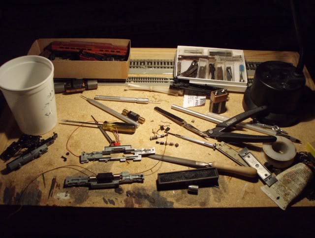

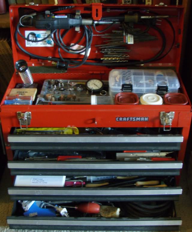

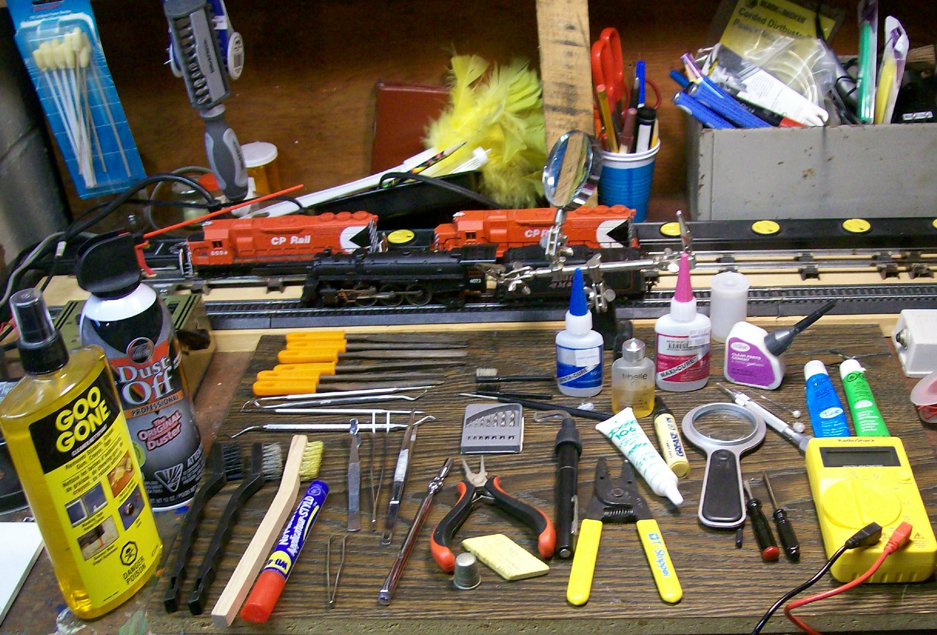

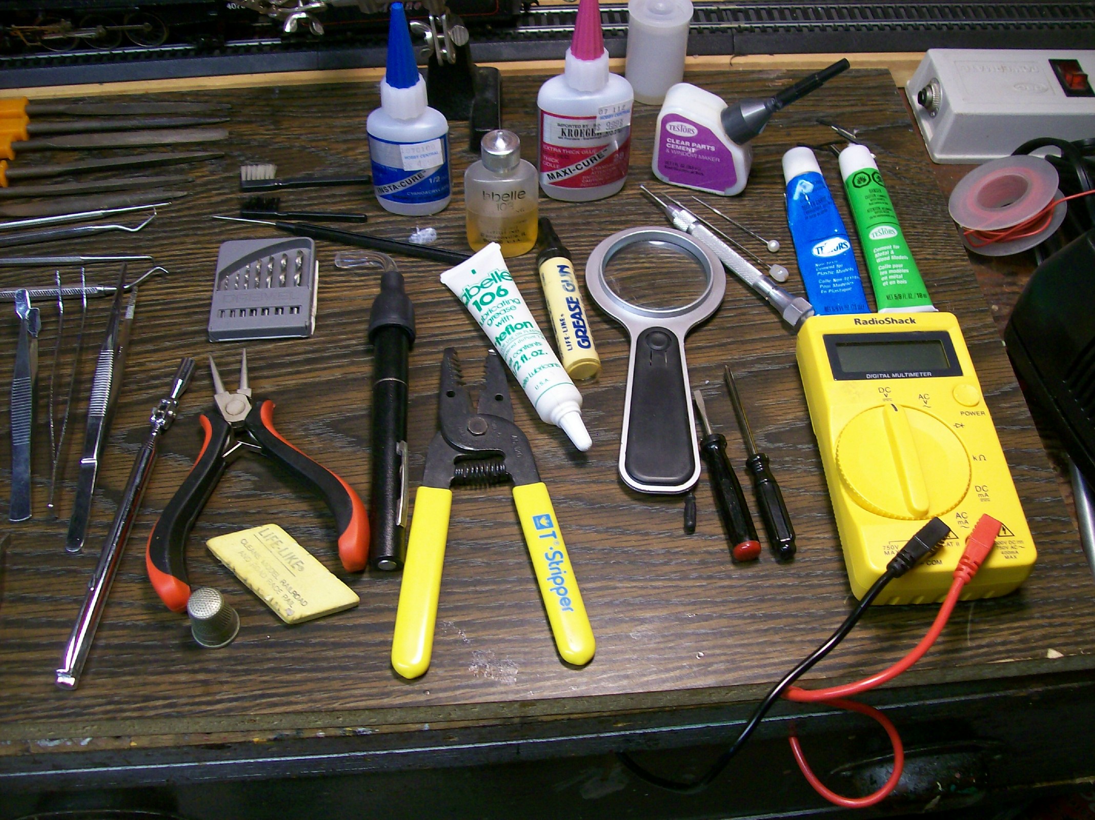

 Posted - January 03 2010 :  12:28:17 AM Link directly to this reply  Show Profile  Add Mike to Buddylist
I thought I would gather together some of my tools. Romcat you have started an excellent thread so that we can learn from others...

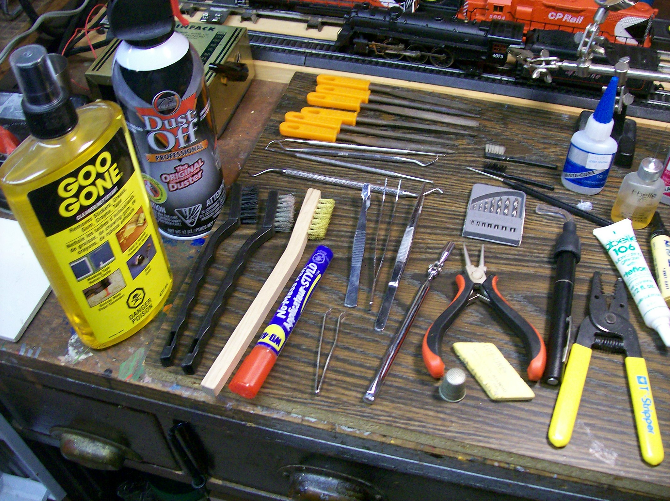

Hey Mike:
The yellow handled pliers are they circlip ones? remind me of my motorcycle mechanic days!
Glad you included the pictures!
