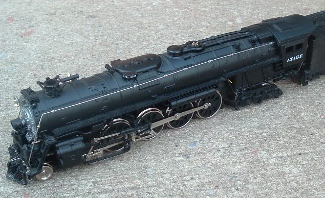

I have an old bachmann CB&Q 4-8-4 with split frame and pancake motor that can hardly motivate itself around anymore, and 40% of the time needs a push start by hand at full throttle. I was saving my money for buying the Bowser repower kit, only to find that they discontinued it.
I've cleaned the motor twice, cleaned its housing in the frame, done everything I could think of, but it still limps around making a LOUD whining noise that almost undulates like sobbing.
I really want to get this engine running again, as it was given to me by a friend in the local club (when it was still extant) who passed away a year or so later. He was surprised at the time to find that it still ran, but he did an outstanding weathering job on the boiler that I've used as a guide for weathering all my other steam locos. (Plus it's my biggest engine...)
So, a couple questions...
Is the mounting of the frame on the newer 4-8-4s to the boiler similar to that of the older ones like mine? If so, I can just wait for one of the new UP Greyhound Niagara uglies to come up on ebay for a cheap price and swap out running gear.
But, I'd really like to save the carefully blackened siderods on the original running gear, so what are my options with replacing the pancake motor with the CD motors I've been reading about? I'll eagerly await any research anyone is doing in that direction.
Or is there some other option I haven't thought of? (I suppose I could leave the motor out and push it with my P2K CB&Q GP30, whenever I get new axles for IT...every gear split while it was sitting it its box...)

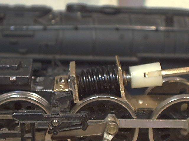

I found a few lost photos of the chassis of my 4-8-4.
This is the early Bowser kit that used part of the Bachmann chassis.
The newer kits are a complete frame.
I built a new gear box and motor mount to replace the open frame motor with worm.
Ray

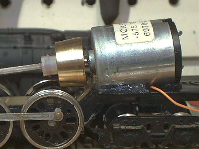

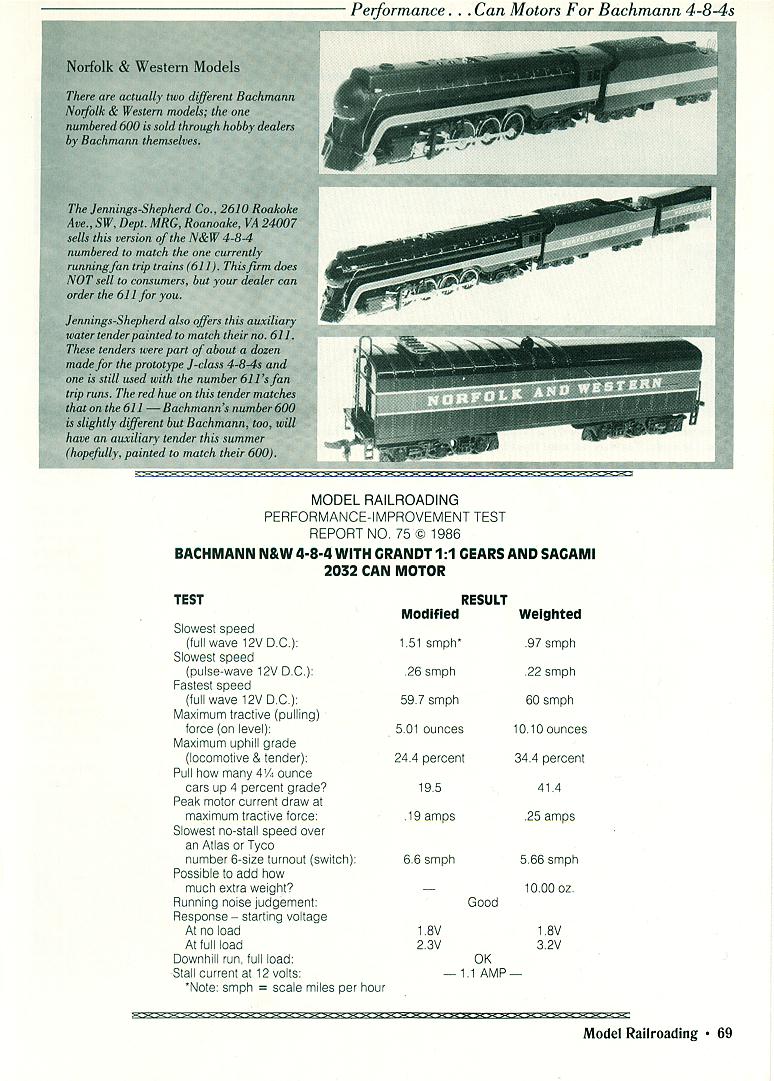

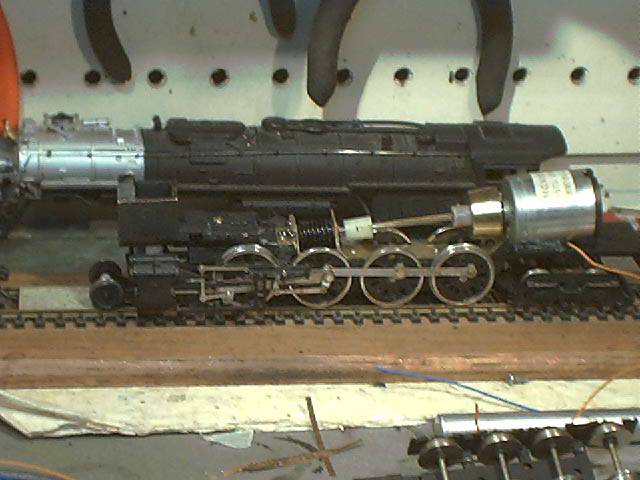

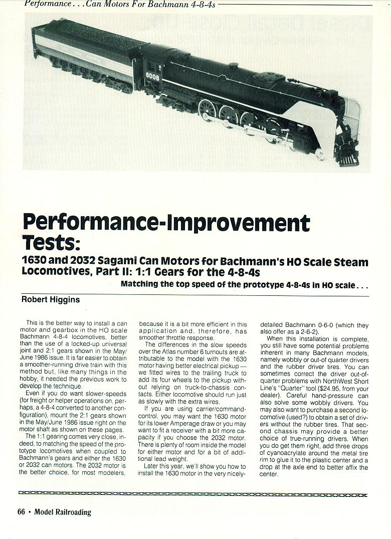

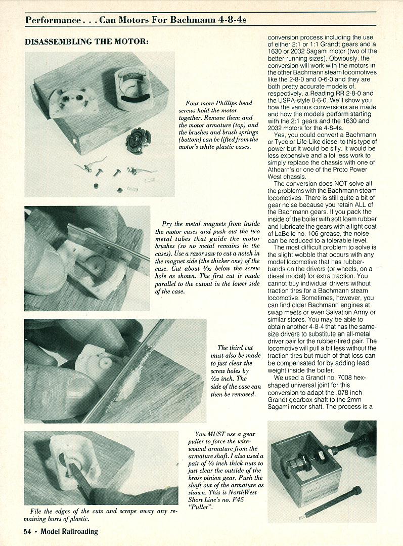

Hi Guys. I have the 1986 Model Railroading Articles on the Bachmann can Moter Upgrade. I have scanned them into a pdf File. Is there a way to Attach a PDF file here... ? If Not I can either post all 10 pages or I can send the file to anyone who PMs me with a Email address. When I saw The Article I remembered the amount of work. But, It was Worth it Carl

 Posted - January 20 2010 :  9:58:25 PM Link directly to this reply  Show Profile  Add VintageHO to Buddylist
Hi Guys. Since I do not know on how to attach a pdf File to a post. I'm going to try and and post all ten pages of the 2 part article. So you can use the Information on how to upgrade your Bachmann Steam engines. If anyone wants a Copy of the complete PDF file, Just PM me with a email address, Like Ray did and I will send it to you. I did this Upgrade back then and I was very happy with the results. Carl

A few years back I traded a Athearn GE engine for a Bachmann Santa Fe 4-8-4. I had a existing spectrum model of this engine and was satisfied with the looks and performance.
to my horror when I got it home I found that it was a pan cake chassis. The tender shell and the engine body were in very good shape, but it ran like a ruptured duck. I wrote the engine off, and placed it in the someday I may deal with it shelf.
A few months latter I was out of town, and my wife had towed me into a Hobby Lobby. Well in the model train section was an Overland train set with a Union Pacific 4-8-4. The body was a NYC Niagra with a vanderbilt tender. Well the set had been marked to half 4 times. So I stood and imagined a Texas And Rio Grande 4-8-4 passenger engine, then I paid the clerk and took my impulse home.
Then I had an idea!
To get to the point I combined the can motor chassis from the train set engine with the body, tender, cylinders/valvegear, and trailing truck from the old pan cake engine. I replaced the plastic wheels on the old tender with new metal 40" wheels. This provided a new smooth running engine. Bachmann used the same running gear from the spectrum 4-8-4's in the train set engine. The old Santa Fe body and accessories matched the new chassis right down to the mounting holes.
I ended up with a complete smooth running Santa Fe type 4-8-4 locomotive and an extra Vanderbilt tender.
 Posted - January 12 2012 :  2:15:29 PM Link directly to this reply  Show Profile  Add NickelPlate759 to Buddylist
That was a good find, JRG. All the Bachmann Northerns have the same chassis, so swapping them out is easy.
