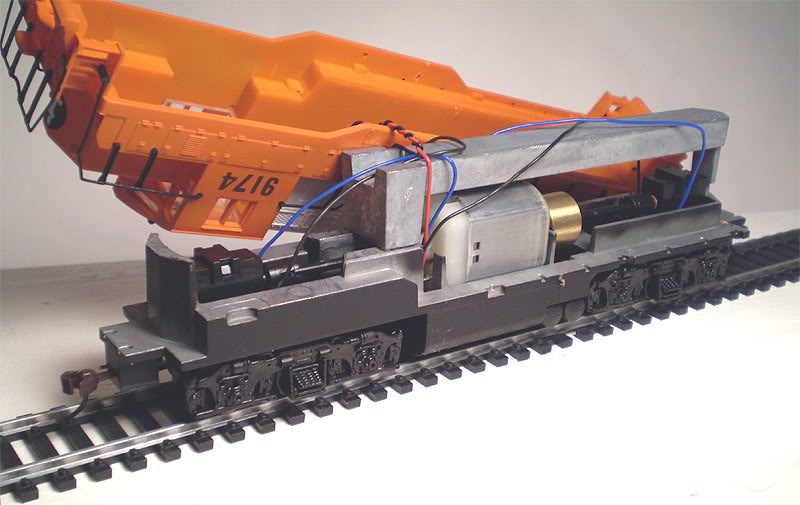

This is the underframe on the recent run of Walthers Trainline GP9M's...
I'd rate this loco operationally similar to the standard line current example Bachmann GP40s.

Is that really the "new" motor? It looks just like the motor in all 3 of my older GP9's. It's a Mubachi 3 pole straight wound motor. Nothing in your pics looks different from my locos. All 3 of mine are 3 or more years old. I got them long before Walthers mentioned the new motor. So what is really new???

Maybe Walthers meant NEW as in they weren't provided USED motors in these models?!?
Maybe that is why mine ran so well. Someone else already broke-in the motor for me!
I looked on the Walthers site, and the discription for the IC #9174 says in addition to the new motor is dual flywheels. Does yours have twin flywheels? I do not see a second one in your photo. If yours does not, maybe you have a new shell on an old production frame. Maybe the new frames were not available on time and yours was made with an older chassie that was in stock?
