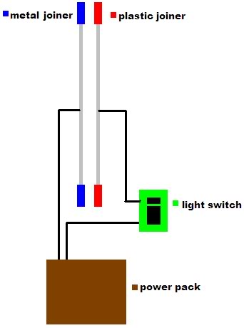

When I did the trackwork on my layout way back when, I put a block in between the main loop and the long siding. I've never bothered installing a switch so I can turn power to the siding on an off. My question is, can I use a household lightswitch for this?

Sure can! That's how I did mine.
Here's a diagram:
If you use regular SPST switches like I did, it doesn't really matter where you connect the wires to the switch. (SPST switches only have two screws on the back )
I like household switches because they are MUCH cheaper than switches from The Source, which is the only place for me that sells electronic parts. Plus if you buy matching covers for them, they look very nice when built into the benchwork of a layout.

Thanks Matt. I thought someone here had mentioned doing it before. It wasn't working for me though so I thought I'd ask...turns out one of the wires was connected to the contact for the "ground wire"(third screw)...oops

Oh. Haha, yeah that might result in nothing happening.
