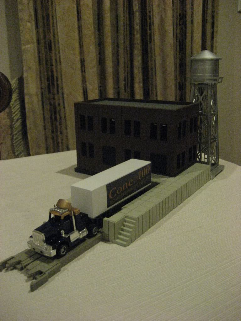

Wow- tested Dupli-Color paint and it worked GREAT! I also used 3M blue masking tape with much success.

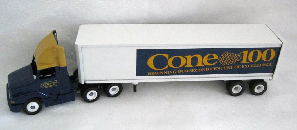

I've tried several paints to get the two-tone effect of a certain textile company's trucks. 90% of the truck was blue while the uppermost half was gold.
Krylon, Tetsors, and others did NOT work out well. Those paints tend to be far runnier and the solvents tended to work their way under masking tape- YUCK!. However, Dupli-Color seems to be far easier to work with in light coats. It won't work its way under the tape like most of the hardware store or hobby grade paints. Dupli-Color dries VERY quickly!
So, on the truck below the blue is Krylon and the gold is Dupli-Color "Sunburst Gold Metallic". I have no clue what car that paint was used on- but it sure looks good on my truck! FWIW- the truck also has a custom airfoil, also painted in gold.
Prototype-
