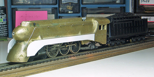

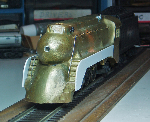

 Posted - July 31 2009 :  5:28:05 PM Link directly to this topic  Show Profile  Add toptrain to Buddylist
The body is a bronz streamlined economy hudson loco body. I first tried a old brass mountain frame. I tried it as a mountain and ti didn't work out. I removed a driver and tried it as a pacific or hudson. The brass frame just didn't work out. I went to the Mantua Pacific frame and drive and had some sucess here. I have a frame in the body and I tried different tenders with it. The two that seam the best was the Riverrossi NYC Henrey Driffus streamlined tender and a old A.C. Gilbert diecast hudson tender. I am going with the gilbert. On the mantus drive I replaced the mantua lead and trailing trucks with brass ones. This is where I am now.

 Posted - July 31 2009 :  7:13:29 PM Link directly to this reply  Show Profile  Add Erich to Buddylist
The streamlined Hudson was the cheapest one from Varneys Big engines. but now iI think it is one of the rarest. Nice work toptrain! - Erich
 Posted - August 06 2009 :  5:52:56 PM Link directly to this reply  Show Profile  Add toptrain to Buddylist
And the work goes on !!! Answers first. Yes it is heavy, and I'll try not to drop it on my foot. I will be making a skirt for each side. I think they will be identical. Varney's add photo shows it painted for the New York Centrals, " Empire State Express ", Streamline Hudson. This NYC streamliner was the last they made. It had the corrugated lower sides who's corrugated style also continued onto the lower tender sides. i It then continued on, matching the lower corrugation on all the passenger cars. NYC also had the Henry Dreyfuss- styled Streamlined Hudson, 'The Century', that had the same boiler lines but a Mohawk fin applied to the curved smoke box front. It was smoth sided and and no corrugation applied to it. These were used to pull the 20th Century Limited. There is a third NYC streamlined Hudson, the" Mercury ". The Commodore Vanderbilt" was the forth. The skirting Varney uses almost matches the New York Centrals Commodore Vanderbilt. The rest of the streamlining does not.
The body also is a very good match for the Santa Fe Blue Goose, another Hudson. It is much more alike to this Hudson then any of the New York Centrals streamlined Hudson's. The side skirt Varney show, is of the type used on the Blue goose. The New York Centrals Century and Empire is different. All three have the same bulging, round, bullet shape boiler front, with the same streamlined front pilot. The fire box is also of the Blue Goose style. NYC used their Hudson which had its own very unique styled firebox. The forward line of the firebox was not as long forward from the cab as Varney's and had a arcing curved line starting at the top curving forward.
Now I am not a modler of either line, either the NYC, or the ATSF. My lines are the CNJ which had no streamliners, on the Pennsylvania Rail road which streamlined its K4 Pacific's. (It isn't hard to change a drive from a Hudson to a Pacific.) Will this happen? I don't Know. The model will be a streamlined something. I will continue the work started. I'll try to match what Varney had done. And then make it a Pennsy loco.

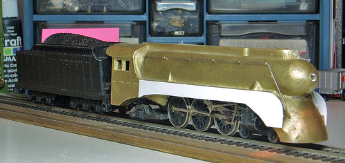

 Posted - August 12 2009 :  5:13:46 PM Link directly to this reply  Show Profile  Add toptrain to Buddylist
Here is the streamliner with it's walkway handrails.
Attachment: P8110001.JPG ( 65333bytes )
I also have installed a cab floor and blank boiler headplate. I have drilled out the headlight, filled in some ruff spots, and got a template for the side skirts started.

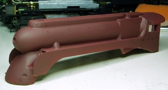

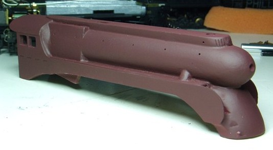

 Posted - September 07 2009 :  7:13:20 PM Link directly to this reply  Show Profile  Add toptrain to Buddylist
Here is the primed and painted first coat color.

 Posted - September 08 2009 :  03:07:37 AM Link directly to this reply  Show Profile  Add Erich to Buddylist
Hey you got a new tender Frank, looks fine. You also made changes to the firebox
(to get a PRR look I think).
Like to she the finished paint! - Erich

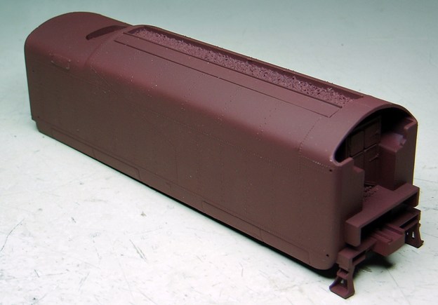

 Posted - September 10 2009 :  12:31:47 PM Link directly to this reply  Show Profile  Add toptrain to Buddylist
Yes but painting isn't done, and that tender may not stay. it is narower. Not as big. The boiler is more OO than HO. I need to see what the finished loco looks like.

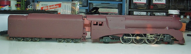

 Posted - September 11 2009 :  11:03:20 AM Link directly to this reply  Show Profile  Add toptrain to Buddylist
No. I had two spare tender bodies for the Dreyfuss. here is what it looks like now with it wheels on.
* frank

 Posted - September 11 2009 :  11:17:59 AM Link directly to this reply  Show Profile  Add Ray Marinaccio to Buddylist
Looks good Frank.
If the tender is to narrow, and you have 2 shells why couldn't you cut them both in half, longways, Cutting one of them off center to the right and one off center to the left then splice the wider halves together.
I need a tender for a Gilbert Hudson and may try that method.

 Posted - September 11 2009 :  4:37:58 PM Link directly to this reply  Show Profile  Click to see MM 1498's MSN Messenger address  Add MM 1498 to Buddylist
I wasn't quite sure what to make of it without the wheels, but now that they are on it's got that beautiful streamlined look to it.
I think Erich may have asked already, but is the paint done or will it be a different colour?

 Posted - September 11 2009 :  5:31:13 PM Link directly to this reply  Show Profile  Add Erich to Buddylist
I dont think the boiler looks like OO. Dont worry! Nice work! And tender matches very good. - Erich

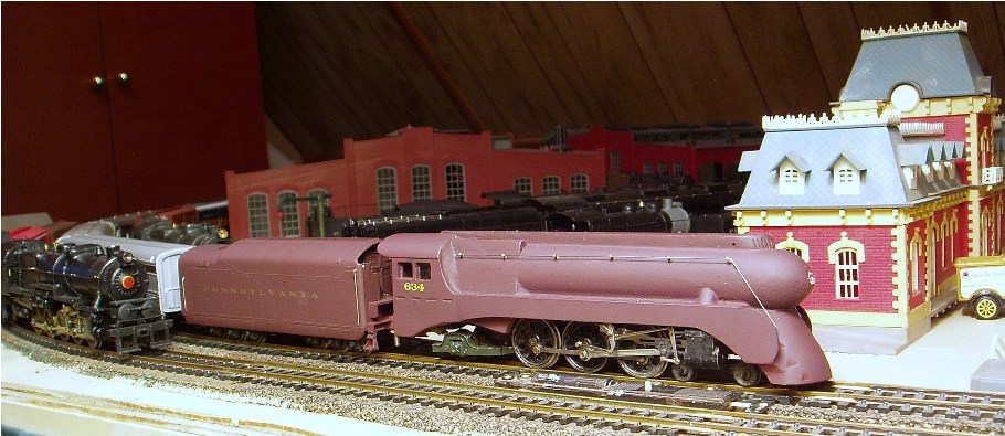

 Posted - February 10 2010 :  2:04:07 PM Link directly to this reply  Show Profile  Add toptrain to Buddylist
Well it seams that I am done with this kitbashing. I haven't changed the paint, Just repaired the valve gear on the firemans side. This is the completed K4sa.

 Posted - February 11 2010 :  02:25:23 AM Link directly to this reply  Show Profile  Add Erich to Buddylist
Originally posted by toptrain-February 10 2010: 2:04:07 PM
Markerlights would be nice, (there are two holes for it on boiler top),
maybe a keystone would be nice on pilot ?
take this only as a suggestion! - Erich
 Posted - February 11 2010 :  3:37:37 PM Link directly to this reply  Show Profile  Add toptrain to Buddylist

As to the marker lights. Standard old fashion ones look bad. I haven't found any teardrop types except for the bachmann (GS4) They seam too small.
Edited by - toptrain on February 11 2010 3:38:49 PM

 Posted - September 08 2010 :  09:42:28 AM Link directly to this reply  Show Profile  Add toptrain to Buddylist
Hey Frank:
Did you ever try a Bowser K4 Chassis underneath? Just curious. I know you're very familiar with Bowser stuff.
The Mantua works fine. It fell over is dameged and is in need of repair right now. The bronze boiler is very top heavy. Also the Tuscan paint is to light in color. Needs a repaint to a darker Tuscan.

 Posted - September 08 2010 :  09:54:03 AM Link directly to this reply  Show Profile  Add romcat to Buddylist
Hey Frank:
By top heavy do you mean the shell itself, or that it has to sit high on the chassis and that makes it top heavy?
Thanks,
Gareth
"A is A"
-Aristotle
Law of Identification
 Posted - September 08 2010 :  11:34:48 AM Link directly to this reply  Show Profile  Add toptrain to Buddylist
Hey Frank:
Thanks,
Gareth
Originally posted by romcat - September 08 2010 :  09:54:03 AM
More weight above the frame than even with frame..
 Posted - September 08 2010 :  11:39:37 AM Link directly to this reply  Show Profile  Add romcat to Buddylist
Frank, is there any room to add weight to the frame?
"A is A"
-Aristotle
 Posted - September 08 2010 :  12:16:21 PM Link directly to this reply  Show Profile  Add toptrain to Buddylist
Originally posted by romcat - September 08 2010 :  11:39:37 AM
when it runs it does it well. Just cant run ful speed.
 Posted - September 08 2010 :  12:43:26 PM Link directly to this reply  Show Profile  Send catfordken a Yahoo! Message  Add catfordken to Buddylist
just a thought,whats about replacing the front and rear trucks for heavier ones,mantuas are quite springy ken
Edited by - catfordken on September 08 2010 1:43:11 PM
 Posted - September 08 2010 :  2:07:55 PM Link directly to this reply  Show Profile  Add romcat to Buddylist
Hey Ken/Frank:
I posted a query on the Vintage list (Frank you're a member I think?) to see if anyone running a different chassis like the Varney Hudson one are seeing similar issues.

 Posted - September 08 2010 :  8:00:40 PM Link directly to this reply  Show Profile  Add NickelPlate759 to Buddylist
Frank, I hope it didn't hit the floor when it went over. If it's top-heavy on a Mantua frame, imagine how it would be on a plastic framed loco.
Erich
train
 Posted - September 09 2010 :  03:30:46 AM Link directly to this reply  Show Profile  Add Erich to Buddylist
Get a Varney chassis! - Erich
