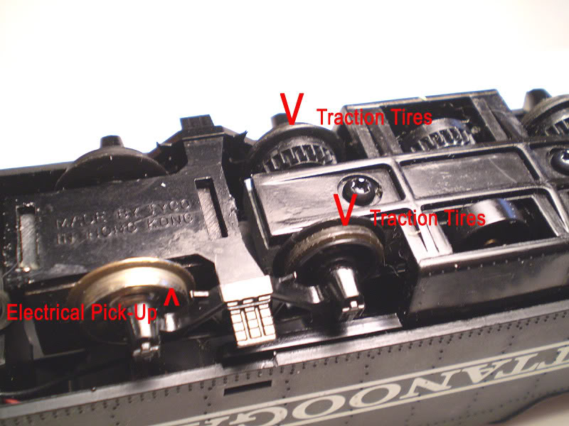

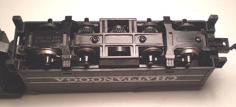

I had the same problem with my Chatanooga steamer, it would bump and grind like a wheel had slipped the track. I thought to myself MAN THIS THING CAN'T PULL ITSELF MUCH LESS A TRAIN. It took me the longest time to figure it out. The wheels that you say grip the track should actually have tiny rubber rings on them to help the train get traction. If you turn it upside down and look at the wheels you will see grooves that the rubber rings fit in. Some of the other guys can tell you where to get those rings.

With respect to the Clementine Steamers troubles...let's look at the loco's tender first.
TYCO powered this version of steam engines with tender-drive. You basically have a PowerTorque truck power unit tucked inside the middle of the tender, as seen in the above image.
The brass wheels on the outside ends of the tender pick up electrical current from the track. They need to be clean. If they are tarnished and/or dull try a pencil eraser on them or rubbind alcohol or track cleaner or even Goo Gone to get them nice and shiny.
The inside wheels made of black plastic need to have traction tires. I'm guessing this is the bumpy ride you're getting...you might have old dried and broken up traction tires. They are made of a rubber-like material and sadly time is not kind to them. I've had brand new in box TYCO locos hit the rails and the traction tires split-crack-and drop right off the wheels. They just don't survive the years well.
Believe the tender drive should have four traction tires. Two on each side and all on those middle axles. Old dried up and dead tires can be removed with a small screwdriver or tweesers. Be careful not to nick up the plastic wheels.
Stewart Products make a Traction Tire replacement kit. It sells for like $5 and provides you with a nice supply of replacement tires that will fix that problem.

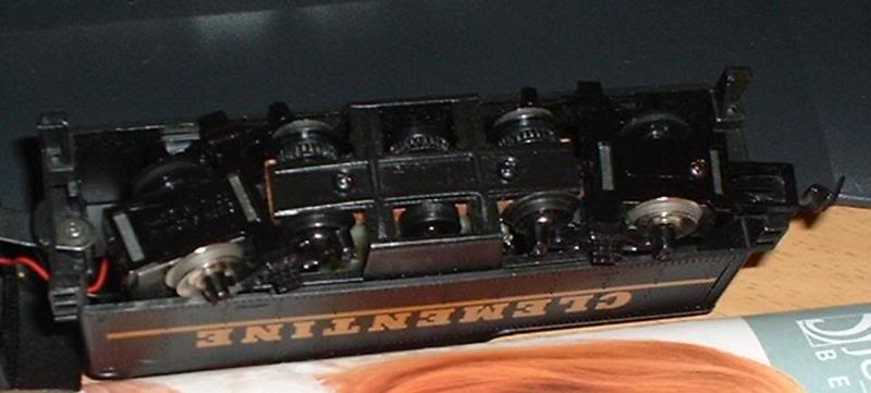

MYdadsTYCO
 Posted - December 02 2006 :  11:55:21 AM Link directly to this reply  Show Profile  Add MYdadsTYCO to Buddylist
so here's mine - you are saying that the BLACK tires need wheels? (or vice versa!)

 Posted - December 02 2006 :  5:26:48 PM Link directly to this reply  Show Profile  Add Tony Cook to Buddylist
It's the four inside black wheels that'll need new rubber traction tires put into the grooved area that touches the rail head.
Looks like from your picture that those brass colored wheels could use a bit of polishing with a pencil eraser to clean them up. The cleaner they are the better they pick up electric current and thus the better and more smoothly it'll run.
