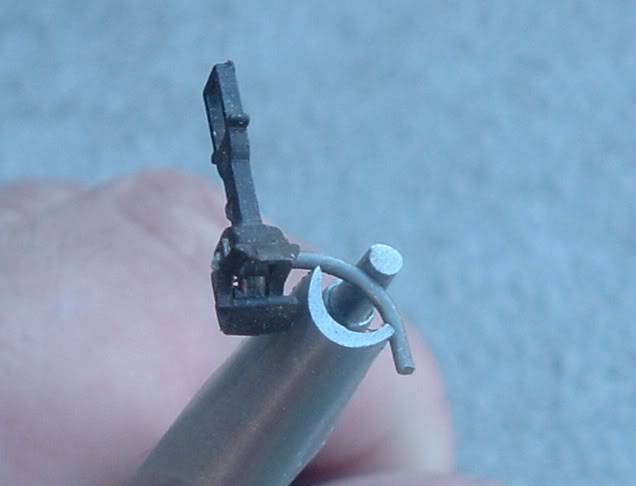

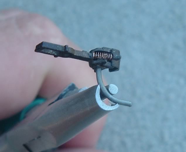

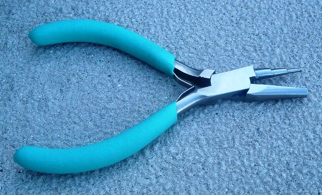

You can also go to a local craft store and ask for a 3 step coil plier for about half the price...they work the same way and cost less than a bunch of over clipped or damaged Kadees...
The Kadees in the picture were over bent nearly straight by a well meaning modeler that I got in a box lot. The pliers paid for themselves with the first two pairs.

 Posted - June 05 2009 :  4:02:14 PM Link directly to this reply  Show Profile  Add NickelPlate759 to Buddylist
Thanks for the head's-up on the pliers, Shaygetz. I would never have known to look there. I guess now we know where Kadee gets theirs.
 Posted - June 05 2009 :  8:49:32 PM Link directly to this reply  Show Profile  Add Brianstyco to Buddylist
Hobby Lobby and Michaels craft stores carry the above pliers mentioned above by ShayGetz. If you do not have either of these 2 stores in your area-a local craft store should have them
