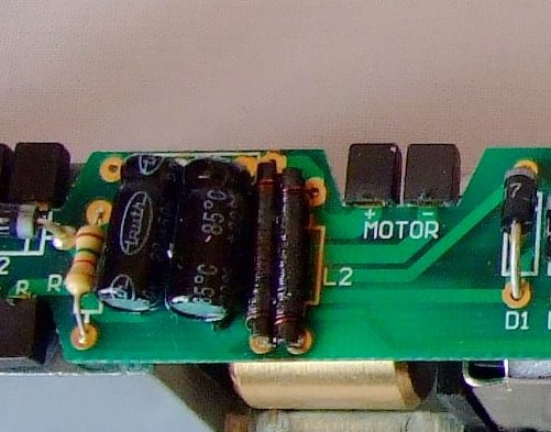

i got one of these a year ago,ran for 5 mins then stopped,stunk like nothing i have smelt before,stripped it lubed it,cleaned wheels,nothing,put to one side till today,for some reason i moved the 2 coils (l2)very carefully separated put back on track runs sweet,so if yours smells and stops give it this simple check,if you can check before running ken

Okay, I'm trying to get used to different circuitry components. I see a resistor, a couple of capacitors, but what is that's fried?

Ken, those are RF chokes, and they look fried. They may be working now, but I'm sure at least one of them is open. Not sure what turned 'em into crispy critters, but they look like they got track voltage across them. The wire windings should be copper or red.
 Posted - March 07 2009 :  05:58:12 AM Link directly to this reply  Show Profile  Send catfordken a Yahoo! Message  Add catfordken to Buddylist
MY REASON FOR POSTING THE WARNING,WAS FOR THE REASON NickelPlate759,POINTED TO FRIED RF CHOKES,THIS WAS A BRAND NEW MODEL,DID THE USUAL QUICK CHECKS PUT ON TRACK,RAN AT VERY LOW POWER,GOT THE SMELL,SWITCHED OFF,AND FORGOT IT,WITH INTENTION OF RETURNING TO BACHMANN,THEN YESTERDAY OPENED UP SAW WHAT I SAW,PULLED THEM APART AS THEY WERE STUCK TOGETHER,PLACED ON TRACK,AND IT RAN,BUT IS BEING RETURNED TO BACHMANN,BUT MY POINT IS IT COULD BE A ONE OFF IN MY CASE BUT TO SAVE THE GRIEF AND TIME WORTH CHECKING IN THE FIRST PLACE THAT THERE IS A GAP,KEN
