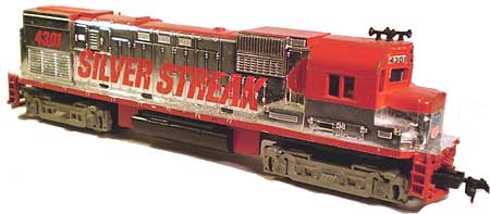

Ken, it is a 1978 Tyco Silver Streak. Really other than that I would not know what to tell you. I can probably take some pics and post them if that will help.

 Posted - February 26 2009 :  10:56:23 AM Link directly to this reply  Show Profile  Send catfordken a Yahoo! Message  Add catfordken to Buddylist
ok we know the loco did you lube it ken

 Posted - February 26 2009 :  11:03:16 AM Link directly to this reply  Show Profile  Send catfordken a Yahoo! Message  Add catfordken to Buddylist
the loco below is this it ken

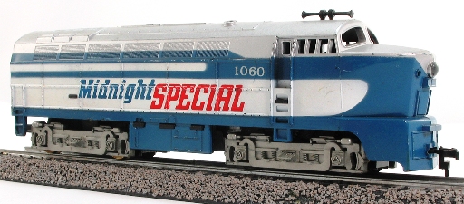

I was wrong, the loco is a midnight special. The gears are almost impossible to move by hand. Where can I get that type of oil and grease? Thanks for all this help and advice.

 Posted - February 26 2009 :  11:21:41 AM Link directly to this reply  Show Profile  Send catfordken a Yahoo! Message  Add catfordken to Buddylist
this one known as a shark ken
 Posted - February 26 2009 :  11:26:47 AM Link directly to this reply  Show Profile  Send catfordken a Yahoo! Message  Add catfordken to Buddylist
any hobby shop should sell it or one similar ken
