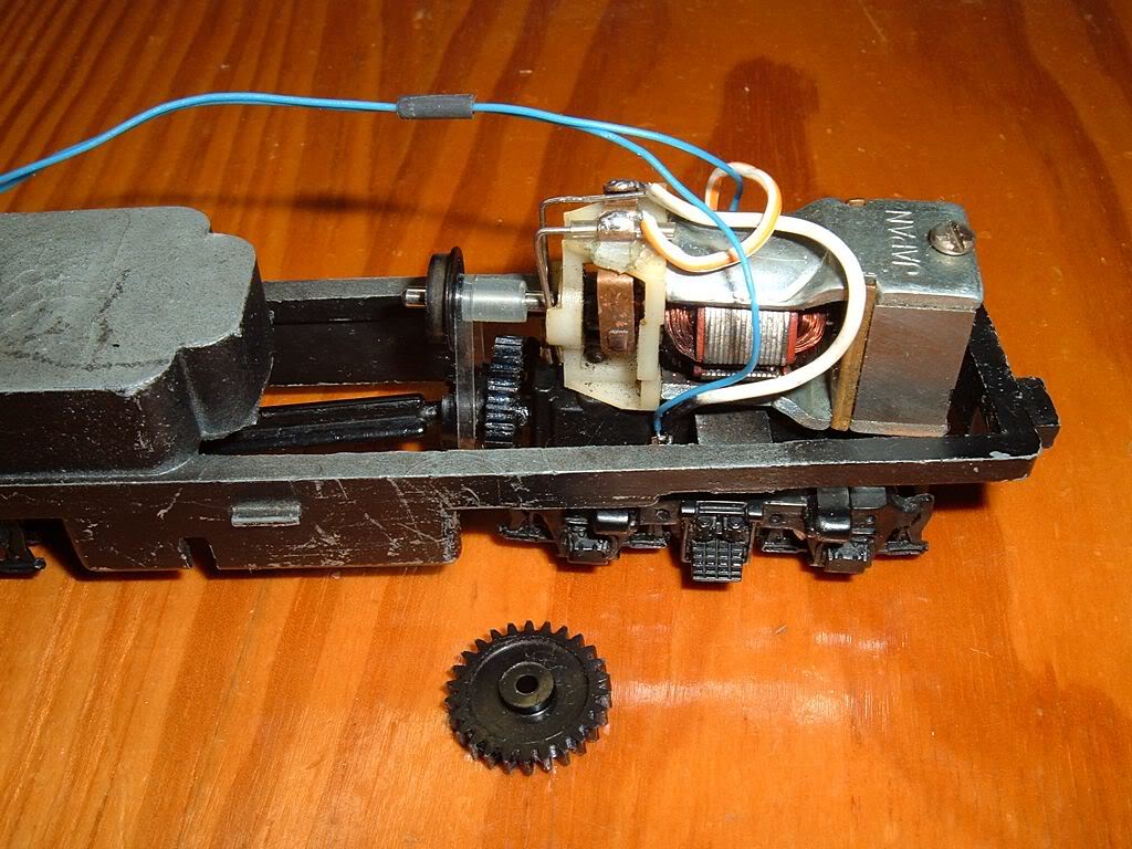

 Posted - February 20 2009 :  5:57:17 PM Link directly to this reply  Show Profile  Add NickelPlate759 to Buddylist
I haven't gotten those to run well either.
Originally posted by Ray Marinaccio-February 20 2009: 02:59:04 AM
Give this a try.
It drops the speed, and eliminates most of the gear noise.

 Posted - February 20 2009 :  10:48:00 PM Link directly to this reply  Show Profile  Add Hypoponera to Buddylist
Very cool idea Nelson! I may just have to try that on my SW. I am replacing the original motor and having a bit of trouble matching up those drive gears. Odd to think I am going BACK to the old drive bands!
 Posted - February 21 2009 :  01:03:49 AM Link directly to this reply  Show Profile  Add NickelPlate759 to Buddylist
Yeah, except these drive bands don't turn to goo like the old ones. I guess they're PVC? They're Goody hair bands from Wallyworld, and they're the perfect size for this particular drive. The old freight car wheel is just there to keep the band from walking off the shaft, and there's a short length of silicone tubing to up the speed a little.

 Posted - December 04 2012 :  07:55:01 AM Link directly to this reply  Show Profile  Click to see EM-1's MSN Messenger address  Send EM-1 a Yahoo! Message  Add EM-1 to Buddylist
Nelson,
Thats not a bad idea! I must say, how well does it pull? any slippage on it under load?
I have 4 of the old Varney diesels that have that same drive and I plan to remotor mine as the CD-90's (I think) open frame motors are shot......And they to my aren't worth trying to repair as I have TONS of motors so......Figure, I'd toss in a can motor in each of them! BUT, I like the belt drive, I am curious on how well it pulls!

 Posted - December 05 2012 :  4:37:15 PM Link directly to this reply  Show Profile  Add NickelPlate759 to Buddylist
John,
It's been a while, and I can't remember if I put the silicone tubing on the motor shaft to speed it up or eliminate slippage. I think it was the speed issue. The clear bands really are worth the small investment, since they haven't rotted or hardened on me yet.
You have to reverse the pickup wipers so it runs the right direction, of course. I moved one wiper up to the front truck, since the pickup on one truck was lousy. The band does put tension on that lousy drive shaft, which I deburred and polished as well as I could, and it's well greased with Super Lube. The motor handles it fine, even tho the magnet is pretty weak. It doesn't get more than lukewarm.
