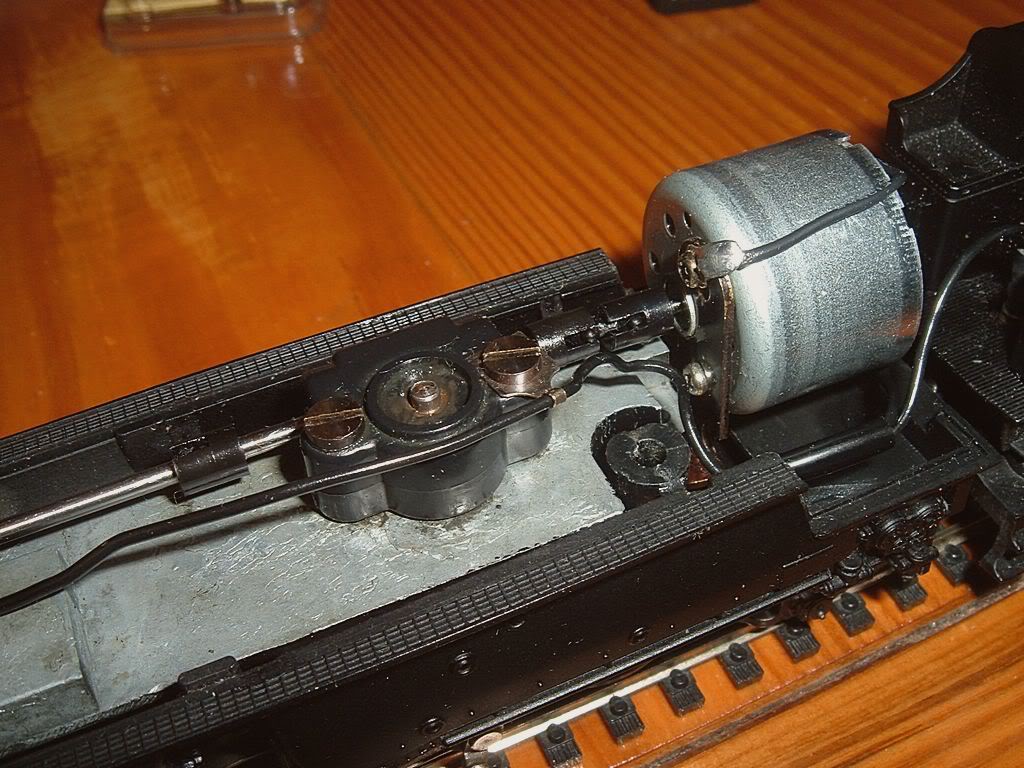

What you're describing is the old Rivarossi ball bearing motor. I actually removed mine in favor of a CD tray motor, which required minimal modification of the motor mount.
Here's a picture of it with a CD spindle motor, which was the first one I tried. I wasn't satisfied with the low-end torque. The CD tray motor is the same diameter, but about half the length. I replaced the old driveshafts with NWSL universals.

 Posted - February 14 2009 :  4:30:25 PM Link directly to this reply  Show Profile  Add NickelPlate759 to Buddylist
Yep, that first shaft arrangement was terrible. The short shaft was supposed to work on an angle, which slotted shafts like those can't do. The previous owner had tried to improve it, but without success. I used silicone tubing myself at first, but the universals are smoother.
All I had to do with the brass mount was elongate the top screw hole so it would line up with one of the holes in the Mabuchi motor. It's a CD tray motor of the same dimensions as the one used by GIC and others for the Frankentorque mod.
