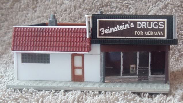

Very rarely does one have the opportunity to model the prototype as close to exact as can be done.

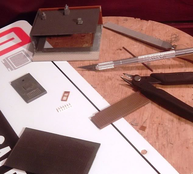

When a fellow modeler at another forum passed away just before Christmas, the idea of doing something to honor his memory was brought up. Knowing that pictures of his store were online, I looked them up and realized the Model Power N scale stores came pretty close to the right size, all that was left was a little guessimating and some creative kitbashing. My beloved provided the tech support for the graphics.
These are the pics of his store...

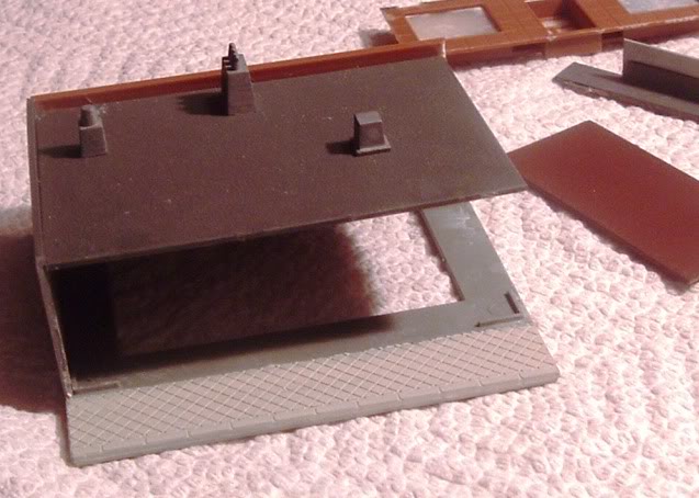

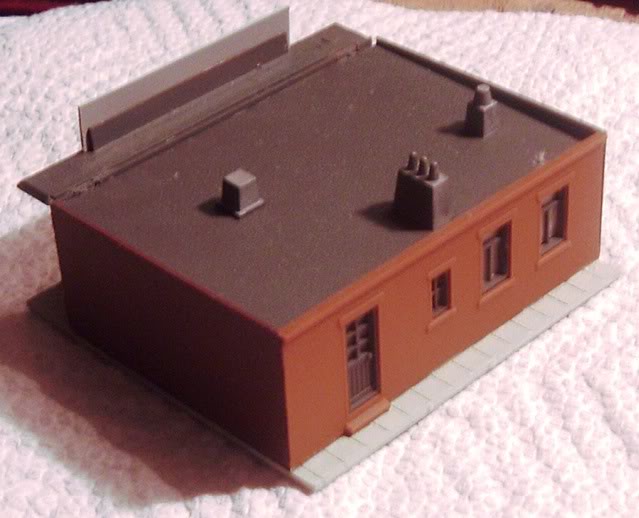

I started with a pre-assembled shell that thankfully wasn't glued together too solidly and removed the front and right side...
Edited by - shaygetz on February 04 2009 10:36:03 PM
 Posted - February 04 2009 :  10:30:55 PM Link directly to this reply  Show Profile  Add shaygetz to Buddylist

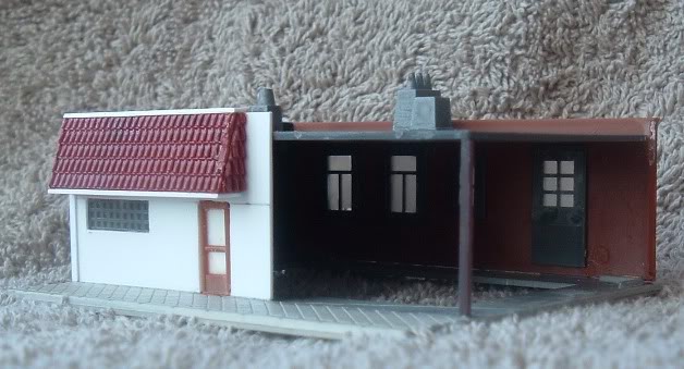

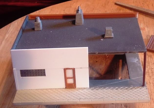

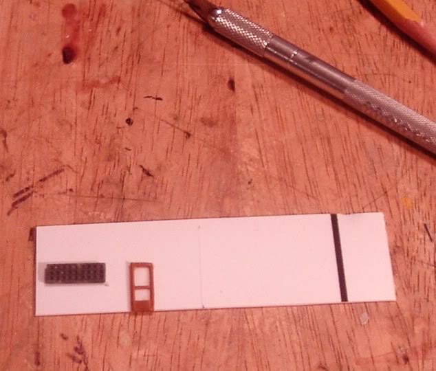

I started at the office end after I guessed that the storefront was about 22 feet wide and on a 10 degree angle. My calculations are based on common sized items, in this case, the doors and glass blocks in the far left window. The block windows are a grate from a water drain and the door came from the scraps removed at the beginning...
 Posted - February 04 2009 :  10:31:25 PM Link directly to this reply  Show Profile  Add shaygetz to Buddylist

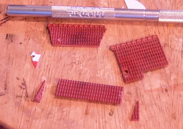

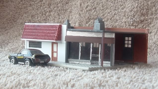

Next came the awning, again based on the size of common items and made from scrap Spanish tile roofing. The column is a scrap of 6x6 from a long lost kit...
 Posted - February 04 2009 :  10:33:04 PM Link directly to this reply  Show Profile  Add shaygetz to Buddylist

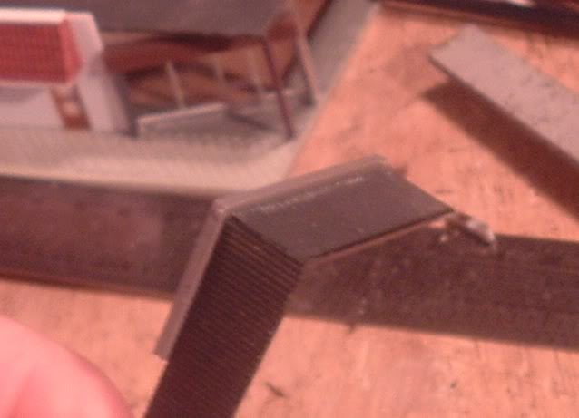

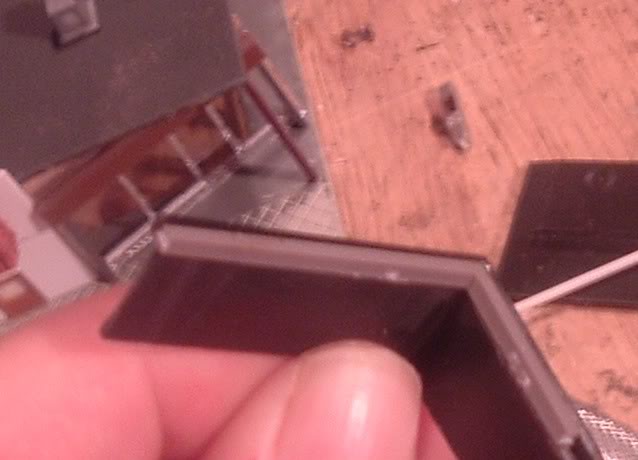

The front store door and windows were made from a CD case with framing scratched in and painted. A lower sill was added from 1/32"x1/16" styrene stock, the security gate track and hood from odd scraps...
The awning and light trough came from scrap corrugated siding and 1/8" square styrene stock, a bit fussy but it works in the end...
Edited by - shaygetz on February 04 2009 10:40:28 PM
 Posted - February 04 2009 :  10:34:16 PM Link directly to this reply  Show Profile  Add shaygetz to Buddylist

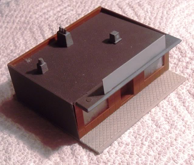

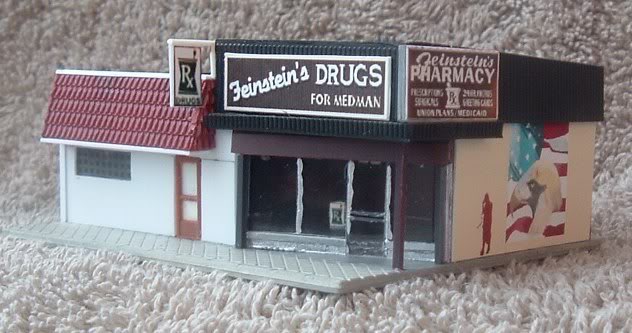

Once mounted, the hardest part was lifting the graphics for the very distinct mural and signage. My beloved did a fantastic job of it and I didn't want to mess them up. These were glued to sheet styrene ( a double thickness for the side one, a thinner stock for the front one. The wall was made as one graphic, then glued to a sheet, cut and trimmed into place to avoid any paper lines...
 Posted - February 04 2009 :  10:34:55 PM Link directly to this reply  Show Profile  Add shaygetz to Buddylist
All that was left is a bit of paint and touchup and my LPBs have a source point for their Medicaid and Union copays...
Hope this wets your appetite for at least one authentic model on your pike. It's kinda spurred on a downtown renovation project on mine...sigh...A copy of the signage is a available on a PDF for the asking and any of the more squirrelly measurements can be had via PM.
