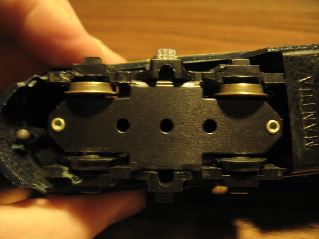

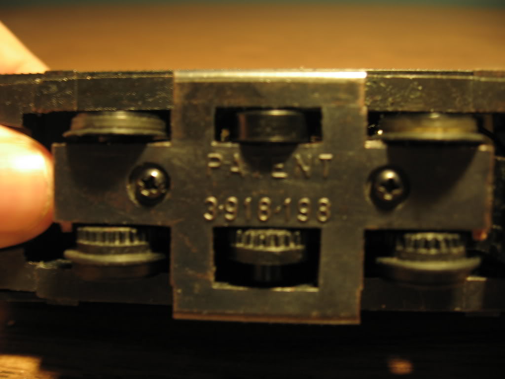

Like Nelson said, it is easiest to tell by the bottom of each motor.
The PowerTorque always has 3 axles,
and the MU-2 has a flat metal plate on the bottom.
However, I still don't really understand how to compare the different tabs and trucks on each motor.
