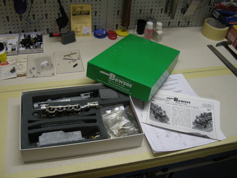

i am so glad that santa clause brought me a Bowser Mike
I am living in Austria/Europe, we ordered it in the USA and they missent it to Autralia, from there it came back to Austria. so it traveled around the whole world!
For my friends in the USA: Australia is in the Pacific, Austria is in Europe over the Atlantic!

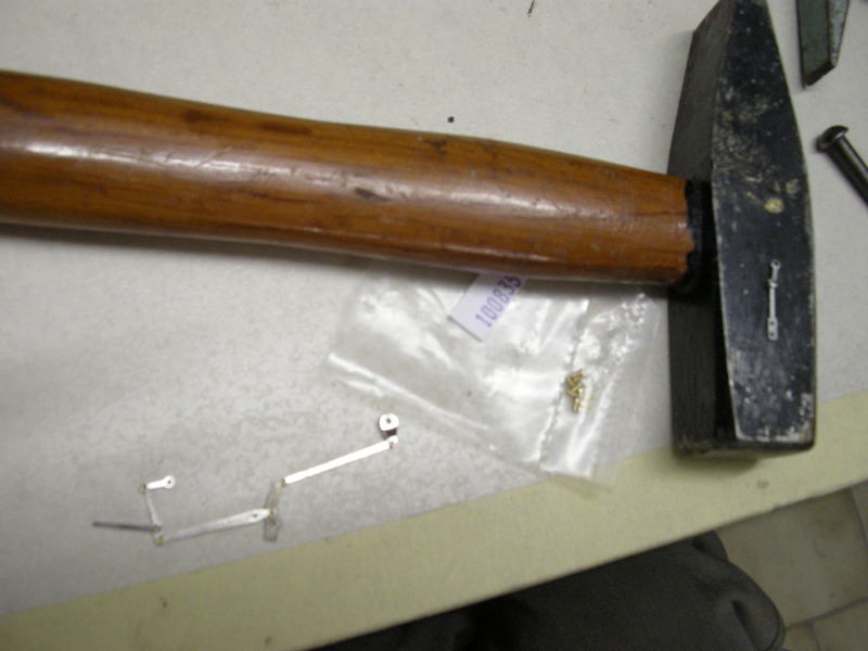

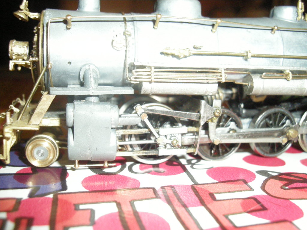

using a bigger hammer instead an anvil makes it easy to assembly the valve gear with the rivets.
ready assambled valve gear
ready for track test - erich

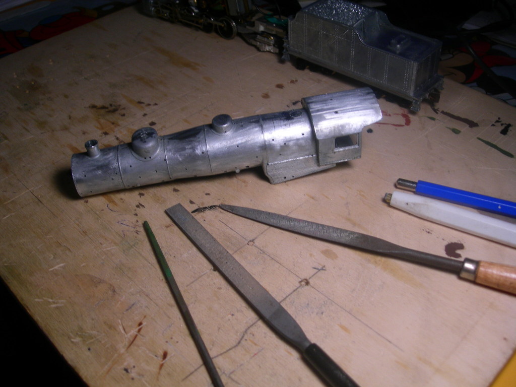

Is there much flash on the castings Erich? It looks very clean. I had a Mantua 2-8-0 kit with really bad flash, to the point it formed webbing between the cylinders and the steam pipes.
Erich
train
 Posted - December 28 2008 :  06:46:43 AM Link directly to this reply  Show Profile  Add Erich to Buddylist
Hi Nelson
there is some flash to file from the casting! there are some parts you can not put together without filing ( like inserting wheels in the frame). very much is on the tender frame. important thing is to take your time and a different set of files.
Attachment: sm_DSCN6013.JPG ( 29013bytes )

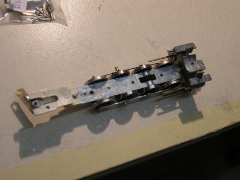

Have some Problems with posting pics
so here it is want to show

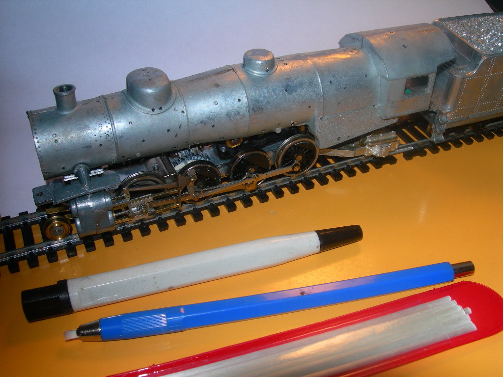

i also use fibreglasspen to clean! erich

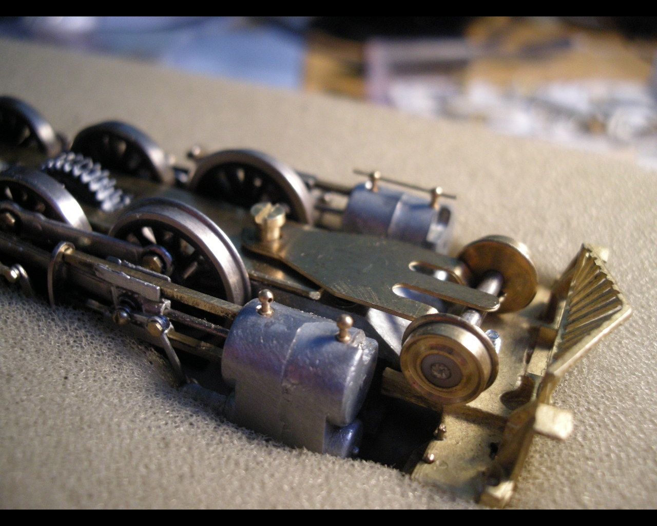

installing cylinder bleed

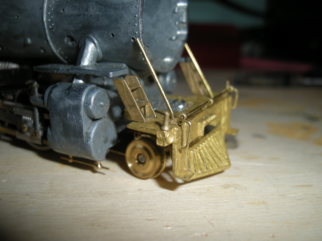

worked a little bit and finshed truck. Had some problems with to small holes in the pilot for the hangers of the coupler arm, also holes in hangers are to small, the coupler arm was to short. drilled all the small holes a little bit bigger and bend a new coupler arm by myself. - Erich

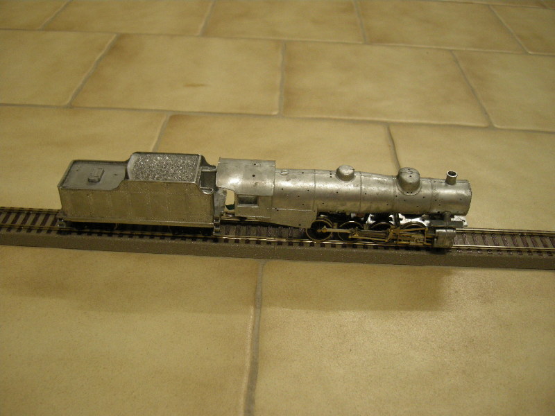

Added new parts to the Mike. also installed DCC. - Erich

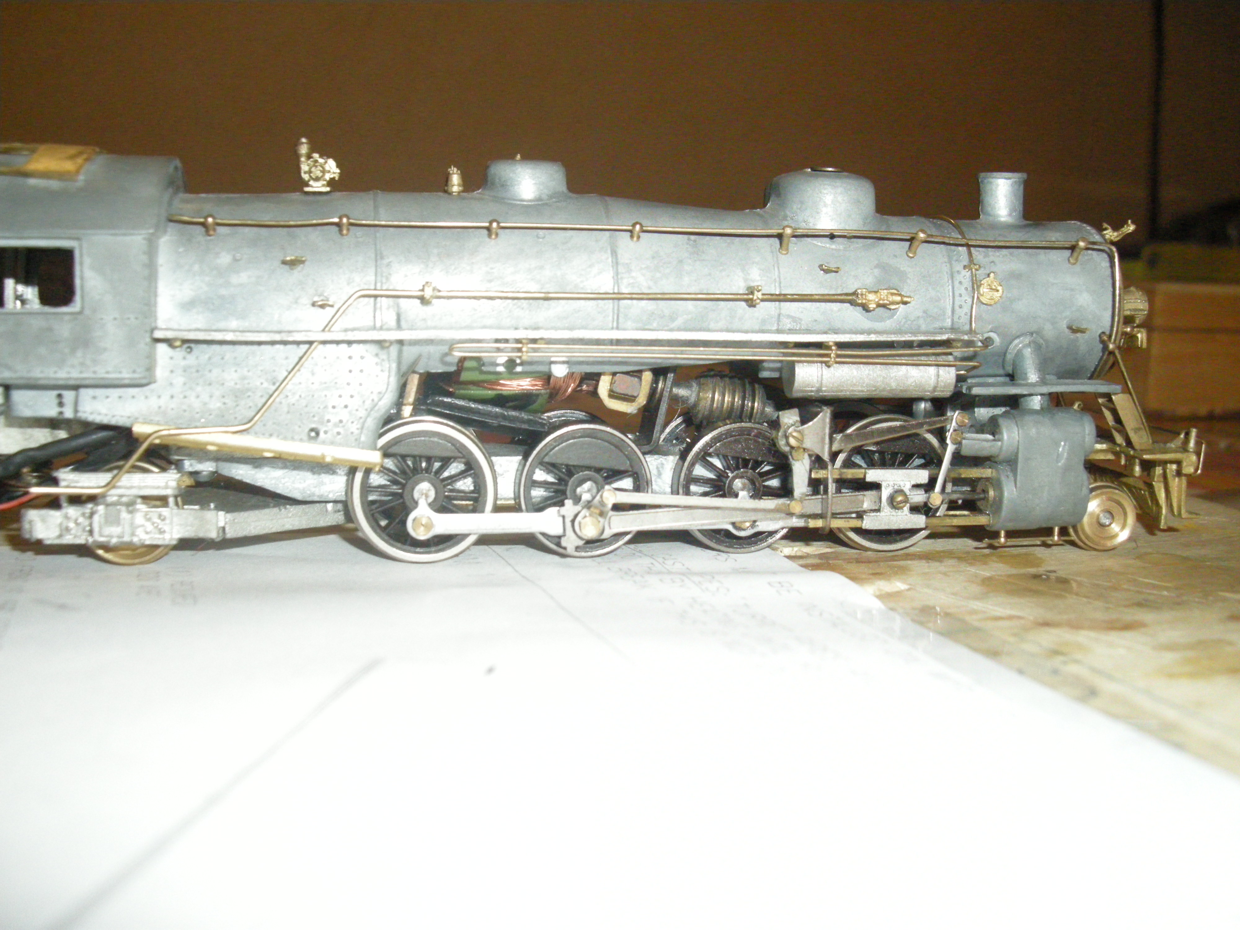

Worked again on the mike, (Handrails,steps,piping) - Erich

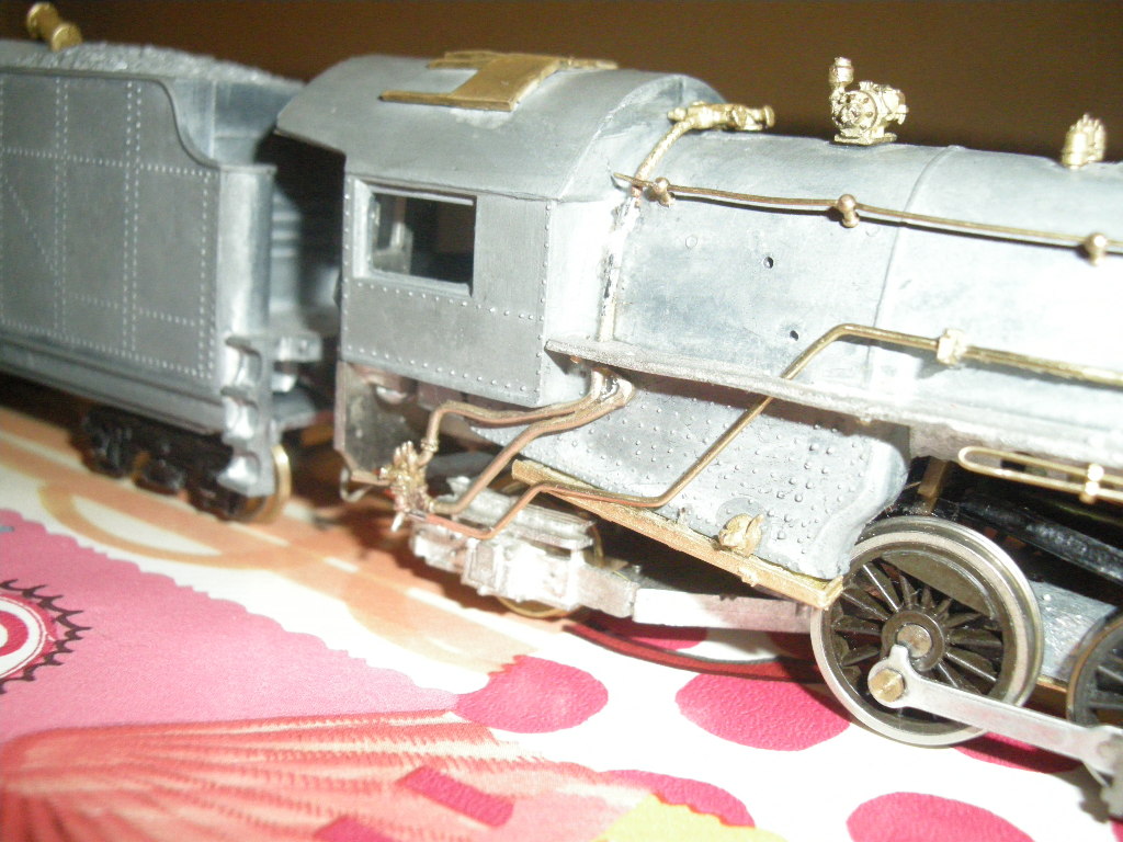

 Posted - January 24 2010 :  2:53:05 PM Link directly to this reply  Show Profile  Add Erich to Buddylist

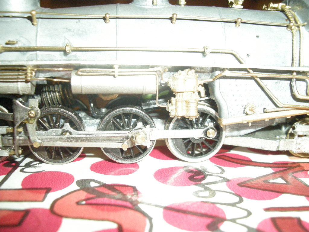

Nearly finished the Mike. Bending , soldering and installing the piping sometimes drove me nuts!
