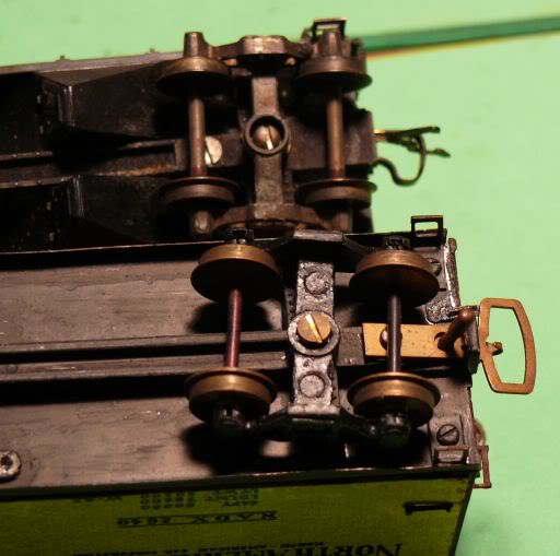

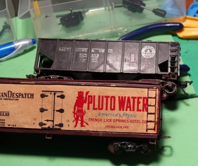

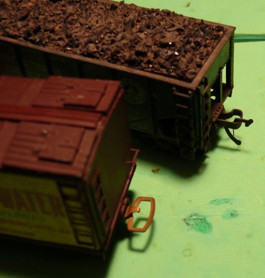

First up is a pair of Mantua?, Varney?? wagons with different couplers [old, metal]

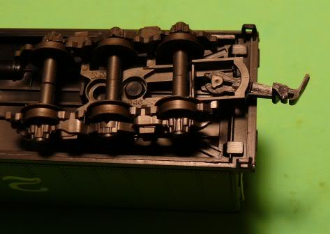

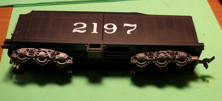

Next is a Rivarossi 6 axle [non power] tender . I have another one with the coupler that is sticking out the RHS in the pictures, broken. What kadee do I need?

#5 using the kadee box screwed or glued to the underframe looks like it would work on those cars--at least that what i would use if mine
 Posted - December 20 2008 :  11:13:10 PM Link directly to this reply  Show Profile  Add shaygetz to Buddylist
Like Ken said, ol' reliable, the Kadee #5 should fix you up there. When you get the couplers, make sure you pickup their standards gauge and a pack each of their .010" and .015" shim washers too.
BTW, the first one is a Baker coupler, used by John Allen on his Gorre and Daphetid. The second is a Mantua hook/loop, a common coupler before the horn/hook on the Rivarossi and Kadees took over.

personally with rivarossi,i use mchenrys which are direct replacements for the rivarossi fittings,and work with kadees ken
McHenry Coupler #56
