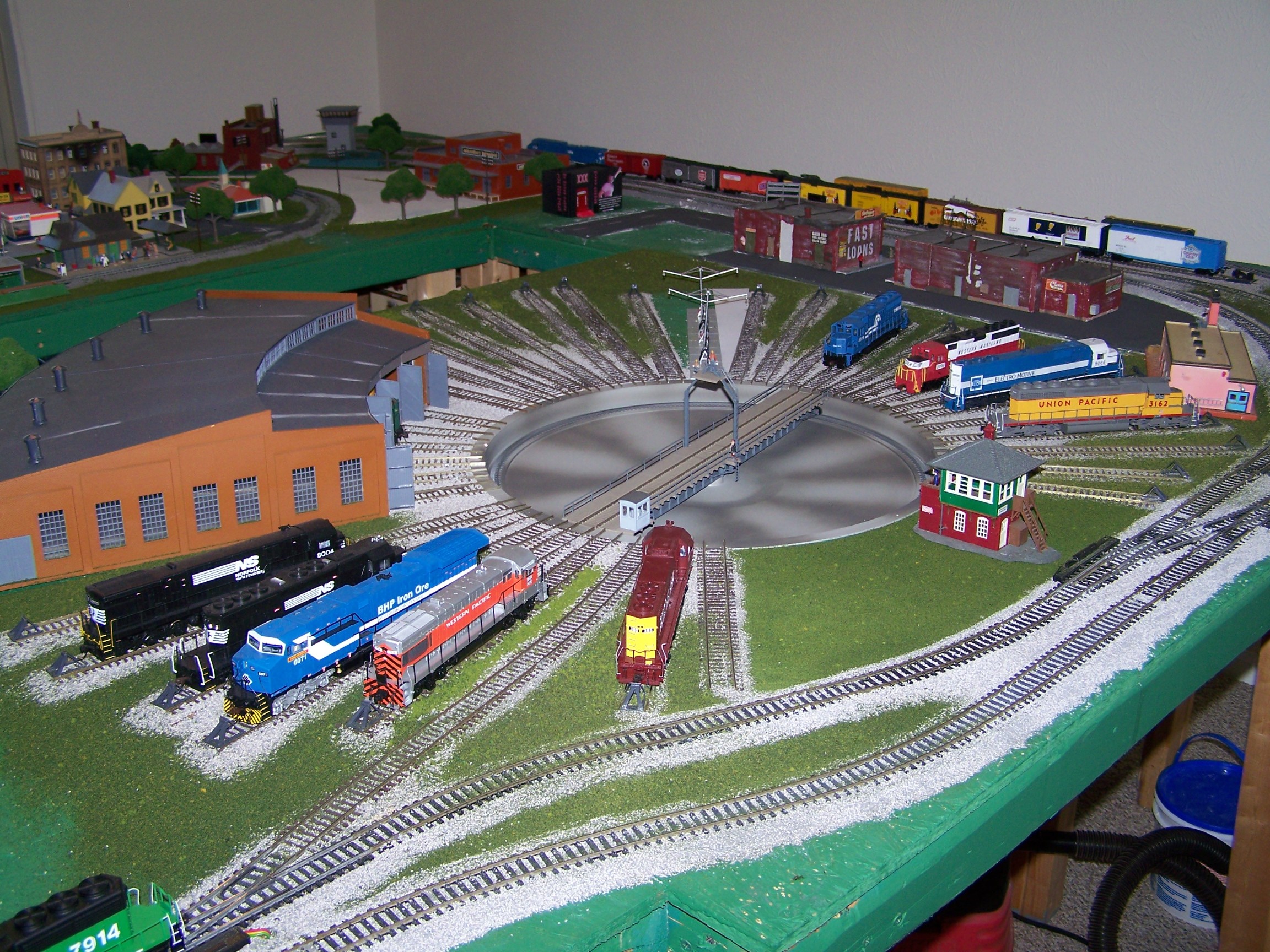

I have the newest Walthers 130' turntable, model 933-2829. Installing the table and wiring are very straight forward. The instructions include a template to cut out the hole in the layout table. Once installed a few screw from under the table secure the turntable.
The wiring is very simple, one wire (similar to CAT 5 cable) connects the turntable to the controller. Then two wires from a power supply to the controller and it's done. Indexing is very simple too. A little trial and error to line up the track to the table is all it takes. Once you line it up you press a button on the controller and the table will hit it's mark each time. The turntable also has a zero point, if you need to remove the bridge for any reason, after re installing the bridge hit the zero button on the controller. The bridge zero's and the turn table is operational. You do not have to reset any of the indexed points.
The only problem I have had with this turntable is a few pieces of ballast got pulled into the gears, I had to remove the motor and clean out the ballast, re-zero and it's been woking fine. Keeping the pit clean is a good idea.
Hope this helps, I can scan and email the instructions to you if you'd like to see them as well. I've added a picture of the turntable on my layout. I'm running an MRC Prodigy Wireless DCC system.

Thank you for the Info & the picture of the Turntable, you convinced me to go with one, I see you have a lot of time in your layout & the turntable & roundhouse bulidings look great, how many inches do Ineed for the pit area ?......... I have plywood base with a paste board on top pus a sheet of the blue insulation on top, probably 1 1/2 " of platform, can always add more insulation board,
Thanks again for your time & Picture as I greatly appreciate your helping to make my mind up,
when finished I will take a picture of what I did, Walthers has a back order on the 130' Turntable until next March & I dont want to wait till than to get one, will have to watch ebay for one,

Glad to help out. The diameter of the hole in the layout table is somewhere between 18 and 19 inches, I'm at work and don't have the exact measurement. The depth of the turntable is maybe 1.5 to 2 inches.
