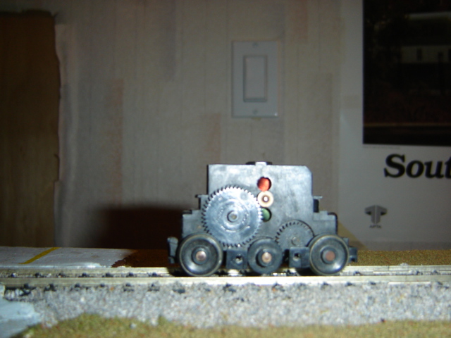

 Posted - November 27 2008 :  7:19:47 PM Link directly to this reply  Show Profile  Click to see DaCheez's MSN Messenger address  Add DaCheez to Buddylist
Inside the tender is just a standard PT drive. All the PT's are pretty much the same...the only difference on the steam engines is how it's mounted (it has tires on all four wheels as well). I haven't taken my steam engine apart for a while, but I think you just need to pop the tender shell off the tabs on either side. You may need to remove the screw holding the bar between the tender and engine as well.
This is what should be inside:
-cheez
