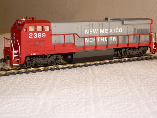

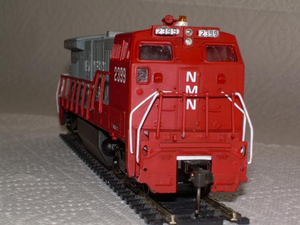

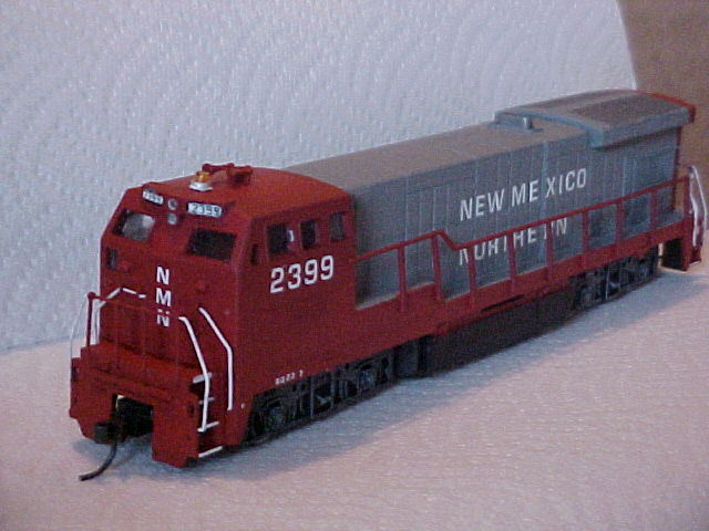

Here are afew photos of my rebuilt Bachmann BQ23-7. It is the old shell ontop of a new Bachmann B23-7 chassie/mechanism. I replaced molded grabs with wire ones. I also replaced the damaged front and rear handrails with bent brass wire and Athearn stantions. The new Bahmann mechanism runs well, so I did not do any work with it. The chassie fit under the old shell after the fuel tank sides were cut away from the shell.

Great work on this Bachmann BQ! Which B'man chassis did you use? the new Standard Line B23/30-7?

Yes, I used the new Standard line chassie for the B23/B30-7. I think the only problem fit wise is the front light bulb needed to be pushed towards the rear slightly.

Thanks John! I used the Bachmann chassis as it was "available". I certainly wouldn't use a chassis off a favored loco for this project. Just too many other options available to make such a sacrifice worth while.
The old, blue-box Athearn B-B GE chassis will work fine instead. I would replace the original Athearn motor and make sure you get a later production frame that was designed for flywheels.
