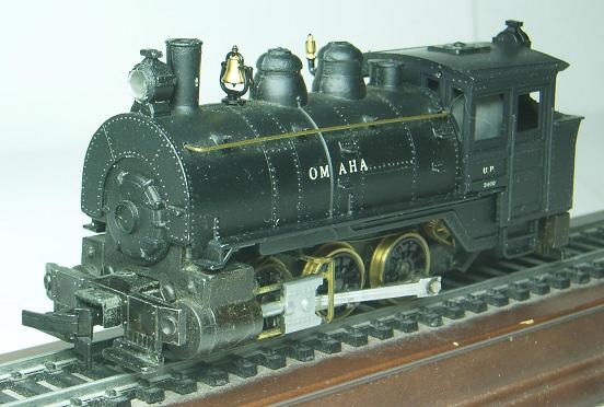

Here is a photo of the 0-6-0t. It smokes and chugs. The smoke unit puffs smoke in sinc with the cylinders. It chugs with each rotation of the axels.

I've got 2 of those, Frank, but they're currently both in pieces. I installed a powerful can motor in one of them, because both had 5 pole open frame motors that didn't have the torque to run them, particularly with the chugger installed. I generally leave the shakers out anyway, since they affect performance. Yours has the better motor (at least I assume it was). I'll have to get back to them one of these days, but they haven't been a priority. They have a lot of slop in the axles.
 Posted - October 26 2008 :  3:49:54 PM Link directly to this reply  Show Profile  Add toptrain to Buddylist
Nelson : I have a few of them to and all mine run fine. As to sloppy, when you have three axels, all flanged and they are properly gagued, it is hard for a three axel loco to be sloppy.
If you look in the cab of my 0-6-0t in the photo you see a cast metal motor. All mine are the older ones with the Diecast motors. Revells newer cheep copy of pittmans DC 60 open frame motor isn't that good. That is proably why they need remotering. If you can find the old motors, they are OK!
Edited by - toptrain on October 26 2008 3:52:40 PM
 Posted - October 26 2008 :  5:00:54 PM Link directly to this reply  Show Profile  Add NickelPlate759 to Buddylist
You're right about those Pittman knock-offs... they have no torque, and one of them shorted some windings for no apparent reason. There wasn't even a noticeable increase in torque with a new stack of neodymium magnets.
I haven't been able to locate those older motors. I'm sure they had enough torque to overcome the the sprung shaker, but I think mine have some wear on the middle axle bearings from excessive running.
 Posted - October 27 2008 :  08:18:30 AM Link directly to this reply  Show Profile  Add toptrain to Buddylist
Did you notice that you can just, after removing the brushes, twist the rounder plastic front and the motor comes appart. Seperating the armiture from the magnet. frank

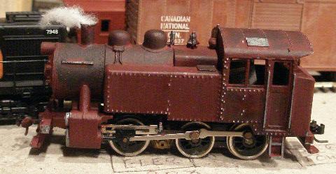

I recently was given one by a train pal. It runs, sort of, at high voltage, makes a shaking bead sound, and
does not smoke. It DOES however, throw a steady stream of sparks from the left side, but does not short
the transformer. Any ideas what could be causing the short? Seems to emanate from side rods.

Since it's not a true short to ground, I think that the wipers are missing or not making contact. The electricity is finding a connection through the side rods, the sparks are caused by electricity jumping the gaps. Whereas normally, the electricity would go through the wheel and be picked up by the wipers and then to the motor. Just a guess. I'd really need to see the loco in action.

[It DOES however, throw a steady stream of sparks from the left side, but does not short the transformer. Any ideas what could be causing the short? Seems to emanate from side rods.
Originally posted by Chops124 - October 21 2014 :  11:22:32 PM
Check the backs of the side rods for pitting. That arcing should cause some if the wheels are shorting to the rods. At model railroad voltages, about the only way you could arc across from the wheel to the rods is if the rods were touching the wheels and then pulling away again, so look for something misaligned that would allow that contact to happen.
The pictures show wire wipers on the tops of the left wheels. These could arc a bit if they were picking up off of dirty or corroded wheels. That would be more analogous to a loose connection than a short and would not short the transformer. Cleaning those wipers and the wheels would reduce the arcing and would be a good test to try.
 Posted - October 25 2014 :  8:43:58 PM Link directly to this reply  Show Profile  Add NickelPlate759 to Buddylist
Make sure the pickup wiper is resting properly on both wheel treads. It may have slipped off one driver and be shorting to the connecting rod. Also check the wire lugs screwed to the wiper mount... if they're not properly positioned they can short to the smoke unit.
