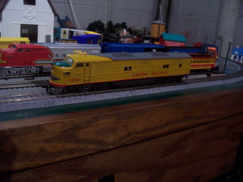

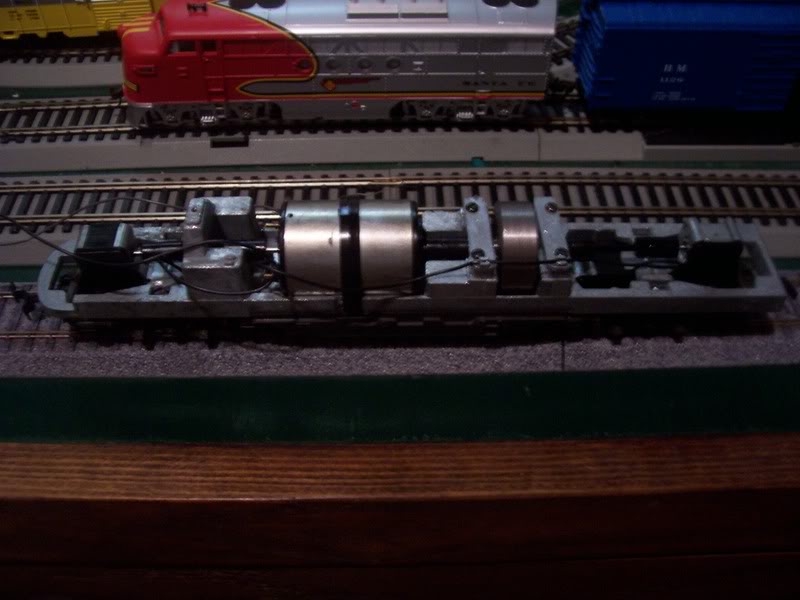

This frame has no marking...Could anyone tell me who made it ?
and also what model is this EMD ?
Thanks for any help or info
Bob

hi i would say emd e6/7 but maker? tycoish horns ken

I think it's Atlas/Roco E7.

Nope! Not an Athearn. It is an E-unit made by Roco. You can tell by the metal+plastic trucks and that huge, round motor. The loco was imported and sold in the US by Model Power.

The motors in those old Rocos run forever. The gearing tends to be a little noisy, though, and sometimes the motors roar. I have one that's pretty quiet, and another that, well, to paraphrase a description I saw on the Atlas forum, sounds like a Hoover upright trying to vacuum marbles off a hardwood floor.
 Posted - October 24 2008 :  11:58:47 AM Link directly to this reply  Show Profile  Add toptrain to Buddylist
It is a Model Power by ROCO E7. And it is a puller. Noisy due to that strange loose coupling that ratles away. Change it to a piece of tubing and it will quiet down.
 Posted - October 24 2008 :  12:15:47 PM Link directly to this reply  Show Profile  Add NickelPlate759 to Buddylist
Originally posted by toptrain-October 24 2008: 11:58:47 AM
I've already done that to mine, but unfortunately the problem is an unbalanced armature.
 Posted - October 24 2008 :  12:36:44 PM Link directly to this reply  Show Profile  Add toptrain to Buddylist
If you are talking about the popping you feal when you turn the motor shaft that in normal for those motors. Did you put tubing 0n both shafts that go to drive trucks? Also gress all gears and oil motor bearings?
Edited by - toptrain on October 24 2008 12:38:41 PM
 Posted - October 24 2008 :  1:51:30 PM Link directly to this reply  Show Profile  Add NickelPlate759 to Buddylist
Yes, it's greased and oiled with Super Lube, and runs reasonably well, but the motor is unbalanced, as I said. In taking it apart I discovered that someone already tried to balance it by laying epoxy putty in the gap on the light side of the armature, but it either wasn't enough weight, or they overcompensated. I've found this in a number of these E7/8's I bought secondhand, so it's clearly a common problem a lot of modelers tried to remedy. Another trick is to drill holes in the laminations on the heavy side until it balances, but that's risky. Model Railroader had an article years ago about how to do this to old Athearn motors.
I haven't replaced the universals with silicone tubing. I've tried tubing with a length of shaft inside as a substitute for universals, but the tubing introduces friction in the bearings when the trucks turn. Better to replace them with NWSL universals, but I'm not going to invest the money. The gearing is also coarse with a lot of slop, and that causes the wheels to scrub the rails a bit. You can see it in the wear pattern on the wheel treads. Later versions of the FA and Shark had much finer-toothed gearing and shock-mounted motors that made them much smoother performers.
