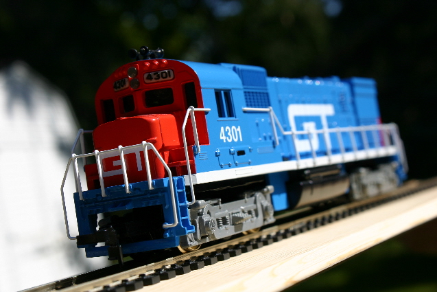

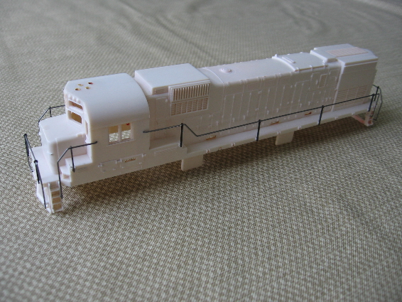

 Posted - April 20 2009 :  7:15:12 PM Link directly to this reply  Show Profile  Add bkoch to Buddylist

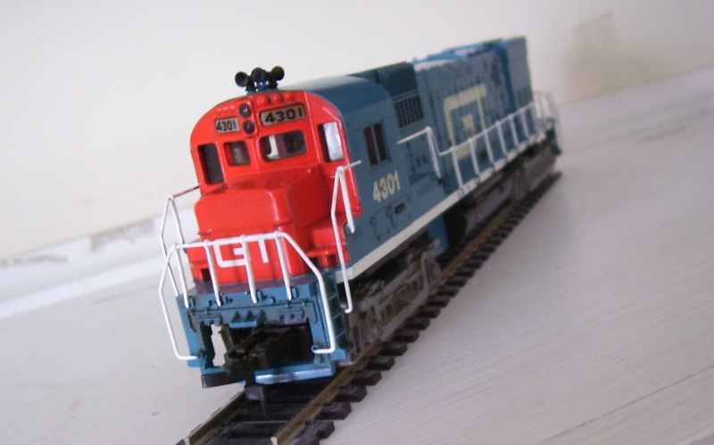

Hi, and thanks! This is actually a repaint (if you couldn't tell already) of a former Rock Island 430. I haven't been able to find an original GT yet. Below is a photo of it during handrail fabrication.
I recommend buying some 0.020" music wire to make your own handrails because the stock ones aren't always quite right. You know, if the angles aren't in just the right places, you can get some strain and buckling of the rails.
Form the handrails with needle nose pliers and install them to check for fit and alignment. Then take them off, but leave the stanchions in their respective positions on the rails. Paint everything so that you have coverage of the areas that won't be accessible when the handrails are on the locomotive. Keep the paint thin, though, because you will still need to slide the stanchions around a bit to get them back into place. Wrap your locomotive in one layer of plastic wrap, then re-install the handrails by poking the stanchions through the wrap. Make sure everything is straight (use some CA here and there to hold it if necessary). Paint again to even out the color and repair any installation damage. Pull the plastic wrap off around the stanchions and you're done. It's a fair amount of work, but completely worth it. I've used Testor's Model Master flat or Series 1 gloss enamels for all my handrails so far.
I posted a photo of all three of 430's with painted handrails on Brianstyco's Siver Streak post from Feb 18. Right now I'm working on handrails for a Chessie 630, and a Super Spirit of '76 630. The tough part for the Chessie is matching that Vermillion Orange, but I think I'm getting close. I'll post some pics when they're done.
Regards,
Brian

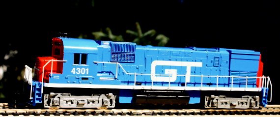

bkoch,
That is a terrific custom paint job on the GT clone. I thought it was original. Look out ebay. The paint looks factory and I'm sure some will say better than factory and are right. Crisp handrails too.
I painted my driver GT Alco's handrails cause yours looked so nice. Mine are OK and I may post a pic.
Care to share the GT paint details? BTW just paint up a Tyco caboose in GT ,don't wait for one.
I had to strip the weathering, you can see some on the pilots. I bent some of the handrails from .022 I thought.
My pic was an attempt to imitate yours in a complementary fashion.

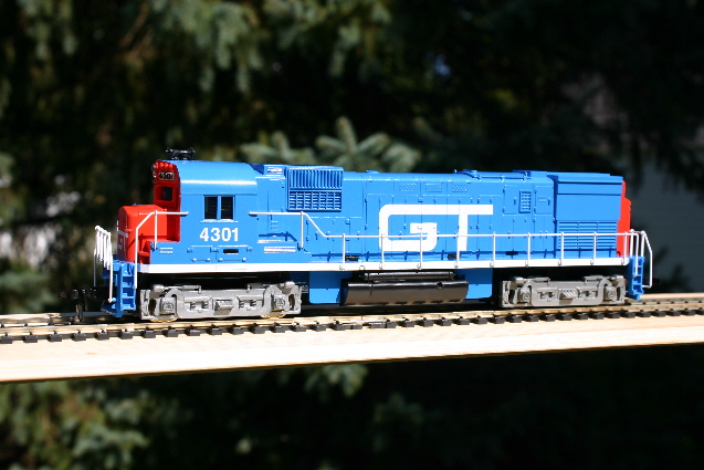

 Posted - April 21 2009 :  11:20:56 PM Link directly to this reply  Show Profile  Add bkoch to Buddylist
Alcofan,
Those handrails look great! That's a nice original GT.
After a lot of experimentation, I ended up lightening Testor's 1111 Dark Blue with 1145 White to get the right color. It's difficult, though, because when you see Grand Trunk Blue in the field it's appearance varies a lot as it goes through the various stages of weathering. I looked at a lot of photos and even talked to a guy who had pulled a paint chip from one sitting in a yard! I quickly became convinced that there was no pre-mixed color on the market that hit it on the nose. I'm not sure if I got it right either, but I finally gave up and just painted it. Sometimes it seems like Tyco used a paint that was nearly gray, but the blue on yours seems right to me. That is, it would certainly fit into the spectrum of Grand Trunk Blue that you would see in real life.
I airbrushed the blue, then masked the ends and primed them white. I have found that Tyco always used white primer under light colors to keep them bright and even. I mixed Testor's 1127 Orange and 1103 Red to get good match for Morency Orange and applied that, then added the white stripes. The great thing about Testors paints is that they give a finish that is comparable to the original Tyco paint. If you're a Tyco fan, you have to love that outlandishly glossy finish, right?
I finshed with decals from Microscale, set #87-650. As you would expect with their decals, they're nice and thin yet perfectly opaque.
I guess it seems like I lavished a lot of attention on this one, but I had to. I live in the heart of Grand Trunk country and I pass under a bridge every day on my way to work that heralds the "Grand Trunk Western Railroad" in faded, almost illegible letters.
Thanks for all of the positive feedback and the suggestion to repaint a caboose. I think I will do just that.

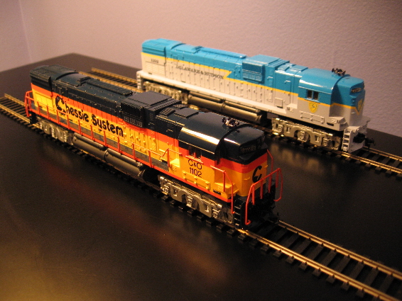

 Posted - June 01 2009 :  6:37:37 PM Link directly to this reply  Show Profile  Add bkoch to Buddylist

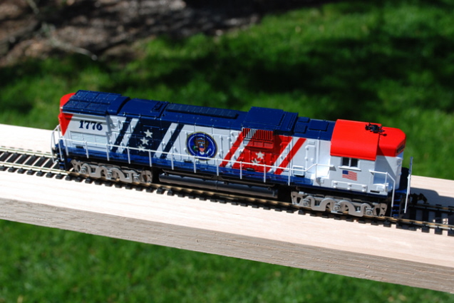

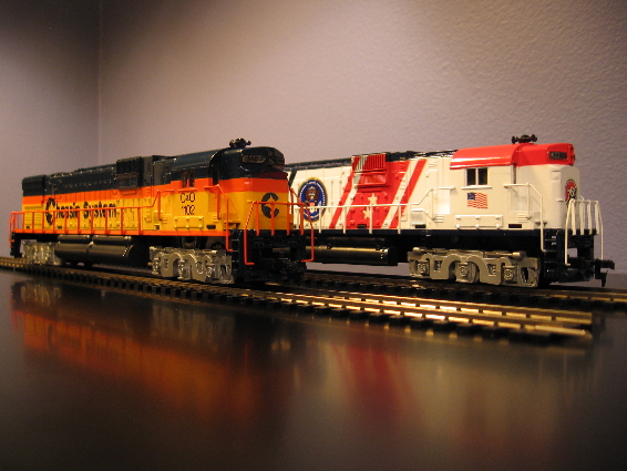

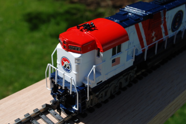

Hi Alco Fan. Here is the finished Super Spirit of '76 with painted handrails. Chessie 630 is up next.

 Posted - June 01 2009 :  8:34:17 PM Link directly to this reply  Show Profile  Add Alco Fan to Buddylist
Awesome. You repainted this? Is this a clone? How did you protect the decals. Sweet!

 Posted - June 02 2009 :  10:59:33 PM Link directly to this reply  Show Profile  Add bkoch to Buddylist
Thanks! It's a partial repaint. I painted around the base of the long hood where the white didn't quite cover completely. I also removed a lot of red overspray by buffing with a cleaner wax. Finally, I sanded and repainted the cab roof because it had some huge pieces of debris caught in the original paint that looked like carpet fibers.
The decals were loose and split, but completely intact. I used some Micro Sol to soften them and get them to lay down smoothly, then sealed them with a coat of Micro Gloss.

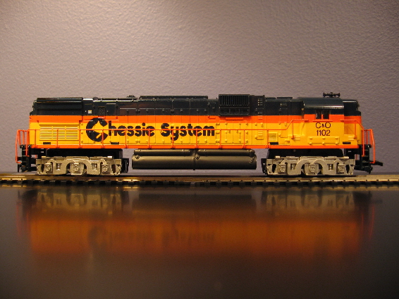

 Posted - August 12 2009 :  11:32:38 PM Link directly to this reply  Show Profile  Add bkoch to Buddylist
Hi Alcofan. Here's the next installment in the painted-handrail Alco 630 series. This Chessie was a tough one - it was all about matching the orange. I experimented over a series of weeks and finally settled on a mixture of Testor's FS12197 International Orange and 1127 Orange. It's darn close to the Tyco color. In fact, I sanded and re-sprayed a couple of spots with it. The orange stripe on the side of the cab facing the camera had been badly re-touched with a brush at the factory and there was a chip in the orange stripe at the bottom edge of the cab. I'm surprised at how the repairs just disappeared.
I primed those spots and the handrails with straight-up Testor's 1169 Flat Yellow, which contributes a lot to the brightness of the orange topcoat. I also enhanced the paint elsewhere, by cleaning the factory orange overspray off of the blue paint (a very common problem with this locomotive), masking and repainting the Chessie System logo, and touching up the yellow at the base of the long and short hoods to give a nice crisp line between it and the blue walkway. I have a couple of nice Chessie SD-24's that I really like, but I think this one is my new favorite.
Up next is the D&H 630 shown below. Obviously it'll be much easier than the Chessie, but probably not as rewarding. I've got an older ICG 630 with the darker orange paint scheme waiting its turn as well.

OH WOW! A custom Chessie Shark - I'M IN LOVE! PLEASE MAKE ME ONE
BlaxlandAlex3
Jupiterpfp2
 Posted - July 08 2020 :  4:50:42 PM Link directly to this reply  Show Profile  Add BlaxlandAlex3 to Buddylist
Originally posted by RP model railroads - July 08 2020 :  4:14:25 PM
If covid didnt exist I'd pick up a shark shell at a train show and make one for you
 Posted - July 08 2020 :  5:50:47 PM Link directly to this reply  Show Profile  Add wks to Buddylist
Certainly an attractive looking engine.
Same photo from bkoch. Just changed a bit to enhance this beauty.
 Country: USA  ~  Posts: 8096  ~  Member Since: February 12 2014  ~  Last Visit: October 17 2026 Alert Moderator  Go To Top Of Page
 Posted - July 08 2020 :  6:20:42 PM Link directly to this reply  Show Profile  Add wks to Buddylist
Chessie shark is nice as well.
 Posted - July 08 2020 :  6:28:42 PM Link directly to this reply  Show Profile  Add RP model railroads to Buddylist
Originally posted by BlaxlandAlex3-July 08 2020: 4:50:42 PM
You, among others, are quite talented with painting & detailing. I, not so much. Although I have done a few custom locomotives that turned out fairly well, they certainly pale in comparison to what you see above. All of us have different gifts....
