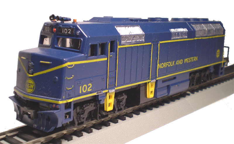

I'll add to Tony L.'s survey of Life-Like drives with a gruesome look at the mentioned Kader-Bachmann pancake drive.
He said he didn't have an example, so I went digging and pulled out this Norfolk & Western custom Bachmann F40PH...I think this is an example of the drive. Somebody say, if it's not...
This drive arrives in the Bachmann line around the mid-'70s and remains until the '90s without much alterations. This example is a late '80s version with what are still decent EMD truck castings. The original truck side frames are horrible totally flat monsters that were truly poor. I'll dig up an example of that one soon.
This drive was used in the GP40, F-9A, F40PH, U36B, GP30, and possibly others by Bachmann.

By the way, that N&W F40PH is wearing an Overland Models brass horn. Probably worth more than model itself. [;)]

 Posted - November 09 2006 :  11:57:31 PM Link directly to this reply  Show Profile  Add GoingInCirclez to Buddylist
Yeah, I didn't have a Life-Like Kader unit to demo.
My Lionel BN "181" GP30 has it though... AND those TERRIBLE flat trucks!
That's not a bad idea for a paint job on that N&W F40, by the way. Lose the yellow rectangles, and it's sort of believable in a D&H-inspired way. I like it. But I'll admit that I've done stuff like the yellow boxes in my day ;)
Edited by - GoingInCirclez on March 27 2009 10:29:41 PM
Tony Cook
TycoGMOGP20Avatar
 Posted - November 10 2006 :  12:12:32 AM Link directly to this reply  Show Profile  Add Tony Cook to Buddylist
Yellow Boxes? You lost me?[?]

 Posted - November 10 2006 :  12:16:40 AM Link directly to this reply  Show Profile  Add GoingInCirclez to Buddylist
The parts of the body that are painted yellow - seem to make some rectangular boxes along the side...
