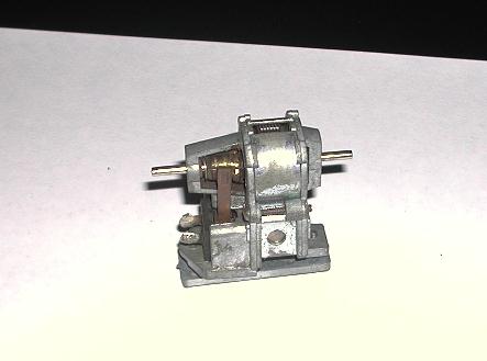

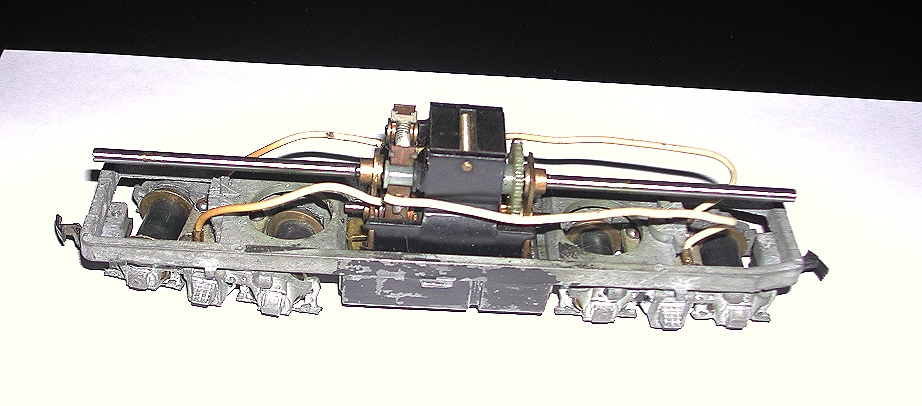

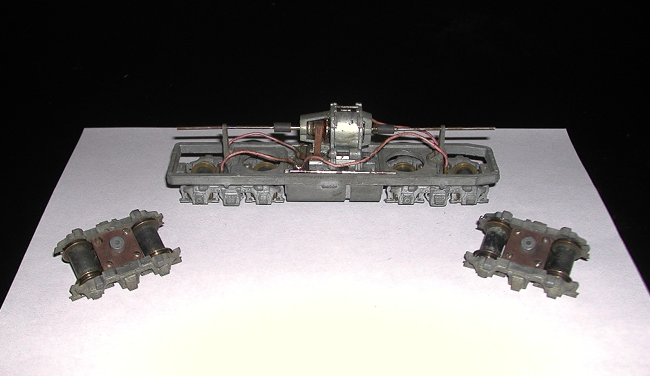

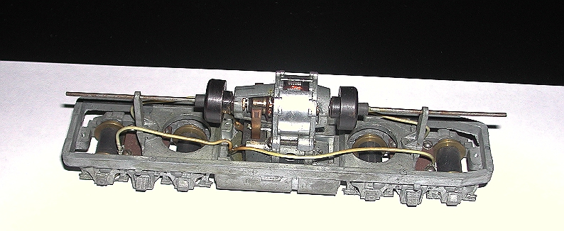

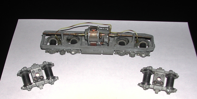

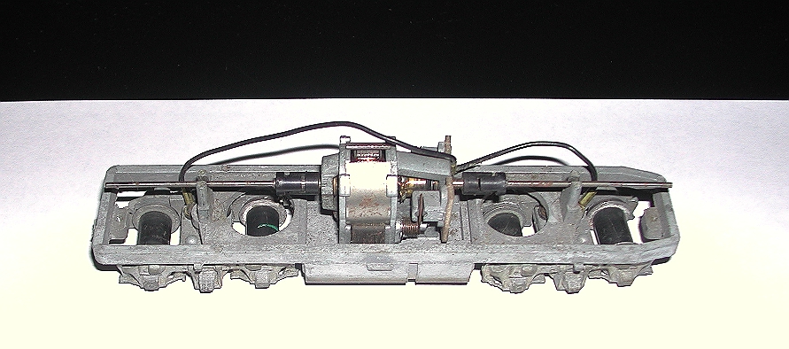

Hi Guys. Here are the pictures. Hi-Fi Drives were used from mid 1950s to Early 1960s.
1st The Early F7A Hi-Fi.
Had Insulated truck Frames. So there had to be a wire from each side to the motor for power. Shaft Support were held on to chassis with truck mounting screw. Check out the motor brushes.
2nd Variation has a newer style motor with redesigned trucks. Wiring is simplified to only one wire to motor, using ground from trucks to chassis.
3rd Variation. Same as 2nd except the shafts had flex joints on motor and the shaft supports were open on the top.
Now, this is an early drive with Flywheels added. Performance did not improve much.
This drive has the Kemtron Motor assembly. The Motor has a gear box with much thicker shafts. Did not need the shaft supports. Runs very smooth with Flat sided Drive bands.
Next, We will have to post the different Types of Geared Drives Athearn used on their engines. But, that will be another day. [:D]

 Posted - July 26 2008 :  12:29:18 AM Link directly to this reply  Show Profile  Add romcat to Buddylist
Hey Carl:
Mid 50's-60? What about the Hustlers made after that or did you mean just the F7's? There were Geeps in HI-F as well as RDC's, are you aware of any others notwithstanding the Hustlers?
Any thanks so much for those Pics I'll archive them for later reference!

 Posted - July 26 2008 :  08:39:46 AM Link directly to this reply  Show Profile  Add VintageHO to Buddylist
Hi Gareth. They all had the same HI-Fi Variations. Will dig out the Geeps and RDCs next.
The Hustlers just had two styles with the different Wheel axles..
There were many different types of Gear drives. Athearn did a lot of changes trying to get a good running drive that was inexpensive.
And then, there were the Conversions that companies like Kemtron, Lindsey, Hobbytown and others made to Fit the Athearn engines.
The CN F7 engine did not appear until the Gear Drives started. It was first cataloged as #0125 and #3125 Early 1960s.
