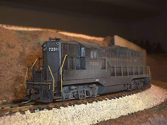

 Posted - October 23 2006 :  02:40:34 AM Link directly to this reply  Show Profile  Add Ray Marinaccio to Buddylist
I'll have to get a better photo but this is one of the GP 18s I converted to a GP9.
Ray
Ray Marinaccio
RayAvatar
 Posted - October 23 2006 :  03:15:28 AM Link directly to this reply  Show Profile  Add Ray Marinaccio to Buddylist
This one has a bit more modification.
I actually only used the hood sections. It has an Athearn cab, dynamic brake blisters, horns and stantions.
Detail Associates cooling fans, headlights and drop steps, MU recepticles and coupler lift bars.
The pilots, walkways, railings, MU hoses, grab irons, classification lights, lift rings and windows are all scratchbuilt.
It rides on a P2K chassis.
Ray
