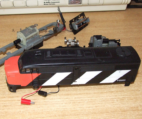

 Posted - May 16 2008 :  08:34:34 AM Link directly to this topic  Show Profile  Send catfordken a Yahoo! Message  Add catfordken to Buddylist
has anyone got an instruction sheet for this item,hoseeker only has catalogues ken

 Posted - May 16 2008 :  2:31:52 PM Link directly to this reply  Show Profile  Add GoingInCirclez to Buddylist
I don't have an instruction sheet, but I've worked on several of those. Actually come to think of it, the Greenberg Guide to Lionel HO Vol 2 has copies of the sheets.
At any rate, there are three variations of the drive. The first had one powered truck, the second had both powered trucks, and the third was the Kader-krap drive.
I can tell you that some of the wiring which appears to be in yours is not OEM equipment.
Almost all Lionel-HO drives with the can-type motor, suffer from broken trucks. The plastic tabs that hold the sideframes to the gearbox snap with age and cannot be reglued. I have devised a very simple and reliable method to repair them but is does take a little bit of work.
 Posted - May 16 2008 :  5:26:59 PM Link directly to this reply  Show Profile  Add NickelPlate759 to Buddylist
Interesting. The trucks and frame look like a Roco design. They're very similar to their FA's and Sharks. The motor is a GE. I have a couple of them in my parts box.

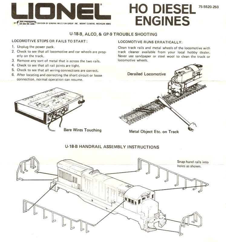

Ken,
I checked the two Lionel-HO 1970s FA's I have and both include the following sheet, which happens to have no information regarding the Alco FA!

Is this what your looking for?
http://www.hoseeker.net/lionelhoinformation/lionelhopa1diagram1974.jpg

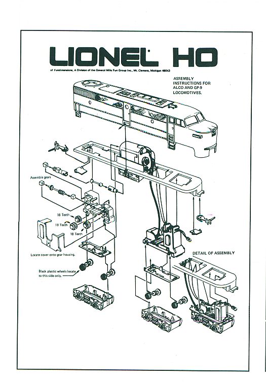

VintageHO
Tyco Time
 Posted - November 16 2009 :  6:56:05 PM Link directly to this reply  Show Profile  Add VintageHO to Buddylist

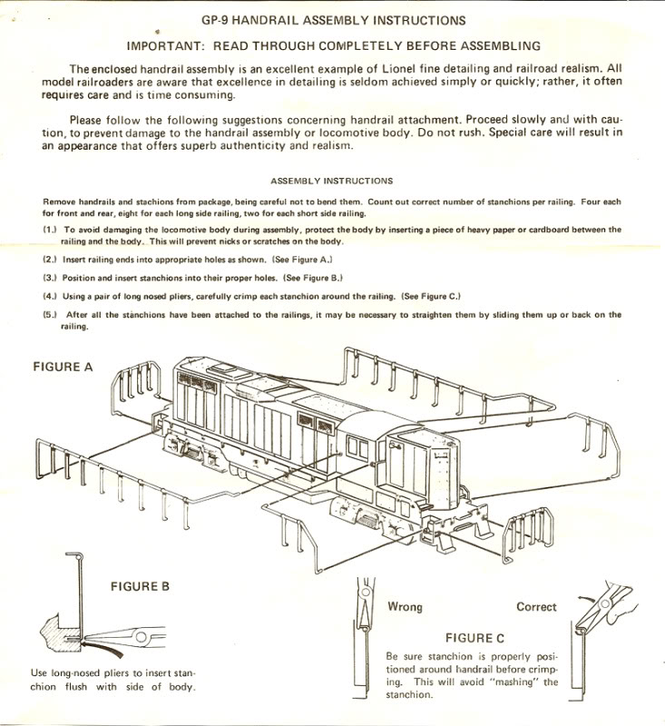

Hi Ken. Had the same Problem as Tony. They packed GP-9 Instructions with the FA-1 engine. Anyway, I finally found this hope this helps. By the way, I also use a small screw drilled into the plastic Frame that contacts the metal frame tab, to hold it together. Works perfectly. Carl

Now that you posted this, Tony, I remember now that the instruction sheet for the GP-9 handrail assembly came with my Rock Island Alco unit.
