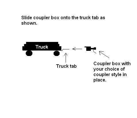

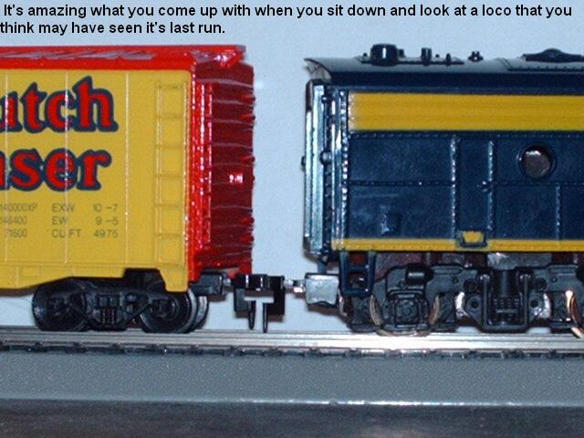

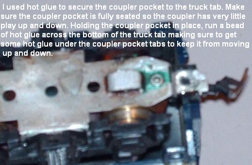

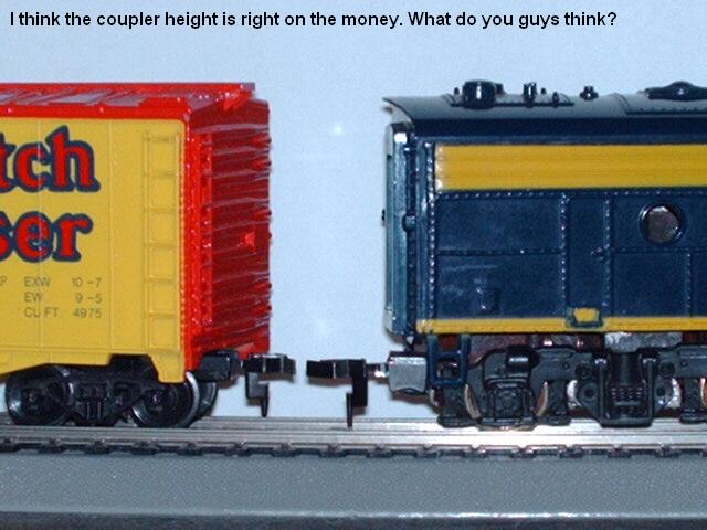

Hi All,
I find it to be a real drag when a perfectly good loco has to sit on a shelf because the rear coupler is broken. So last night I sat down with a loco that had just that problem. I looked at putting on a Kadee coupler box but found that to be quite the pain. So I looked around in my spare coupler parts bin and ran across an athearn plastic coupler box ( thats what I call It anyway ). I found that it would slide onto the truck tab real nice so I thought why not drill out the old pin hole and see if this will pop into place. Well the coupler box did pop into place but it had some up and down slop that let the coupler sag. This slop is caused by the fact that the truck tab is very thin matal and the coupler box is made for something about twice as thick. I solved this by making sure the hole in the truck tab was only as big as the tip of the pin in the coupler box. The base of the pin is wider to keep the coupler box from being pushed down too far and pinching the coupler causing it not to move left and right. This way I could push down on the coupler box and run a bead of hot glue across the bottom making sure to get some glue under the tabs on the coupler pocket. See pictures below. I have only tried this on this style of truck but it looks as if it would work on the other older locos I have with the metal pin holding the coupler in place.
Please forgive me if someone has done this already. Sorry about the picture quality. I hope the way I have this laid out makes it easy to understand. Any comments would be great.
Thanks

 Posted - April 21 2008 :  3:04:12 PM Link directly to this reply  Show Profile  Add Ray Marinaccio to Buddylist
That's a good idea.
I will have to try that.
Ray
 Posted - April 21 2008 :  6:05:17 PM Link directly to this reply  Show Profile  Click to see DaCheez's MSN Messenger address  Add DaCheez to Buddylist
Hey mytyco. That looks like a good idea. The engine you used has the thinner silver coupler box from the early 60's right, and not the wider black one from later on? I always find those ones a pain to fix because standard horn hooks dont fit in them...you need to cut the tab off the coupler and then put a special wire in.
-cheez

 Posted - April 21 2008 :  10:05:54 PM Link directly to this reply  Show Profile  Add mytyco to Buddylist
Hey Cheez,
Yes the engine is the older one with the thinner truck tab. The nice thing about doing it this way is that you can use just about any style of coupler with it. At first I had a Kadee #5 in it but decided to stay old school with this loco and put an X2F in it. I have a GP20 with the wider black truck tab and a broken coupler that I may try this on soon.
