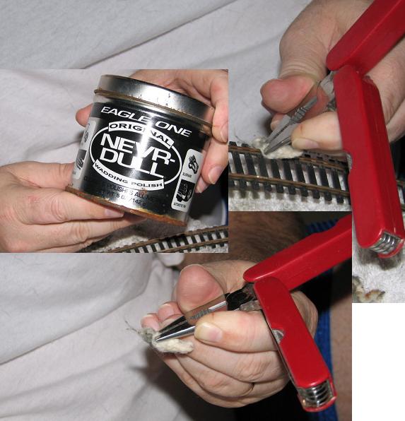

I used some Never-Dull wadding polish to clean my rails. If you get it on the plastic it might dull it a little but so far it's been working fine.. I might try the contact spray below also..

I use "Never Dull" between a paid of pliers or tweezers and run this along the track. This is keeping most of the never dull away from the platic. I noticed that if I get it on the plastic that it fades the plastic a little. After I clean with "Never Dull" I clean the track with soap and water. Then I make sure I dry each tack well.. They really shine...
