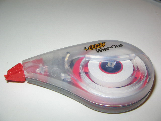

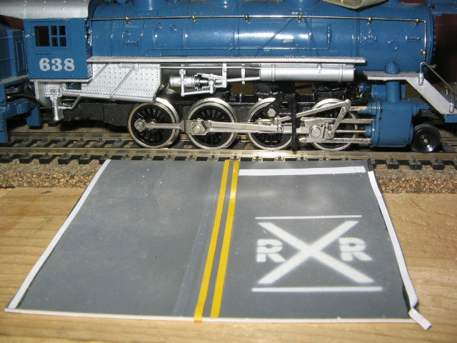

Cheez-- I use styrene sheets painted flat black and the lines are from scale scenics. After the lines are applied--i spray a dull coat to seal the lines even though they are adhesive backed. You can also paint the plastic with auto gray primer for older road look. I use brass stencils to mark RxR crossings. To paint stop marks or crosswalks-i use a Bic white-out roller. See photo below. The van is a G-I-C custom that i purchased from him. I have several that i will be posting later. The road width i use is 3 & 1/8th inches wide. sytrene thickness is 1mm. You can use different thickness on styrene. I took drafting in High School and use my drafting tools - T square(clear drafting type) and board to cut the streets. While you do not have to have drafting experience--it is helpful when making roads. There are many more methods to making roads than i mentioned or covered.
Roadway with custom G-I-C van / Road stripes=Scale Scenics
Bic White Out Roller

 Posted - March 23 2008 :  12:09:37 PM Link directly to this reply  Show Profile  Add Brianstyco to Buddylist
Thank you Roy. Here is a photo of the Krylon Auto gray primered street with brass stenciled RXR and the BIC white stop mark
