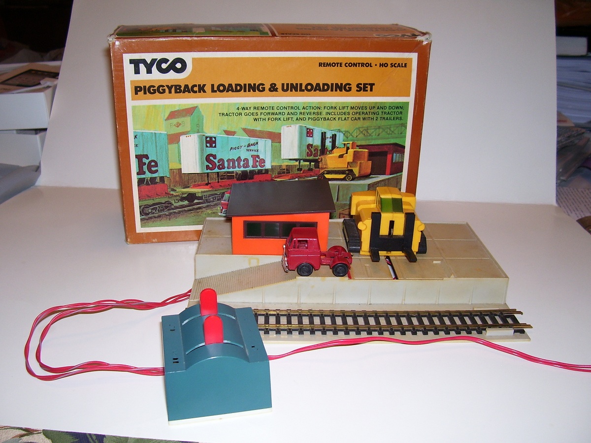

I just got a 933, on box, brown box piggyback loader/unloader with box and red Dodge tractor tractor but no flatcar or trailers. The base and ramp are dirty like it sat in sunlight or a smokers home
It runs ok but I was wondering whether you could oil the fork lift without removing it from the base. The actual auction cost was under $10.
Any other maintenance tips out there?
BTW after I posted this I read the original post which I'm sure I read a long time before getting one. Very useful.

 Posted - August 31 2011 :  8:23:06 PM Link directly to this reply  Show Profile  Add Alco Fan to Buddylist
Here's a pic.
