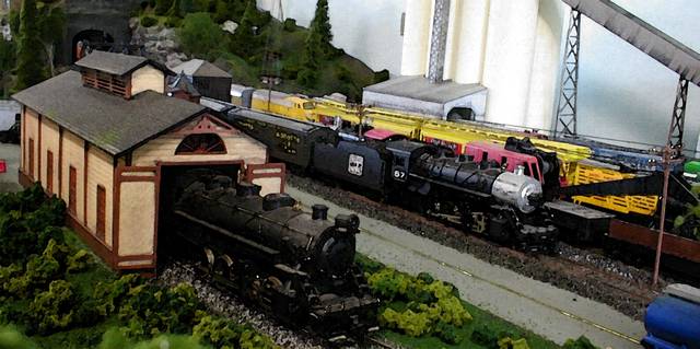

I have my first loco given to me at the age of 2, that has forever changed my life. I am addicted to trains as a result of this loco. However i ran it into the ground, The motor no longer works, I have spent numerous hours trying to fix it to no avail. I am wondering if anyone has successfully repowered one of these without being a full time machinest. I would love to get a drop in replacement motor. I figure this forum is the place to ask these questions

Nice picture, beautiful layout. Welcome to the TYCO forum. Take a picture of the motor in the chassis if you can. I might be able to help. -Bob
