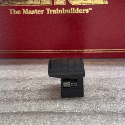

 Posted - September 19 2025 :  10:25:03 PM Link directly to this reply  Show Profile  Add wks to Buddylist
eBay had a matte black cab piece for a Pacific engine recently sold.
I guess matte black is the common color.
Google search for paints for models such as planes will give you some ideas. Good luck.
