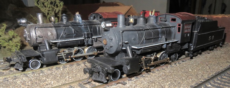

I have two Mantua Prairies that share the job of yard switching and way freight duty.
Engine 52 rolls smoothly down the 5 percent grade with little or no bucking.
Engine 50 was bucking mildly taking a heavy train downhill.

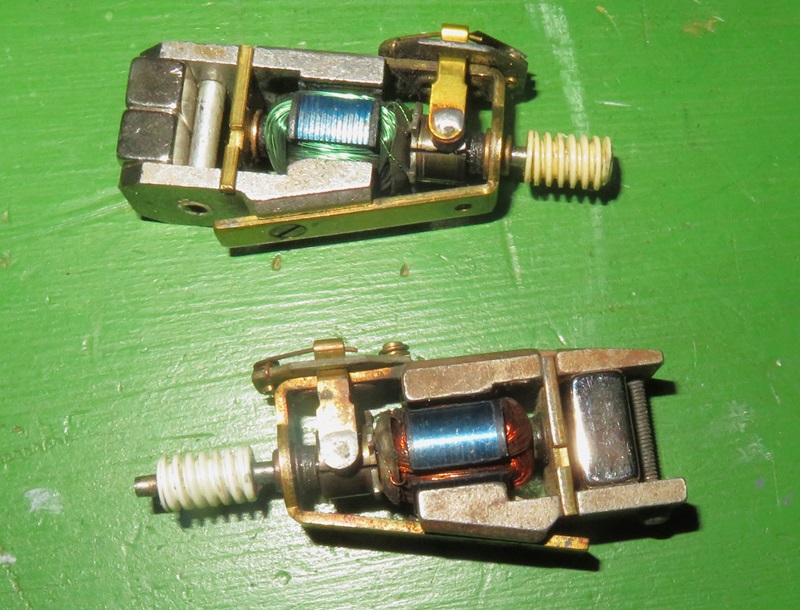

Ironically engine 52 has about twice the end play in the motor/worm shaft. Why was 50 the engine with the problem? Bucking can be overcome by brute force of low-end torque. The motors in both locomotives have had their magnets replaced by more intense rare earth magnets, but they were not the same. Engine 52 has the older style motor with a screw by the magnet, so the replacement magnets were closer to the armature and therefore more powerful, resulting in more torque, lower top speed and a lower current draw. Engine 50 had the newer style motor with a rivet, which is placed farther forward, forcing the magnets back farther away from the armature thus slightly weakening the field. It was enough to make the locomotive buck downhill a bit. Fortunately, I had another motor around with the screw arrangement and put the powerful magnet in it. With that motor, 50 is as smooth a runner as 52.

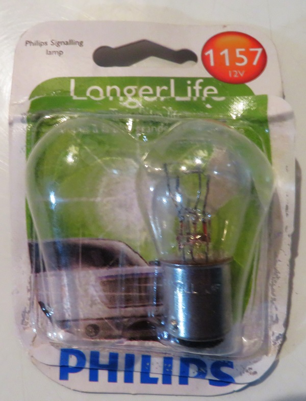

I only use rheostat throttles, and I have learned that an automotive taillight bulb wired in parallel to the track makes for better control of low-draw motors. It also smooths out the downhill bucking somewhat by eliminating the problem described in Model Railroader Magazine. It’s no longer just a balance between the motor and the rheostat. The light bulb shares the voltage with the rheostat, and the motor inherits the bulb's voltage.
Most taillight bulbs I’ve tried worked, but I found that the ones used in my last car (a Jeep Patriot) were too high wattage and overloaded the transformer. One kind that does work is this:
I also have a switch wired to each light bulb so I can choose not to use it. The light bulb is not needed with motors with a high enough current draw nor when the train has more than one locomotive.
Note also, that my power packs deliver a full ampere of power. It's possible that a small trainset pack might not handle the train and the taillight bulb, both.
