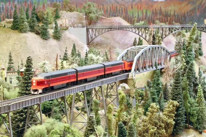

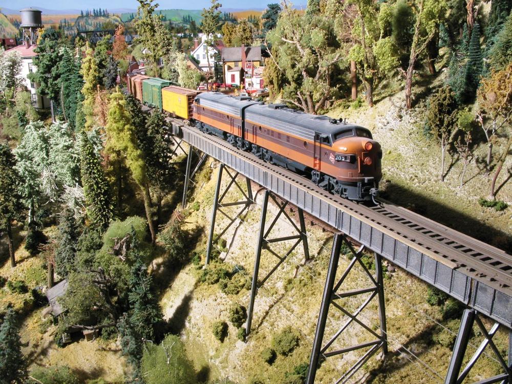

An incredible private HO scale layout.

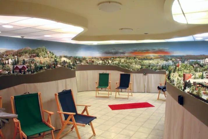

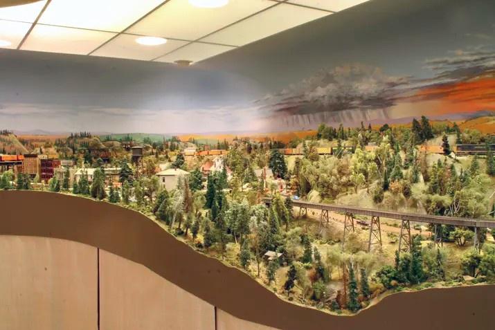

The backdrop was built using drywall.
To avoid right angles coved plywood forms were installed first.
Then the drywall was scored and worked into place.
The backdrop was painted by Twin Cities artist and former art teacher Andy Ostazeski.
He used photographs that Bill had taken in Montana as a guide and matched the colors to the layout’s scenery.
The model railroad was illuminated with incandescent and halogen lighting.
Two vent fans were installed in the ceiling to combat the heat that was produced by the lights.
The original lighting plan called for a computerized day to night sequence.
Also RGB light emitting diodes for realism but it never came to fruition.

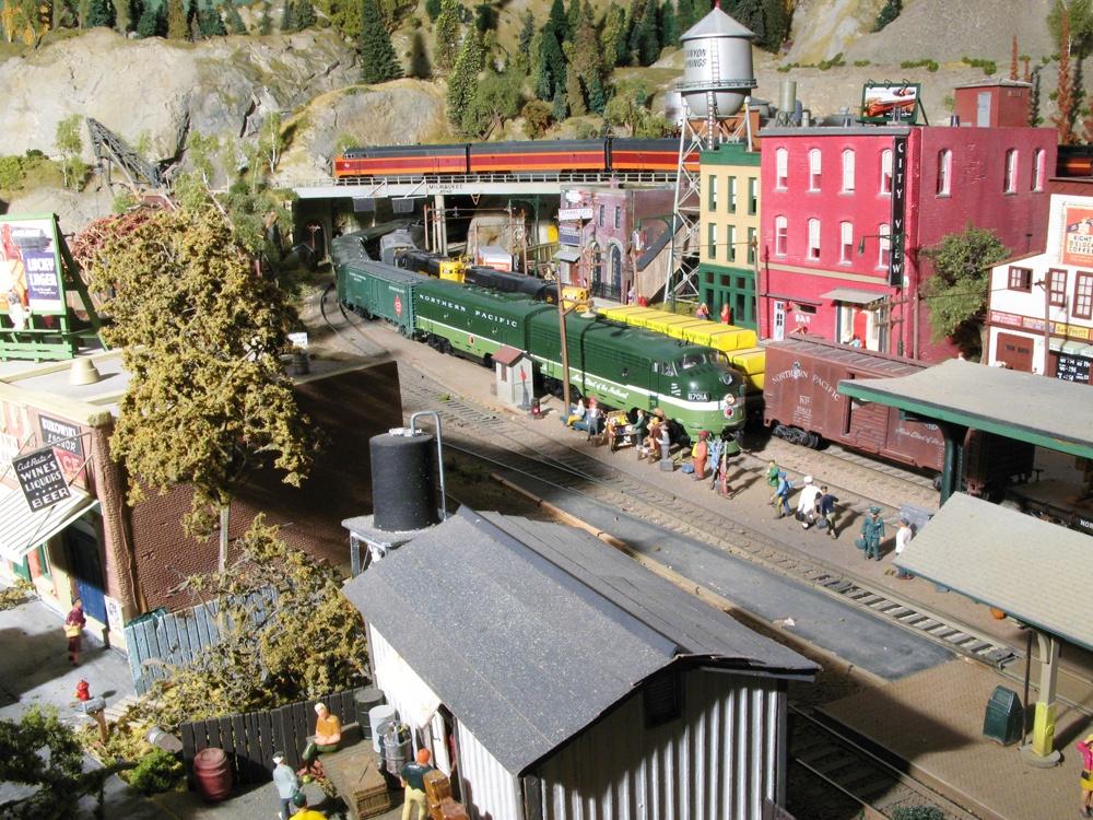

Some internet photos of the HO scale layout.
