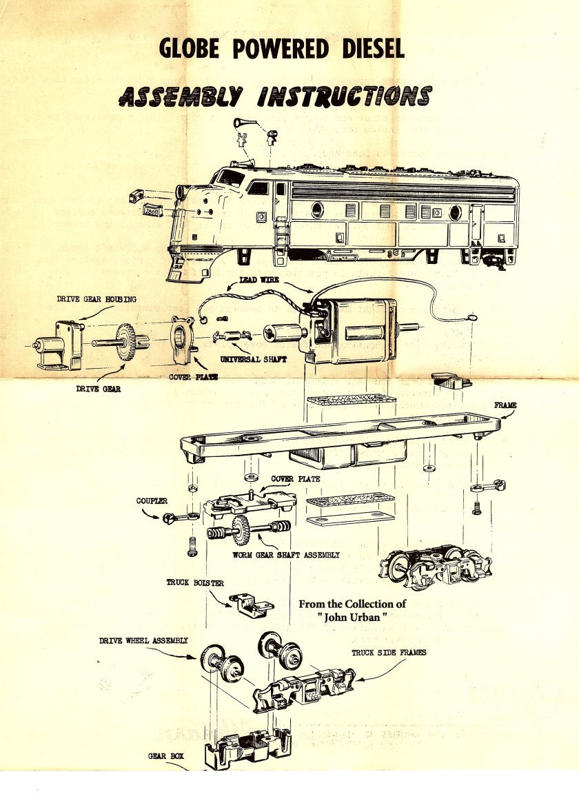

It's this mechanism, but with a powered truck on the backside also, if anyone is wondering (from HOseeker).

It sounds like one truck only picks up from the left rail and the other only picks up from the right. That wouldn't give you much electrical contact when the wheels of one truck are on the insulated frog. The diagram appears to show the wire from one truck going to one brush of the motor and the wire from the other truck going to the other brush. If that's so, it would seem to reaffirm that assumption.
If that's the case, and the insulated wheels are metal, not plastic, it may be possible to add pickup wipers to the insulated wheels for all-wheel pickup.
