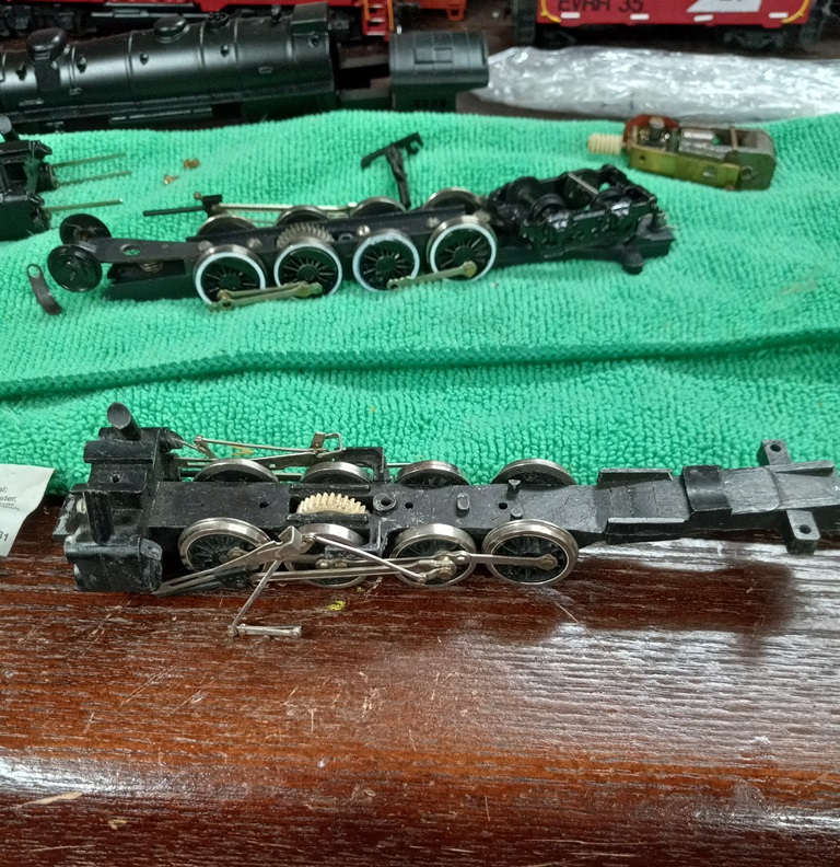

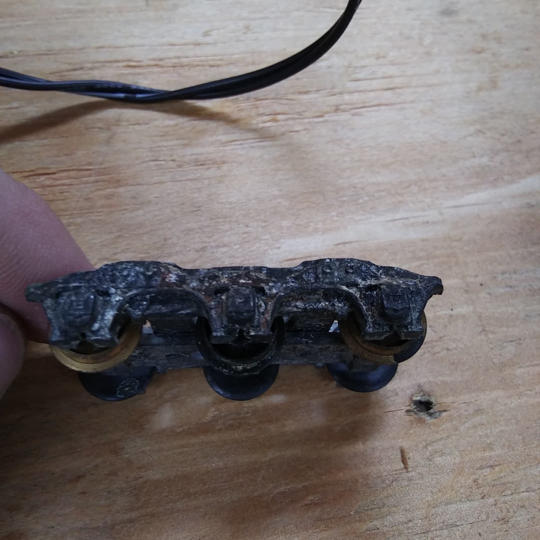

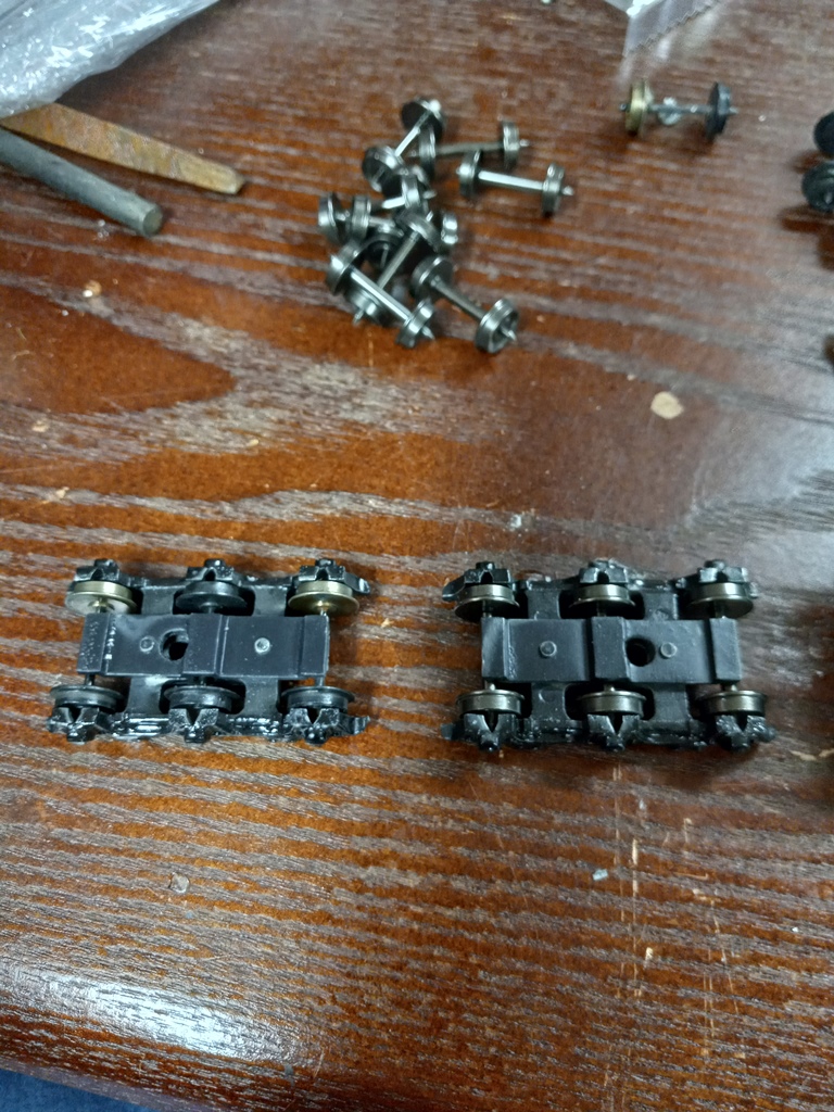

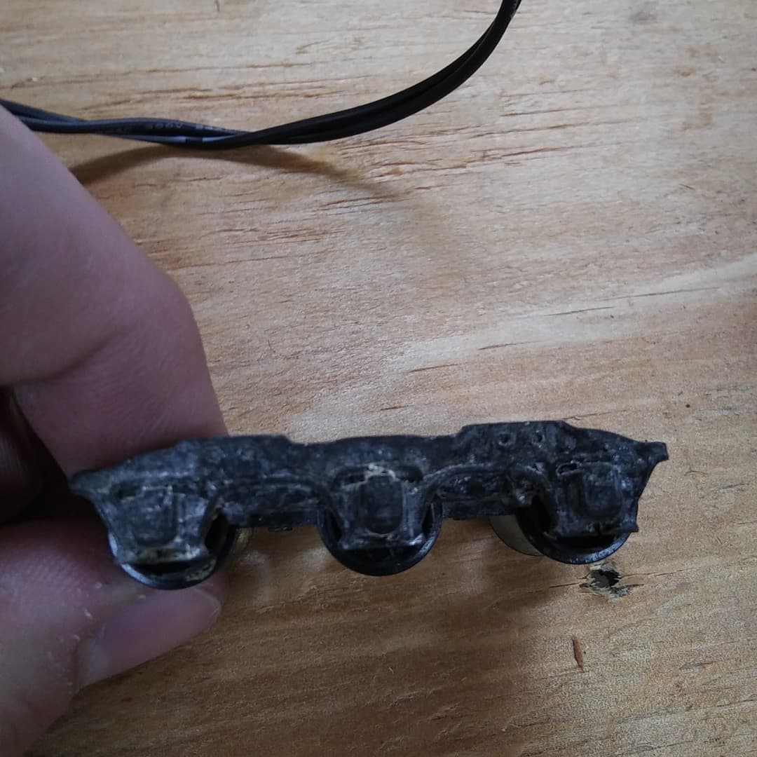

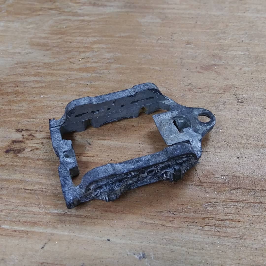

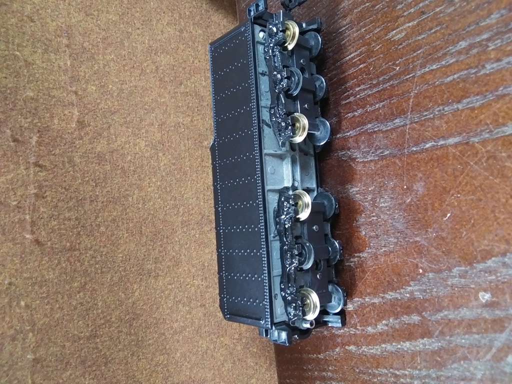

Progress has been made on removing corrosion on some of the parts - the tender trucks and locomotive trailing truck specifically. My dremel with a wire wheel worked wonders. Thanks to the tender trucks coming apart, I'll be able to spray-paint these parts, gloss black, as opposed to brush-painting as usual. Obviously, I'll take care to avoid spray-painting all areas on the trucks that need to be clean, for electrical contact.

 Posted - August 10 2021 :  2:16:54 PM Link directly to this reply  Show Profile  Add scsshaggy to Buddylist
Those cleaned up pretty nicely. With a coat of paint protecting them, they'll be good to last the ages.
 Posted - August 10 2021 :  6:52:08 PM Link directly to this reply  Show Profile  Add Chops124 to Buddylist
Is that zinc rot?
 Posted - August 10 2021 :  7:00:01 PM Link directly to this reply  Show Profile  Add gmoney to Buddylist
Oh let’s hope not!
 Posted - August 10 2021 :  9:18:58 PM Link directly to this reply  Show Profile  Add RP model railroads to Buddylist
Thanks guys!! Yes, the dremel w. wire wheel did an awesome job cleaning up those corroded pieces. I'll be adding an extra layer of spray-paint primer before spraying them Krylon gloss black.
I don't think so, as zinc pest typically causes metal to get brittle, and there is no sign of brittle metal, rather just surface corrosion, on the pieces I've cleaned so far.

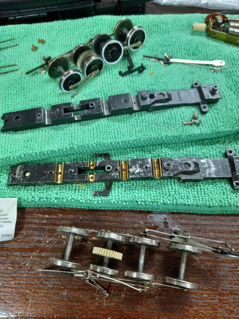

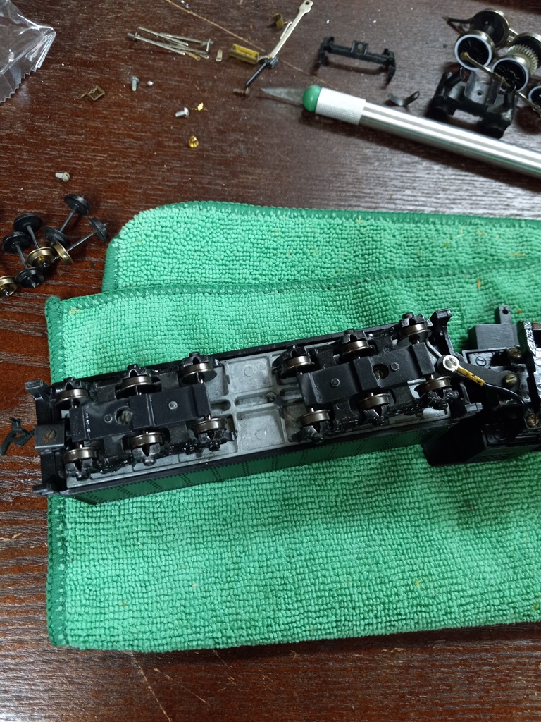

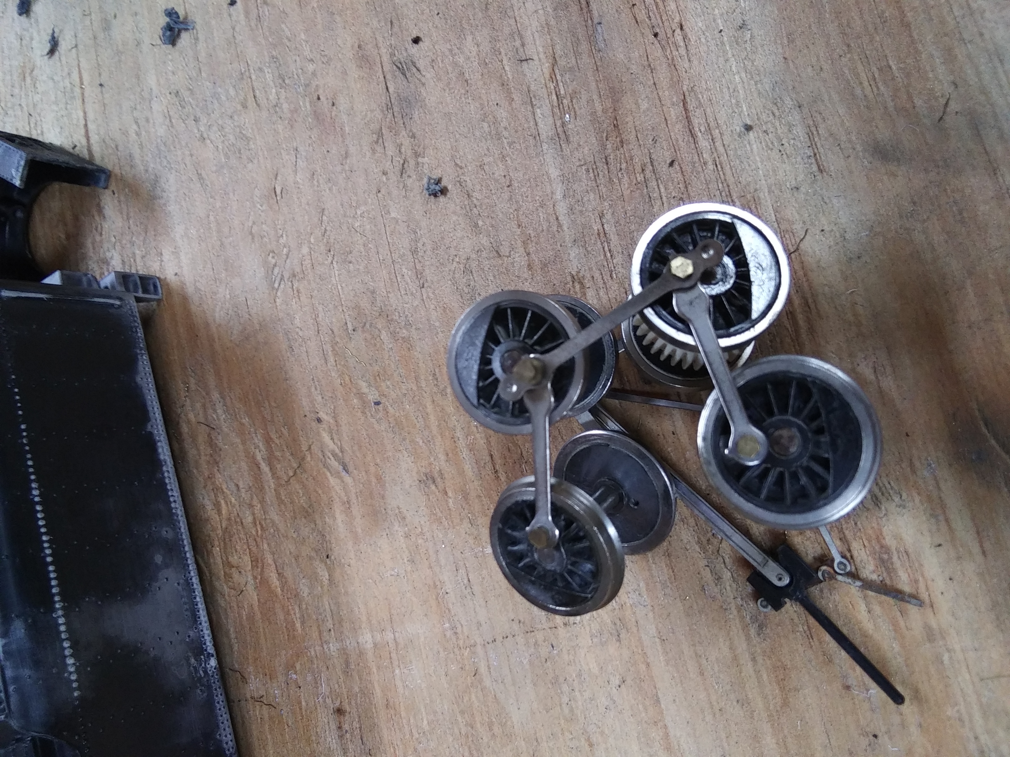

More progress has been made, and now pretty much all of the corroded metal parts have been wire-wheeled. Today's work included the cylinders, bottom plate, frame, and brass contact pieces. I also started with removing some of the corrosion from the drivers.

Indeed, microbusss - my $10 Harbor Freight dremel was one of the best tools I've ever bought, and is a lifesaver when it comes to cleaning model train contact wheels.
This is the first time I've ever attempted to completely tear down a Mantua steam locomotive, to clean each and every part of corroded metal....so it is a learning experience. The rods, having to rebuild the valve gear on the one side and start from scratch on the other, does have me concerned. But, I've got a great friend who has given me tons of advice when it comes to working on Mantua steam locomotives, so where there's a will, there's a way.

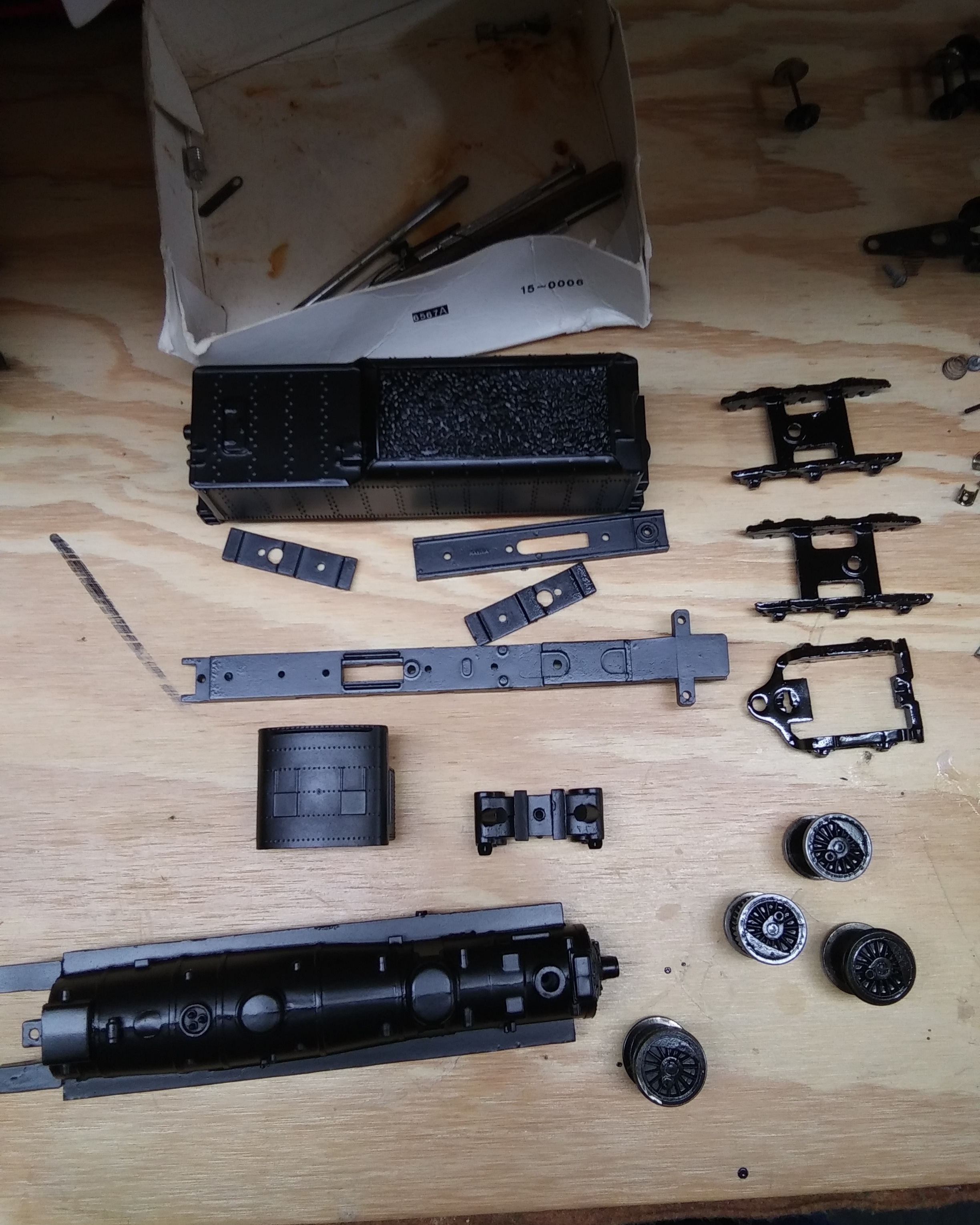

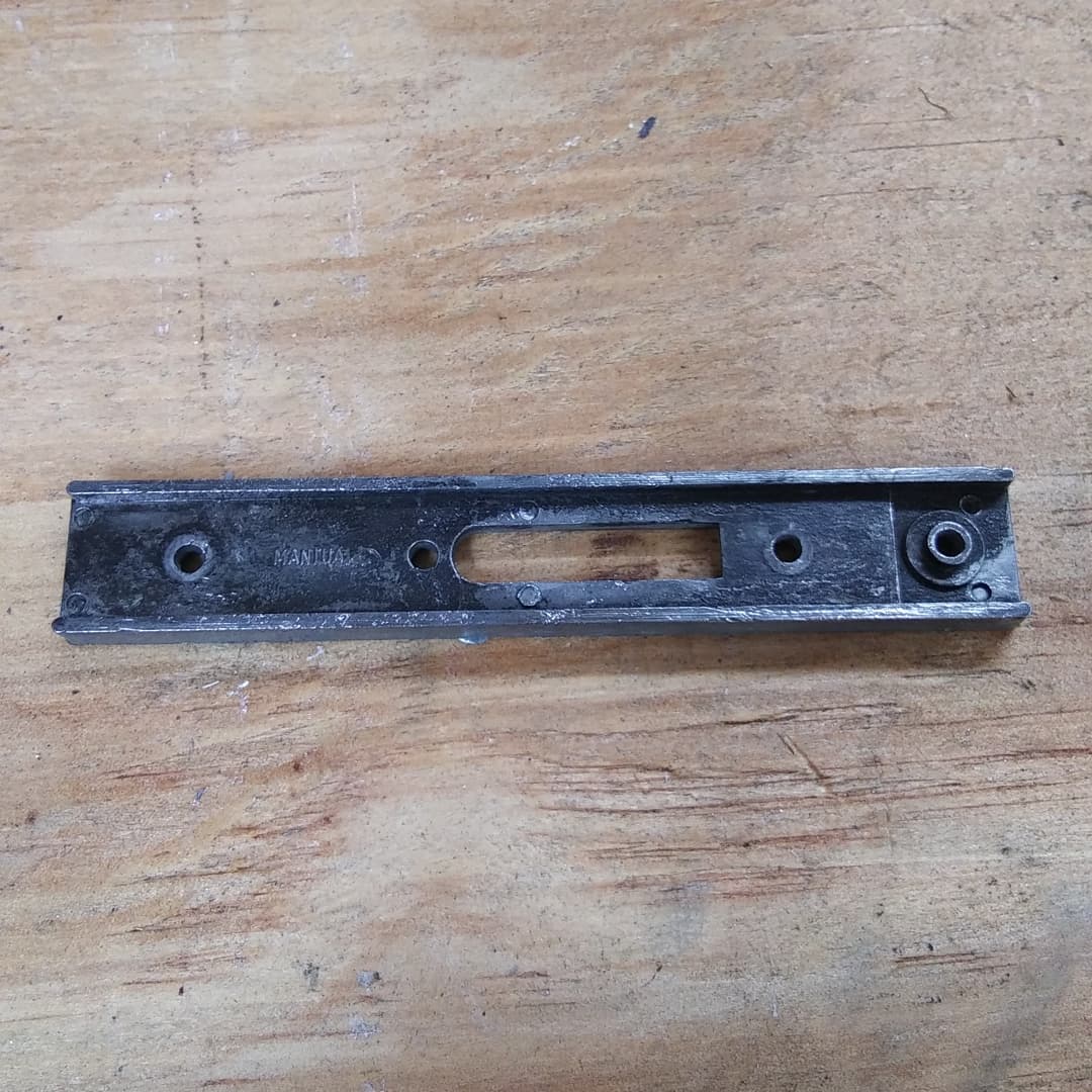

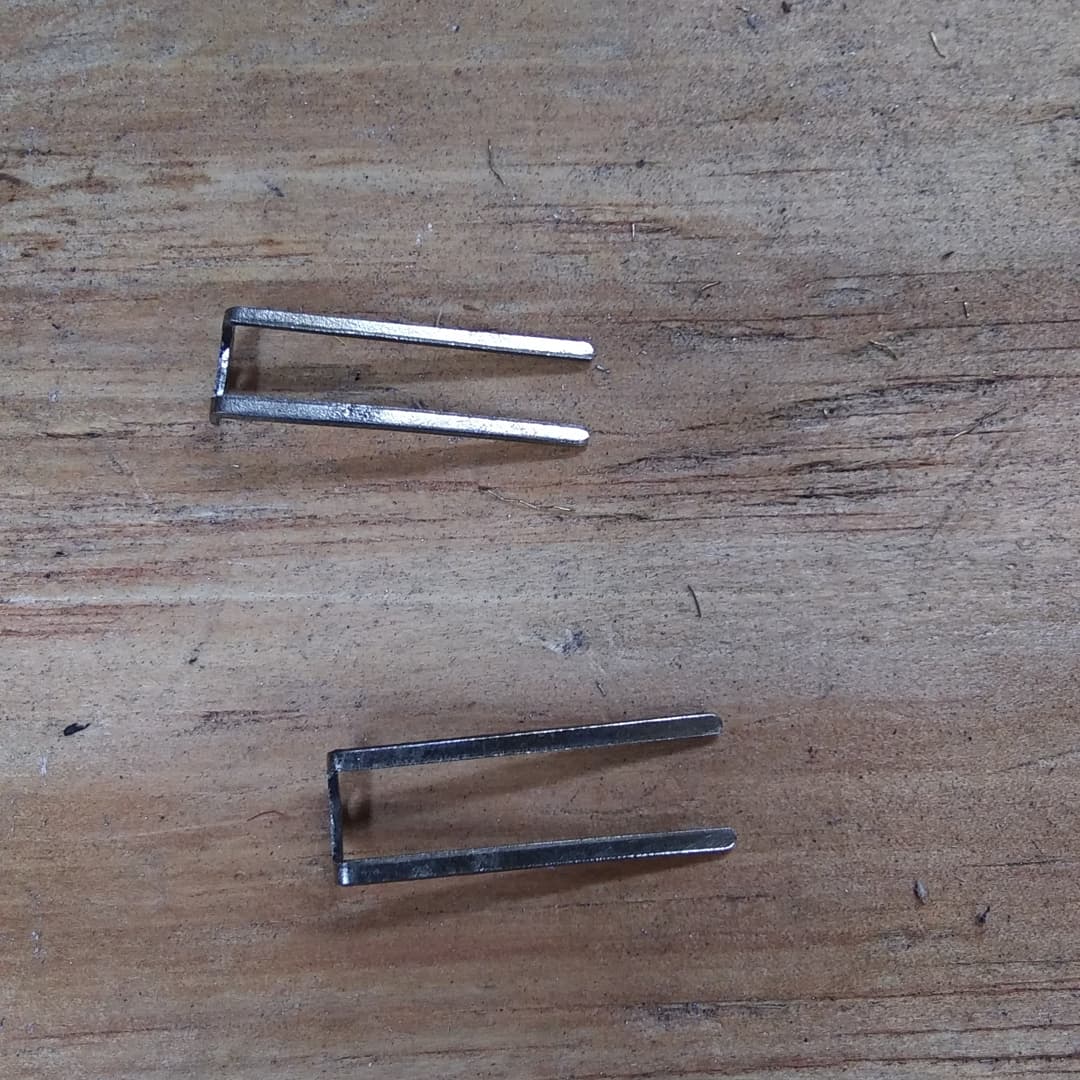

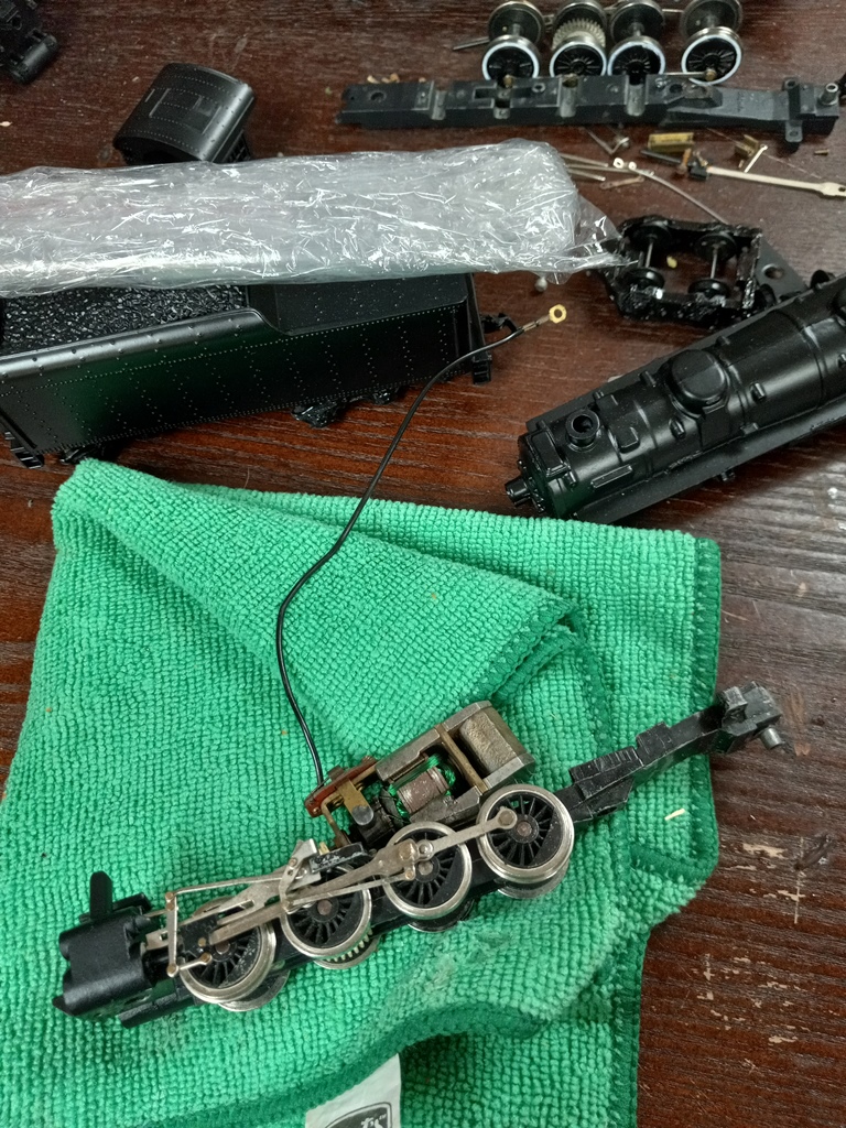

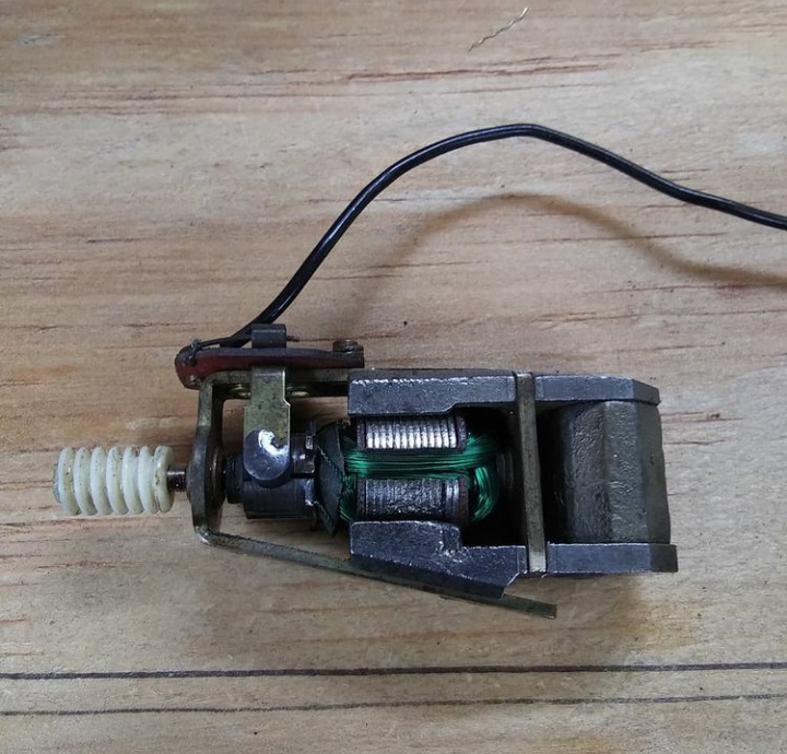

After testing the Mantua open-frame motor, I removed all of the surface rust, and took off 1 brush setup, to access and clean the commutator. A drop or 2 of oil around the motor bearings, and the Berkshire motor runs good as new!

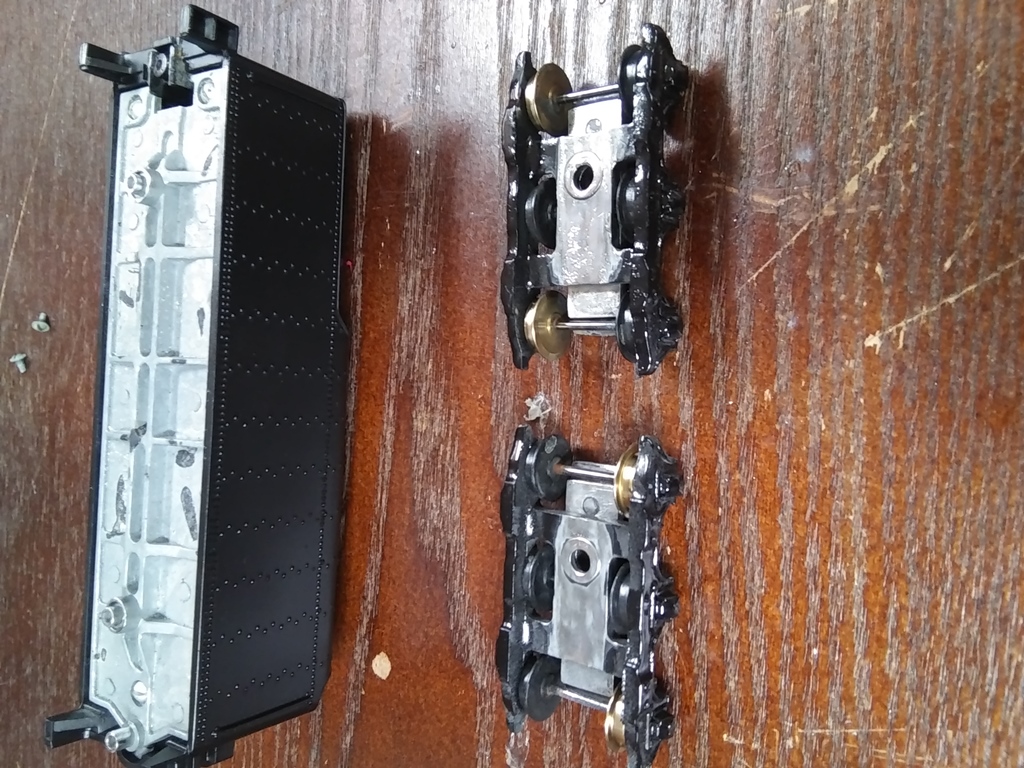

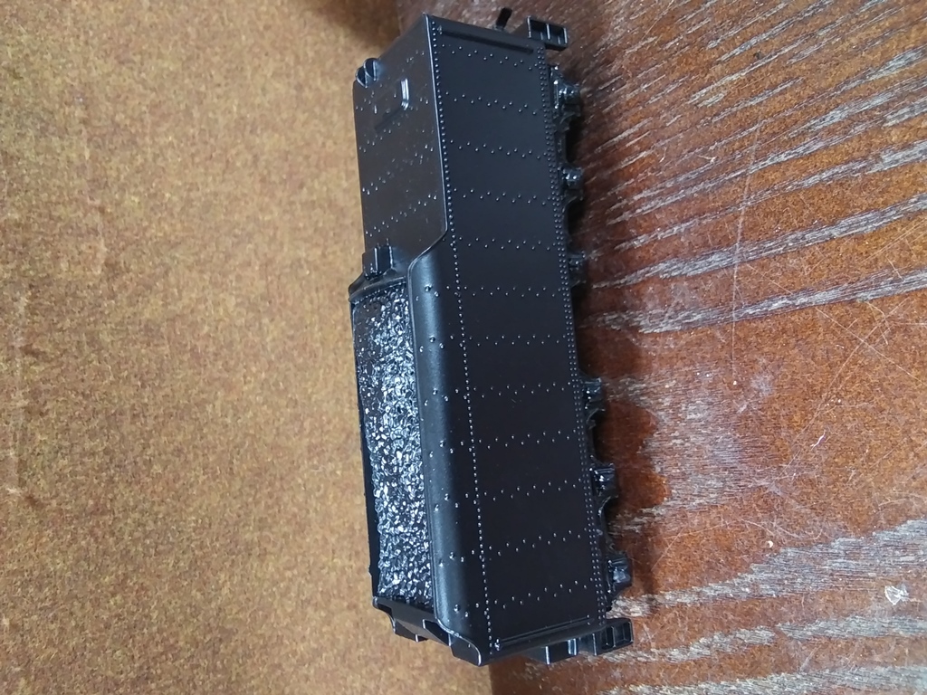

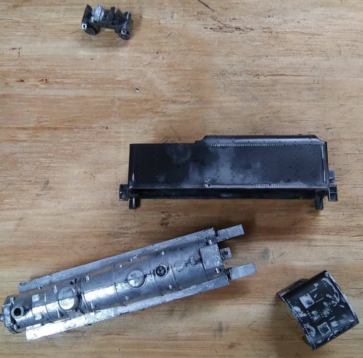

I stripped the diecast boiler, cab, and tender shell in dot3 brake fluid - the boiler soaked for 48 hours, while the plastic parts only 1 night. However, not all of the cardboard residue on the plastic came off - guess I'll have to use GooGone on those areas, and then thoroughly wash the tender shell and cab before spray-painting.
After taking too long of a break, I returned to the Berkshire restoration today - removing the rest of the corrosion from the driver wheels. Unfortunately, the corrosion removal also took off some of the black paint on the drivers, so I dissassembled what was left of the rod assembly, to prepare the drivers for spray-paint - which will be tedious.
 Posted - November 09 2021 :  2:33:37 PM Link directly to this reply  Show Profile  Add RP model railroads to Buddylist
Yesterday, I spray-painted ALL of the Berkshire components, which is great, because I look forward to putting this locomotive together sooner rather than later.

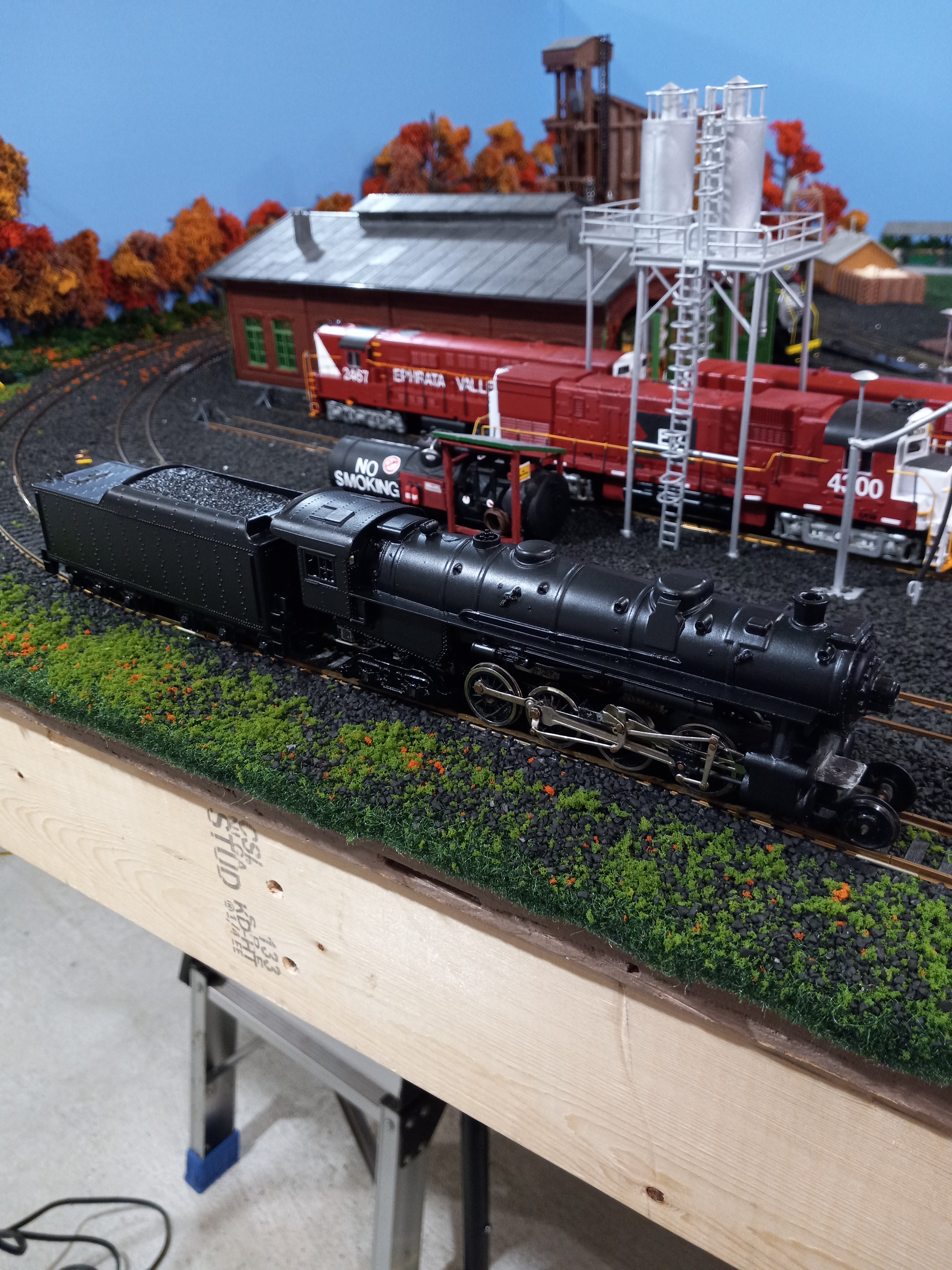

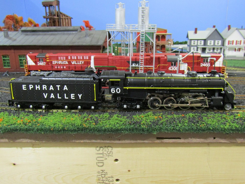

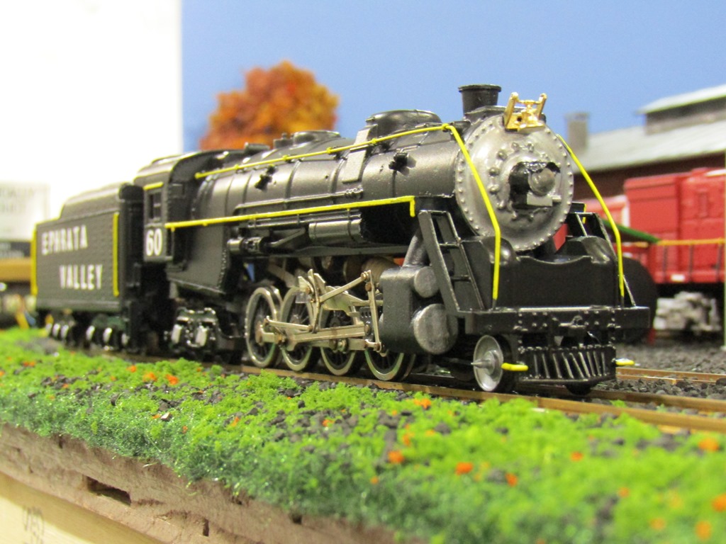

My Mantua Berkshire is....finally DONE!!!!! Introducing Ephrata Valley RR 2-8-4 steam engine #60. I couldn't be prouder considering the state this locomotive came from, and all the work I put into this project. There are still some small things I need to do (headlight bulb isn't working even though all wires are attached, and valve gear rods on the right side need some attention,) but otherwise, the Berkshire is complete
