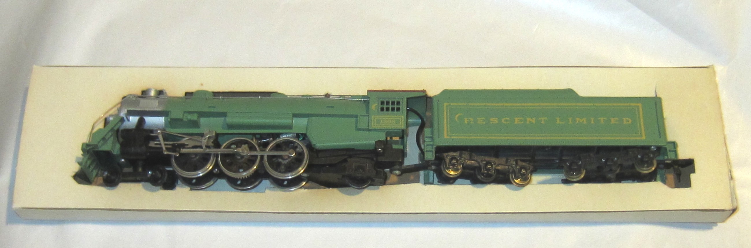

 Posted - January 17 2021 :  09:43:09 AM Link directly to this reply  Show Profile  Add captainsimos to Buddylist
Finally figured out how to add a photo, hope this helps with the ID
George Andis
 Country: USA  ~  Posts: 3  ~  Member Since: January 15 2021  ~  Last Visit: January 19 2021 Alert Moderator  Go To Top Of Page
RealBnsfIA
BNSFAvatar
 Posted - January 18 2021 :  01:09:33 AM Link directly to this reply  Show Profile  Add RealBnsfIA to Buddylist
Yep, that would be the second version (with the green pilot)
