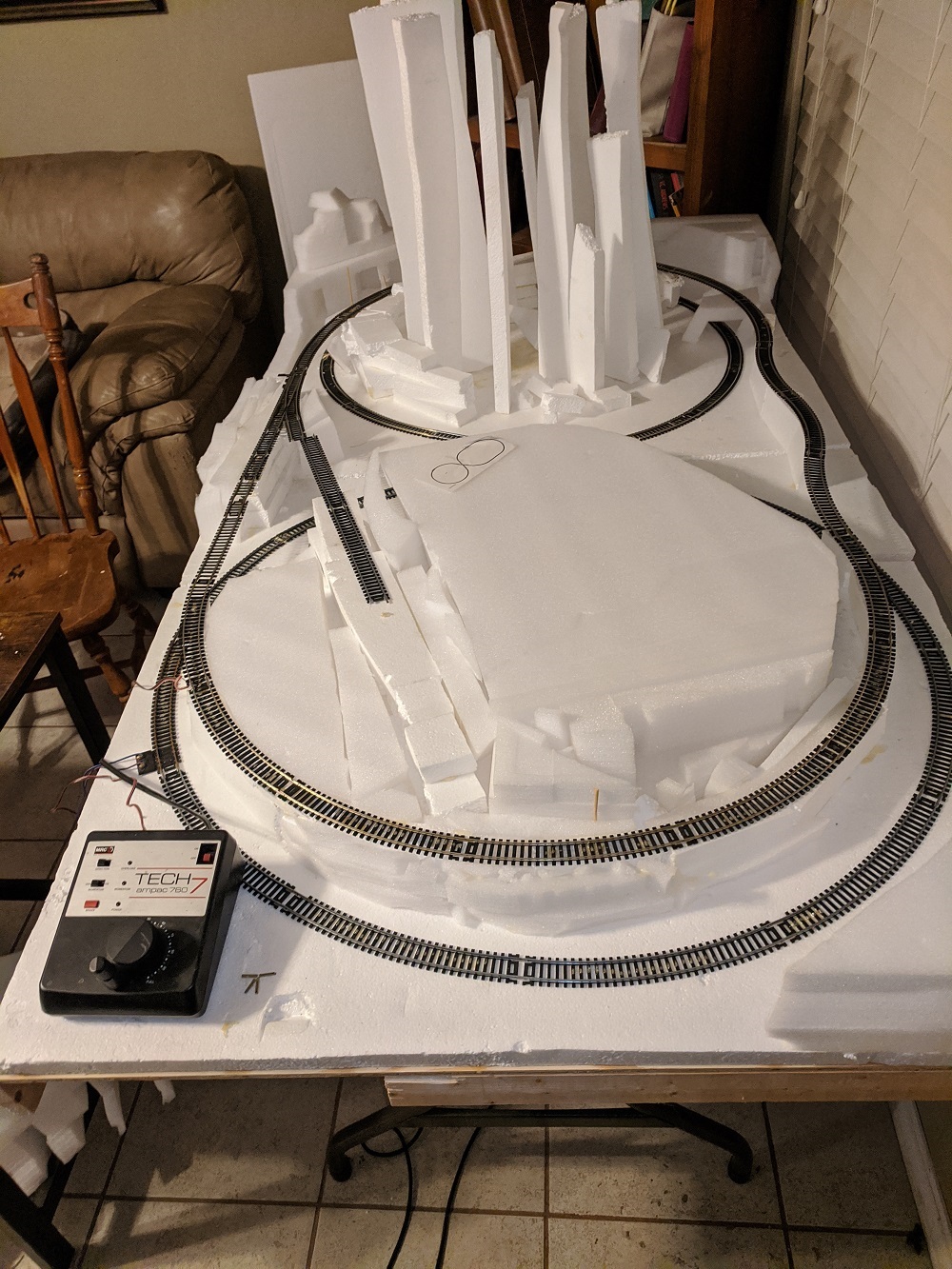

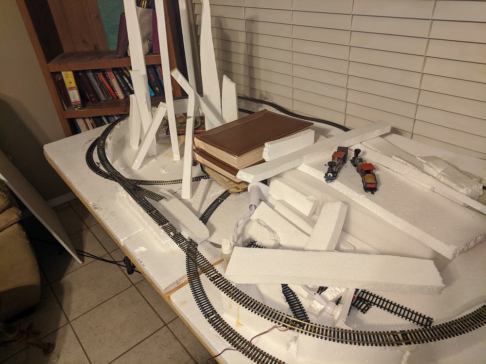

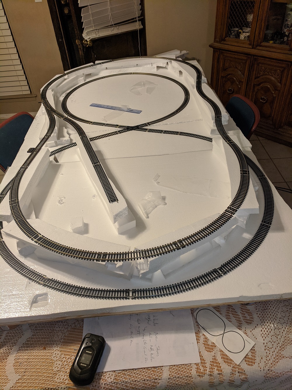

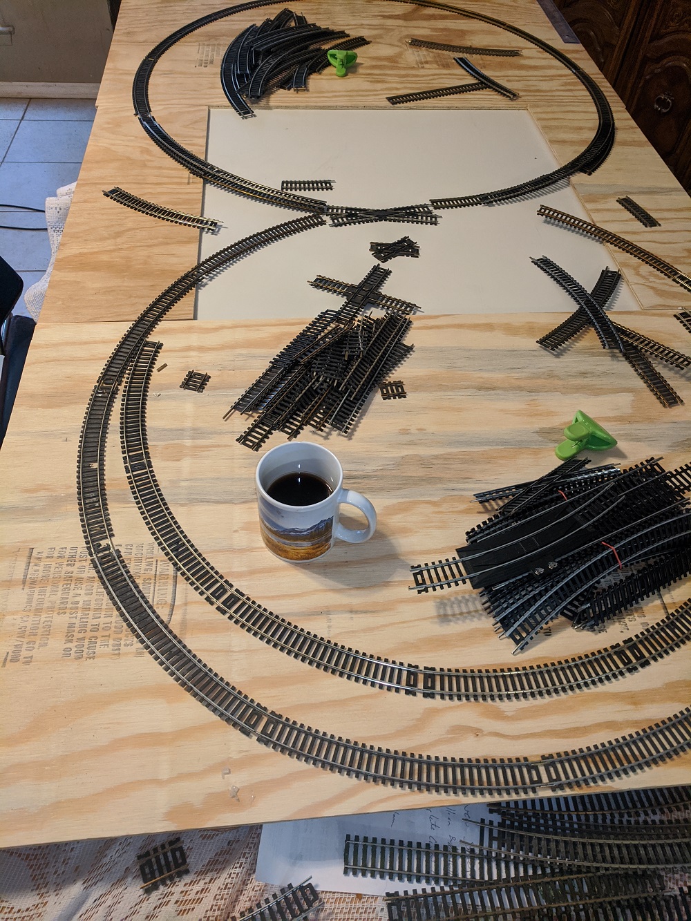

Laying out the dimensions with track, quickly found there is no such
thing, at least easily available as 40 inch wide hollow core, so using
left over piece with two sides of plywood to span the desired area,
finding that Shaggy is right, the up and over elevation may be to
extreme. Daily Savings has me more tired than usual, so going to
bed early and take a run at this tomorrow.

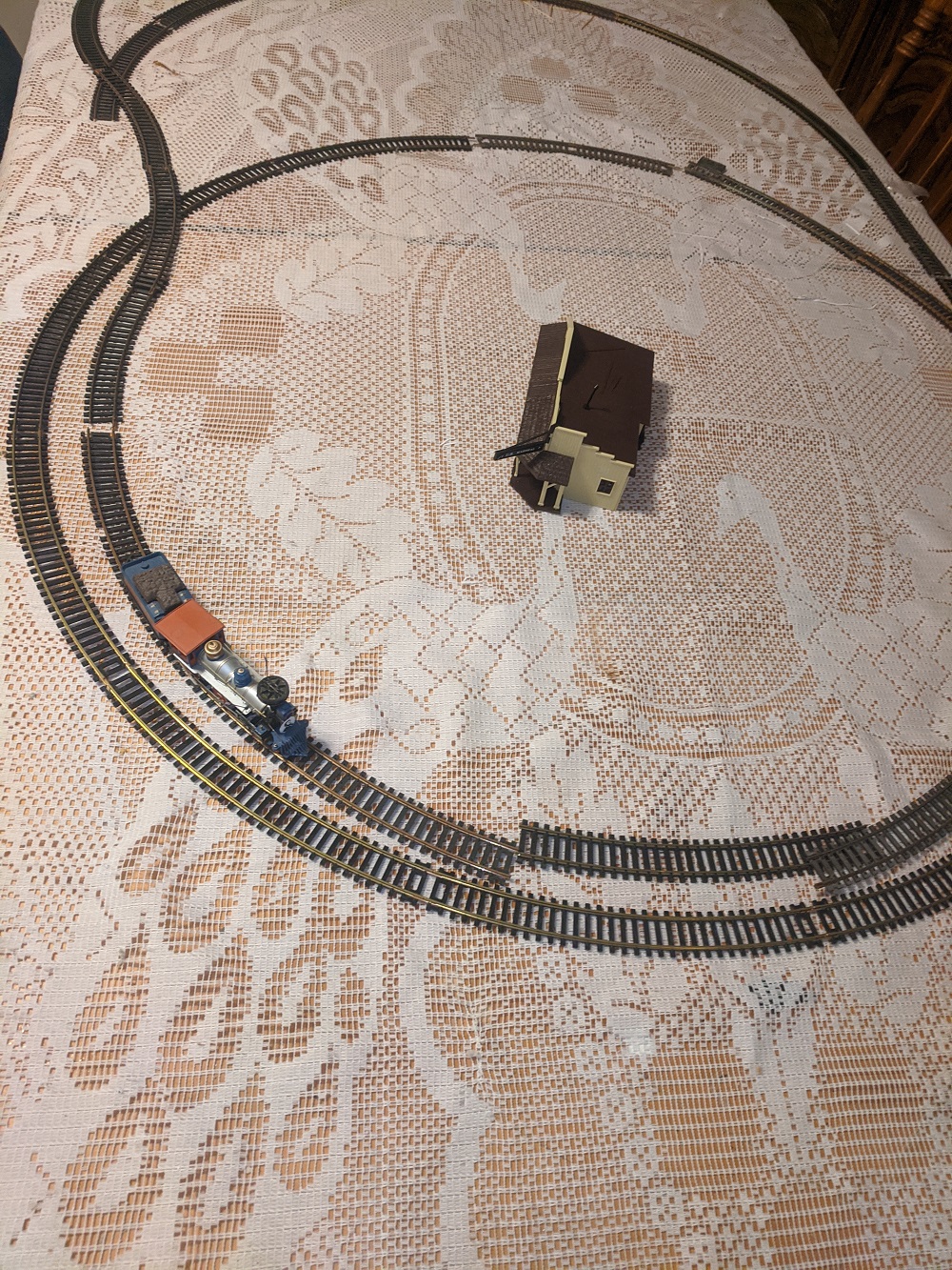

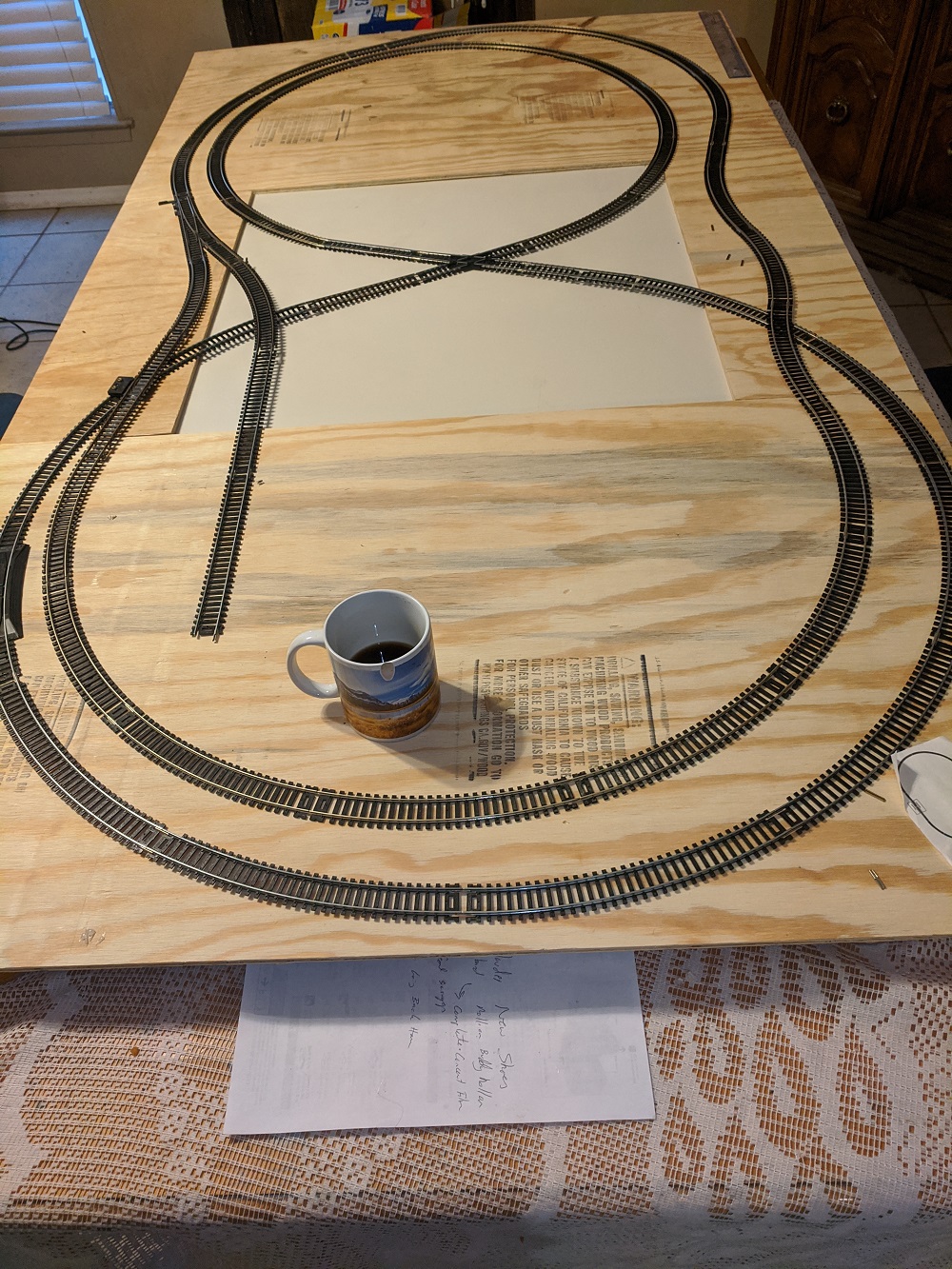

 Posted - November 29 2020 :  7:11:02 PM Link directly to this reply  Show Profile  Add Chops124 to Buddylist
Not much of a computer guy. Computers sometimes seem to do whatever they want when they want and
all I can do is stare. So, no SCARM here. Put in about six hours of setting and resetting the track. The up
and over method was too jenky, and I am not too fond of giving my Pola, and Bachmanns any extra work
struggling up a grade, so the lower deck is half 18 inch, half 15 inch to fit into a 33 by 69 inch rectangle.
Originally, I hoped to fit it all in a 30 inch by 48 inch rectangle, but without resorting to flex track, and
bending the life out of it, this wasn't going to work. Plus, from experience I've learned that below 15 inches
of radius, one is really tempting the derailment gods, although I have managed to barely wring a Bachmann
PCC through nine inches of curve, but very little else. Even the Bachmann Cable Car won't suffer a nine
inch curve, nor a 4 wheel AHM trolley. I do know from the prior Hartes Mill I layout an American Type will
squeal through, but any defects in track will throw it up in a second.
Initally the plan was to use a 36 by 48 inch section of hollow core door, sturdy and nice and light. Very
good for a complete N scale layout. Wanting to make it fit in the back of my Accent, whenever this Chinese Plague dampens down, to a train show, it will still foot. But, a door is like $76, and I could find none at a
lumber salvage yard. So, I took the remaining piece of door on hand and slabbed two pieces of spare
plywood upon it to create a table. The center is depressed, but will be covered by a sheet of cheap foam
insulation. With the left over insulation I will be utilizing Eric the Train Fan's wedding cake layer to create
a wholly seperate circuit that will pass over the lower figure 8. Two train operation without danger of
collission. A little stub spur was thrown down to see what it might do, on the upper tier.
After rearranging 15 and 18 inch radii half the night, and half the day, I remembered that this crazy
Mehano set I'd bought a while back came with not only a complete set of figure track, but also a track plan
to go with it. I pulled that off the shelf, and using the track plan as a guide got down to laying down
sectional pieces to creat an 18 inch radius figure 8 for the lower tier. Low and behold, even working off
a factory track plan, the second loop of the figure 8 was about a full nine inches wider than the first loop, which
fit nicely.
So, that being the case, the second loop was built using fifteen inch radii, and the upper loop with almost all
15 inch radii to fit on the inside of the 18 inch radius. Finally it all lined up, but I had to extend out the
"straight" sections of baseboard to make it all fit.
The plywood sections will be screwed to the hollow core foundation. The entire affair can be set up on any small
table. It will require two power packs. Fine, at least I got what I wanted.
Hopefully, tonight, I won't be so tired as to not fire up the DCC Jupiter for a test run.
With regards to scenery, my first thought was to go out and grab some El Paso dirt, but then realized I've already done three El Paso themed layouts, and I'd really like to try my hand at some of that Denver scenery.
I love Denver West, and go there whenever the chance turns up. Fourteen hours by automobile, some of it through the wastelands of New Mexico, where ramming an elk is a real possibility, then through the plains of Southern Colorado. To get there by train, I'd have to take Amtrak from El Paso, to Dallas, then to Chicago, and then back south to Denver. Three days. Which I wouldn't mind at all, if I had that much free time, which I rarely do, except when between jobs, when I have no money. So, I fly and I'm there in 90 minutes. Then take the excellent light rail into Golden, where it really starts to get scenic (apologies to Red Rocks, which is fab).
So, I am going to eventually work up some dramatic Golden, CO scenery towering over the tracks, and have the upper deck train cling to a cliffside like the most gorgeous Durango & Silverton line above the Animas river. One, or both, as both areas have differences in geology.
Then, if I get bored of running 1880 stuff, I can swap in some standard gauge Shay or two. The structures of Gold Rush Colorado didn't change much from 1880 to 1920. I figure around six months to a year of on again, off again work until it is show ready.
So, here is a photo of what I hope to be the final track plan, in all its squigglatude. Trains, particularly short ones, like what I will be running, look most interesting as they weave in and around geologic obstructions, a
frequent fact of railroading in old Colorado.
(If you've never made it out to CO, add it to your to-do list. It is breathtaking in its beauty, and no wonder why it was the favorite of Model Railroader articles for years and years).

OK, put in some initial foam runners for the upper level. The Jupiter is 2 inches from rail head to
top of stack, the runners bring it in at 3 inches. The left overpass will be a tunnel, the right gap
a trestle bridge, but will probably extend the length along the sinuous curvature.
Scrap packing Styrofoam will be used to build up skeleton of the butte and the mesa that will dominate
the center area. Using a heated kitchen knife to slice off sections of the runners to make them fit
better.
I've done a couple scratch timber trestles before, one quite large, and they are surprisingly easy to build.
All that is required is making a couple of jigs out of balsa and they can be punched out like cup cakes. Trimming
to fit is pretty easy. In the past I'd glue the top of the trestle to the bottom ties, and build the plaster scenery
cloth up to the level of the base, as needed. Then set the stringers and was down with a stain. Probably use a razor pen to add black dots for bolt heads.
To dominate the trains, the height of the mesa and the butte are going to have to be about two feet, top to
bottom, at minimum. Eric the Train Fan used, I think, built up stratum of ceiling tile to create a good rough
cliff face. I've done that before, but I need to keep the weight down as this unit is going to have to be portable, so I'm probably going to be doing some plaster casts, which will be probably as heavy, unless I minimize the
cliff faces? Beginning to wonder now. The butte will require some vertical level of striation, as well, the mesa,
the sides can be more crumbly. Again, weight is going to be an issue.
Any suggestions for modifications and/or geological features???
Whole house stinks of roasted Styrofoam now. Blech.
Edited by - Chops124 on November 30 2020 12:54:23 AM

 Posted - December 14 2020 :  12:19:29 AM Link directly to this reply  Show Profile  Add Chops124 to Buddylist
Work has been slow, but a little progress on Mormon's Gulch, thus far. Finished up the baseboard
which is made up of 1/2 inch plywood sections affixed to 2x1's for a little rigidity, with a foam
overlay. The second tier is made up strips of Styrofoam to support the upper level. The essential
concept is plagiarized from Eric the Train Fan. There will be one stub spur on the upper level,
I didn't want to complicate it with a bunch of interchanges and grades that invite derailments.
There's going to be at least one decent tunnel on the right, and two timber trestles and one
steep gorge, at least. Some modelers go to great lengths to plan stuff out. I'm no fan of planning.
Every plan I ever made ends up in a heap, so I like to tweak and fiddle as I go.
Edited by - Chops124 on December 14 2020 12:20:29 AM

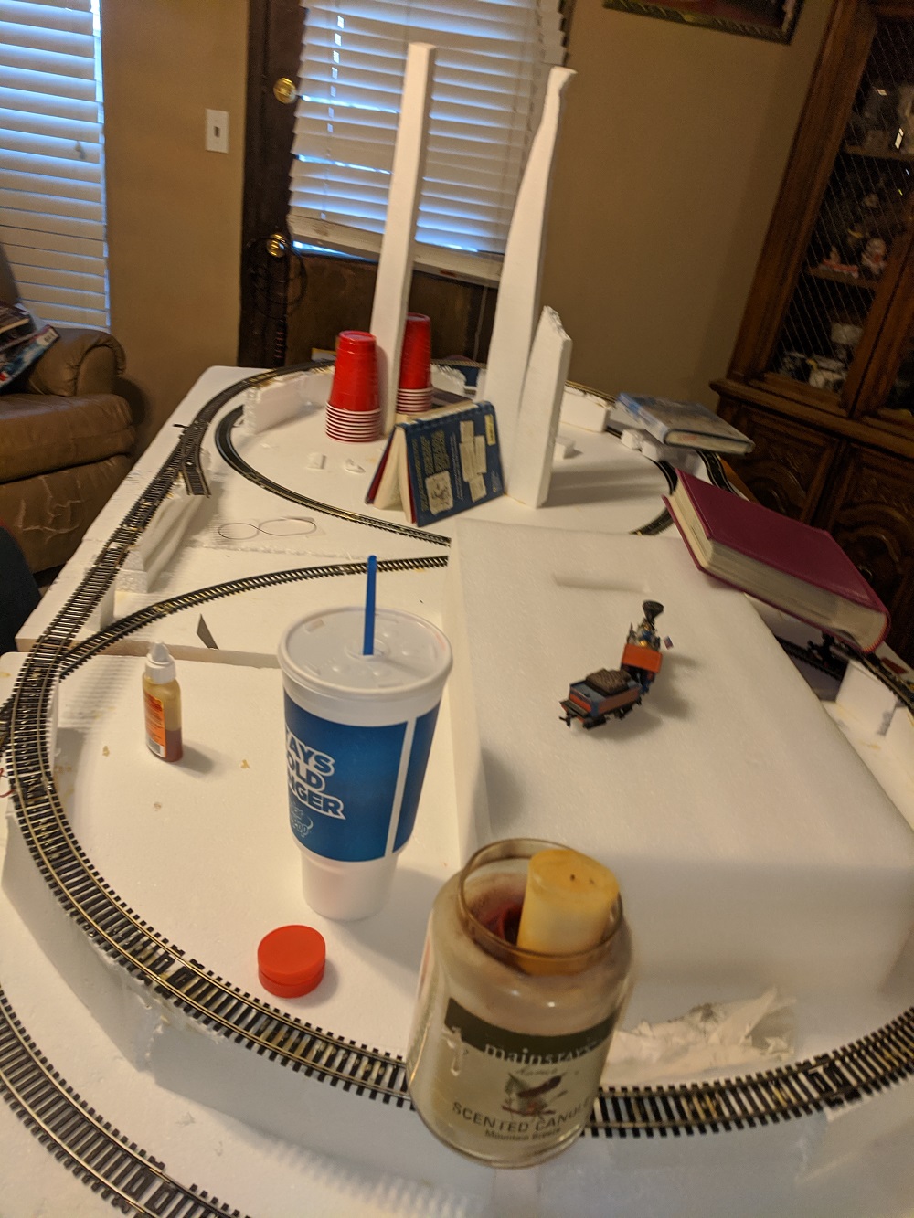

 Posted - December 19 2020 :  5:56:04 PM Link directly to this reply  Show Profile  Add Bamos to Buddylist
Nice Chops I like to keep thing pretty simple too no grades on my layout. Not to be nit picky but is that a
slight kink in the track where the orange cap is by the scented candle I am seeing?
One of the techniques i use is to take pictures of all my track work after laying, the camera finds everything I
may have slightly out of alignment
Bill
 Posted - December 20 2020 :  8:42:03 PM Link directly to this reply  Show Profile  Add Chops124 to Buddylist
A very good point, and yes, I've had to go back and relay
some of the track after seeing photos of it.
 Posted - December 27 2020 :  12:37:06 AM Link directly to this reply  Show Profile  Add Chops124 to Buddylist
Having relaid some the track, and added a thin plywood cross member to glue down the center
Styrofoam, both locomotives track well. Assembled more of the butte, which is a bit like arranging
a house of cards. The Gorilla Glue is very slow to set, but doesn't dissolve the foam. I might go
back in there and break some bamboo skewers in half to better stabilize them.

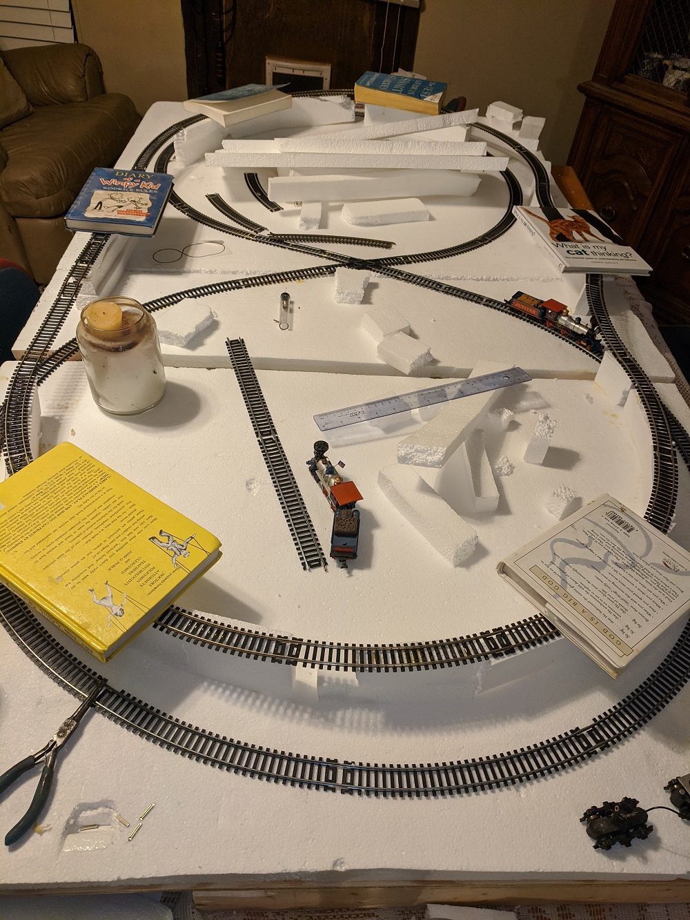

 Posted - December 29 2020 :  02:44:12 AM Link directly to this reply  Show Profile  Add Chops124 to Buddylist
Mormon's Gulch. The foam insert that came from my daughter's new computer desk
is amazingly easy to carve, and unlike Styrofoam, doesn't require a hot blade nor
leave a bunch of foam pebbles to deal with. And there is a ton of it. The butte, the
canyons, and the mesa are taking shape. Foam tack glue and bamboo skewers hold
things in place while drying.
Over this I'll likely use wetted down newspaper to round out the sharp edges, and over
that, if all goes well, plaster cloth. If newspaper doesn't hold enough rounded shape,
I will try brown paper.
