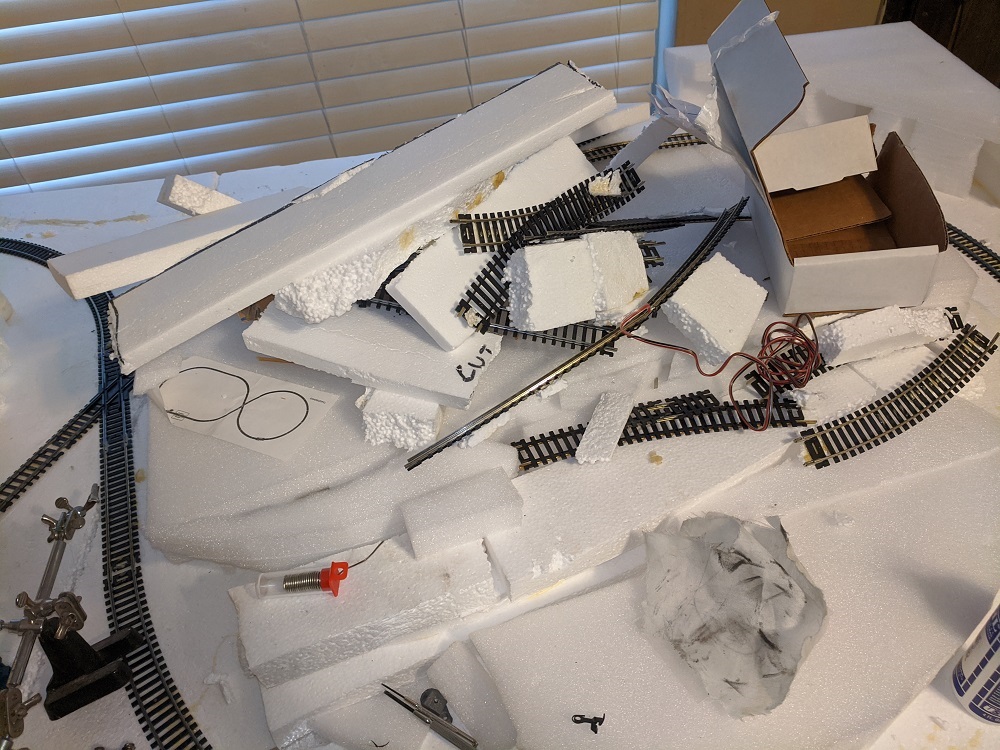

One step forward, two steps back. First, had to strip off the upper layer of track. I was hasty and the uneven
sub-base would not allow a train to remain on the rails. Very hard to trim the Styrofoam packing, which was
free, to the correct depth, and the fumes were nasty. While standing in the Post Office, I spied these
poster mailers. The measure out at three inches by three inches, the exact height I need for the crossing
over the lower rails.

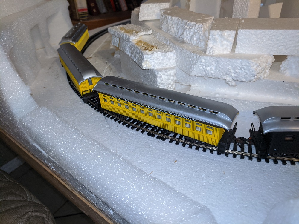

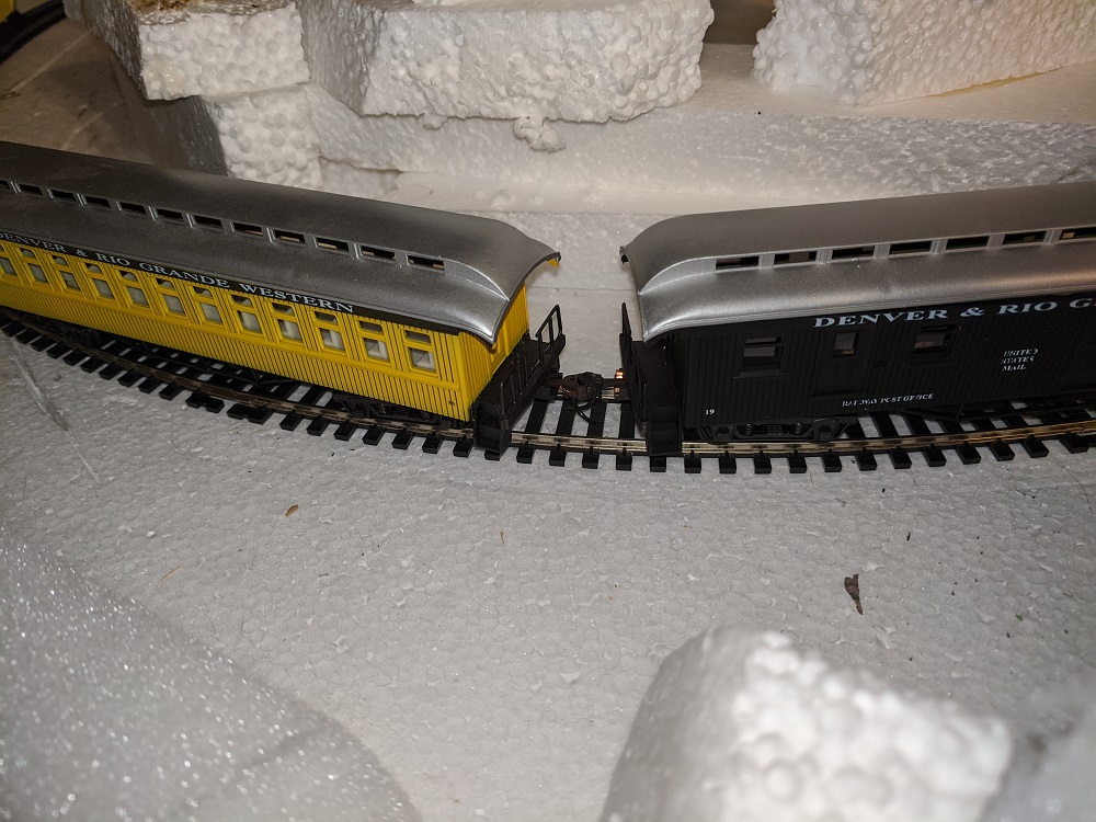

Next issue were these AHM coaches, that would not track for a nickel. I tried weighting them down, and
they still derailed, and little American could barely pull two of them. Thought maybe metal wheels would
help, then realized the wheels were already metal. Upon careful examination, the problem was the horn hooks
that were stiff and created a bad lateral stress that pulled them off the rails at every corner. Usually, I steer
clear of Kadees, but I had some extras in the junk box, and they allow an easy lateral transfer through the curves and no more derailments, and no additional weight is needed.

I was surprised, usually horn hooks don't give me much trouble, but
the 18 inch curves, they hung up badly. Kadees bailed me out, now
the cars run perfectly, without any issue. It took a bit of study before
I recognized the issue. Glad I didn't shell out a bunch of money for
metal wheels. And luckily, the Kadees just slotted right in, which was
an unexpected bonus.

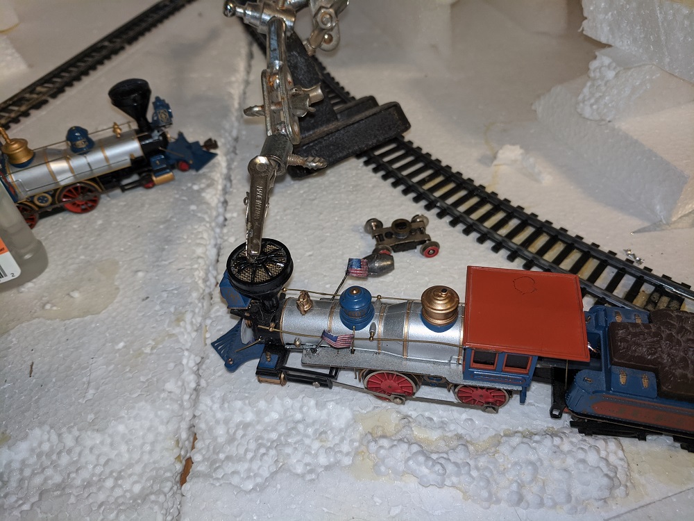

I tried to open up this Bachmann Jupe, and as typically happens with these
Bachmanns, I soon ended up with a bunch of parts. Here I am gluing the
stack back on. I was trying to see if the boiler had any space at all for a
little more weight (it does not, not a millimeter). Fortunately, I was able to
get it all back together and working again.
The pickups on the old tooling Americans are flimsy and weak, so a periodic
cleaning of contact surfaces makes it run markedly better.

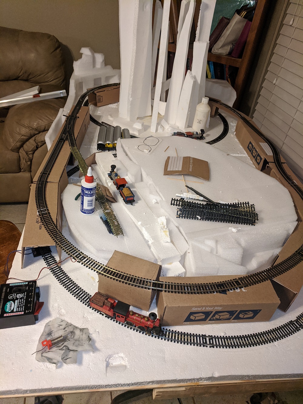

I am shifting back and forth between the subway and Mormon's Gulch, as the glue dries on
one, I work on the other.
