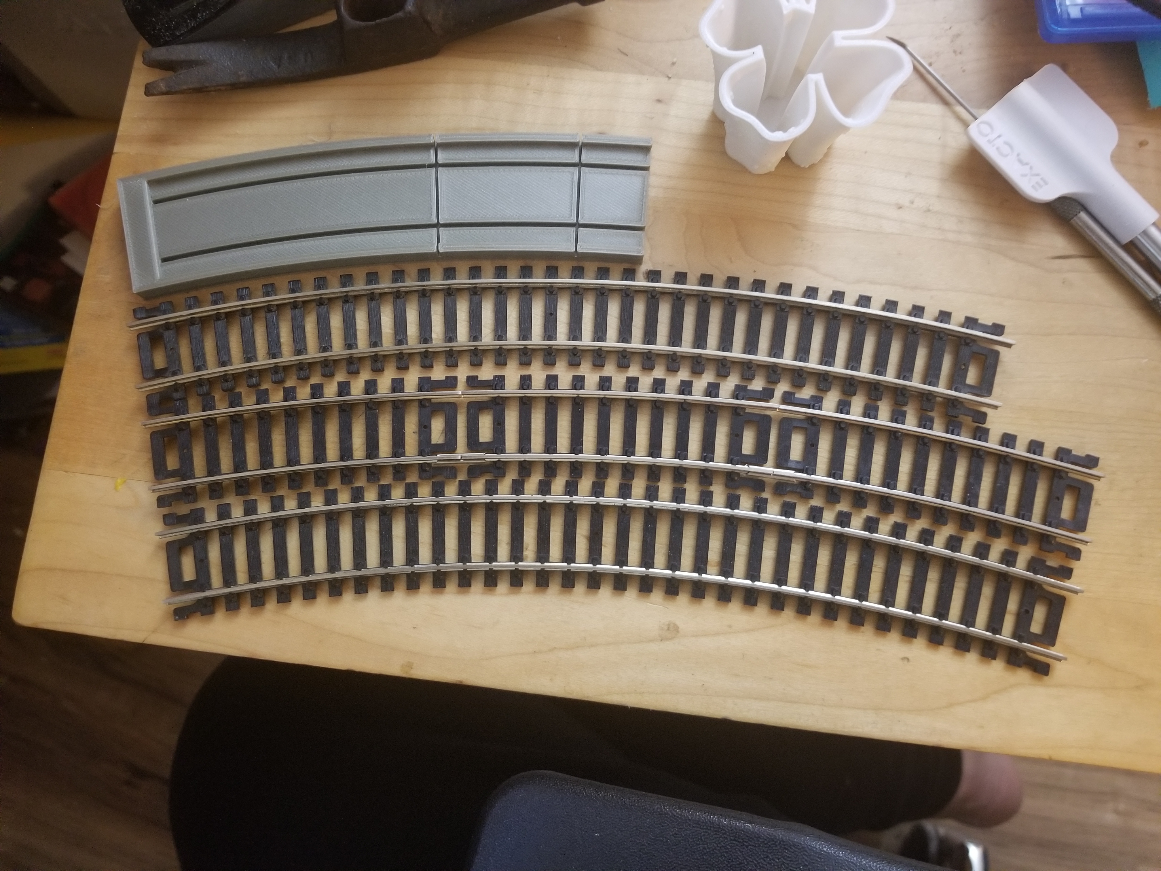

 Posted - October 29 2020 :  7:53:07 PM Link directly to this topic  Show Profile  Add tater1337 to Buddylist
I got a hunch I am gonna ask this a lot
for 18 radius track 1/3 and 1/2

 Posted - October 29 2020 :  9:23:17 PM Link directly to this reply  Show Profile  Add tater1337 to Buddylist
of course, I thought of this after I bought 8 sections of 1/3 track

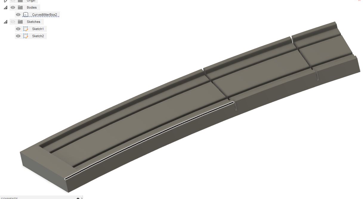

 Posted - October 29 2020 :  11:58:09 PM Link directly to this reply  Show Profile  Add tater1337 to Buddylist
Is that a miter box?
Originally posted by Locodub - October 29 2020 :  9:46:17 PM
yes, for making 1/2 and 1/3 18R track
except
I tested it with some pieces I bought and they didn't line up with my 10 and 15 degree marks
I went and double checked my model, it is still correct, the 15 degree mark is exact center of a standard 18r atlas track
I then took 3 pieces of 1/3 and joined them together (middle) and it is longer than a regular r18 track (all atlas)
it's inside rail is the same length as the outside rail of regular track
what gives?
