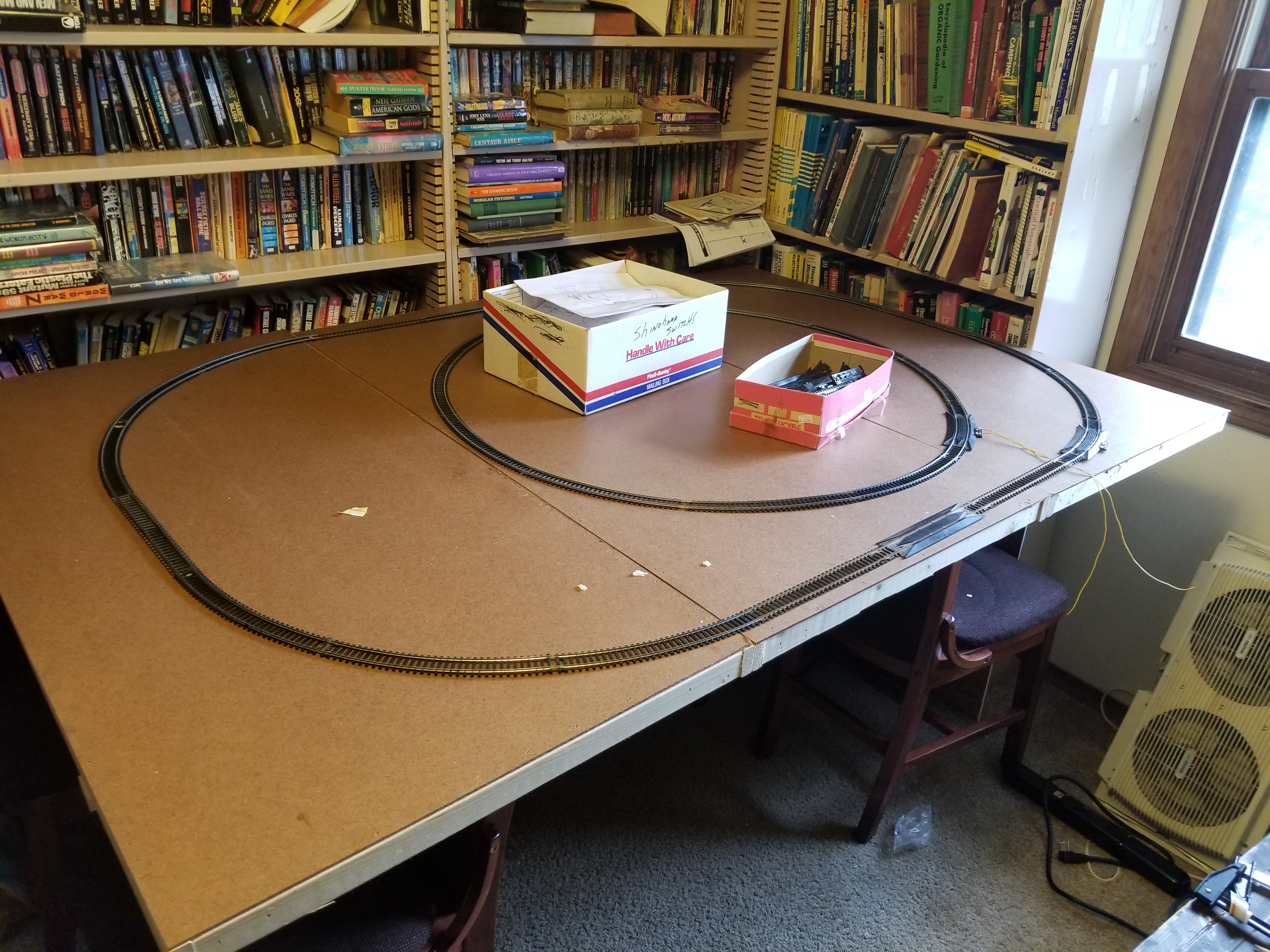

this went together faster than I thought
maybe just duct tape to start? better than hot glue

wow perspective skewed that a lot, its a 6x4, looks like 8x4
 Country: USA  ~  Posts: 172  ~  Member Since: October 09 2020  ~  Last Visit: November 28 2026 Alert Moderator  Go To Top Of Page
 Posted - October 21 2020 :  5:04:05 PM Link directly to this reply  Show Profile  Add Chops124 to Buddylist
Looking good!!

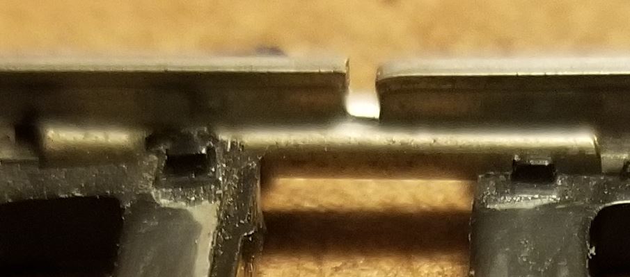

details (I did not melt that tie, that was someone's thumb-fingered attempt to solder rail joiners)
I gotta pull up about 7 sections and do it over as I have some gaps like this because I tried to do it the easy way and work from two ends(some heat, a lil exacto knife, and should be good to go)

Modified tyco layout expander setup, FYI
let's see how bad stuff derails

wow, clicking on the pictures REALLY shows flaws.
I'll have to take pics of all the track joints and blow them up to analyze
luckily I am NOT thumb fingered at solder joints (HAM operator) and should be able to touch up uneven ones like the gappy one I show, then buff it down with my diamond lapping plate (for sharpening that block plane in the 1st pic, woodworking hobby) and REALLY get things to glide

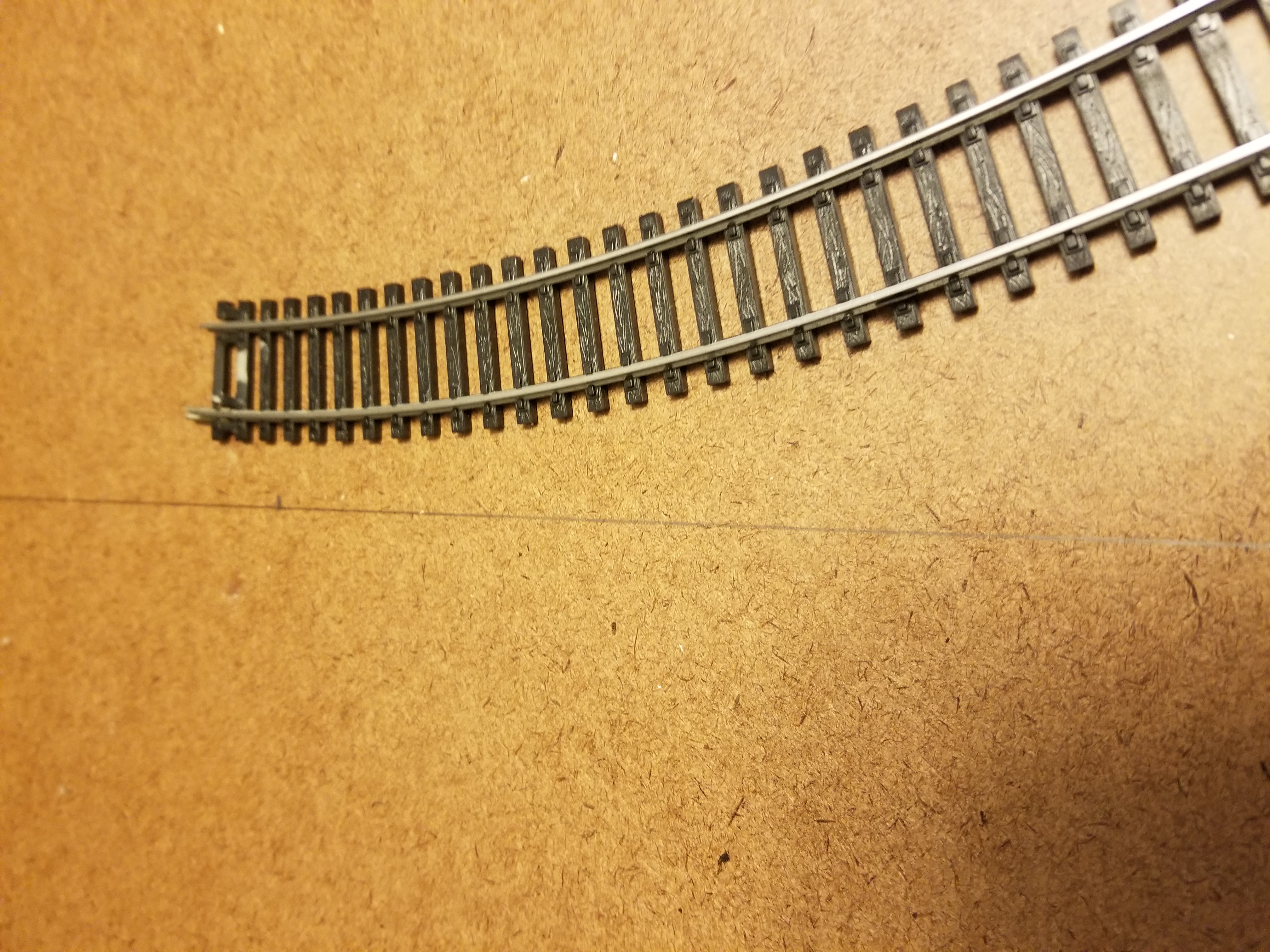

testing of removal and comparison of actual vs measured centerlines
a sharpened putty knife work great for removal, better than exacto
hot glue looks to work well
will have to keep it on for a few months to see what long term issues are
I have a hunch that I am going to end up chasing the track in circles trying to get a .128" gap to close tho
not worried
layout error is across six of 18"R and three straight 9" sections (half an oval)
