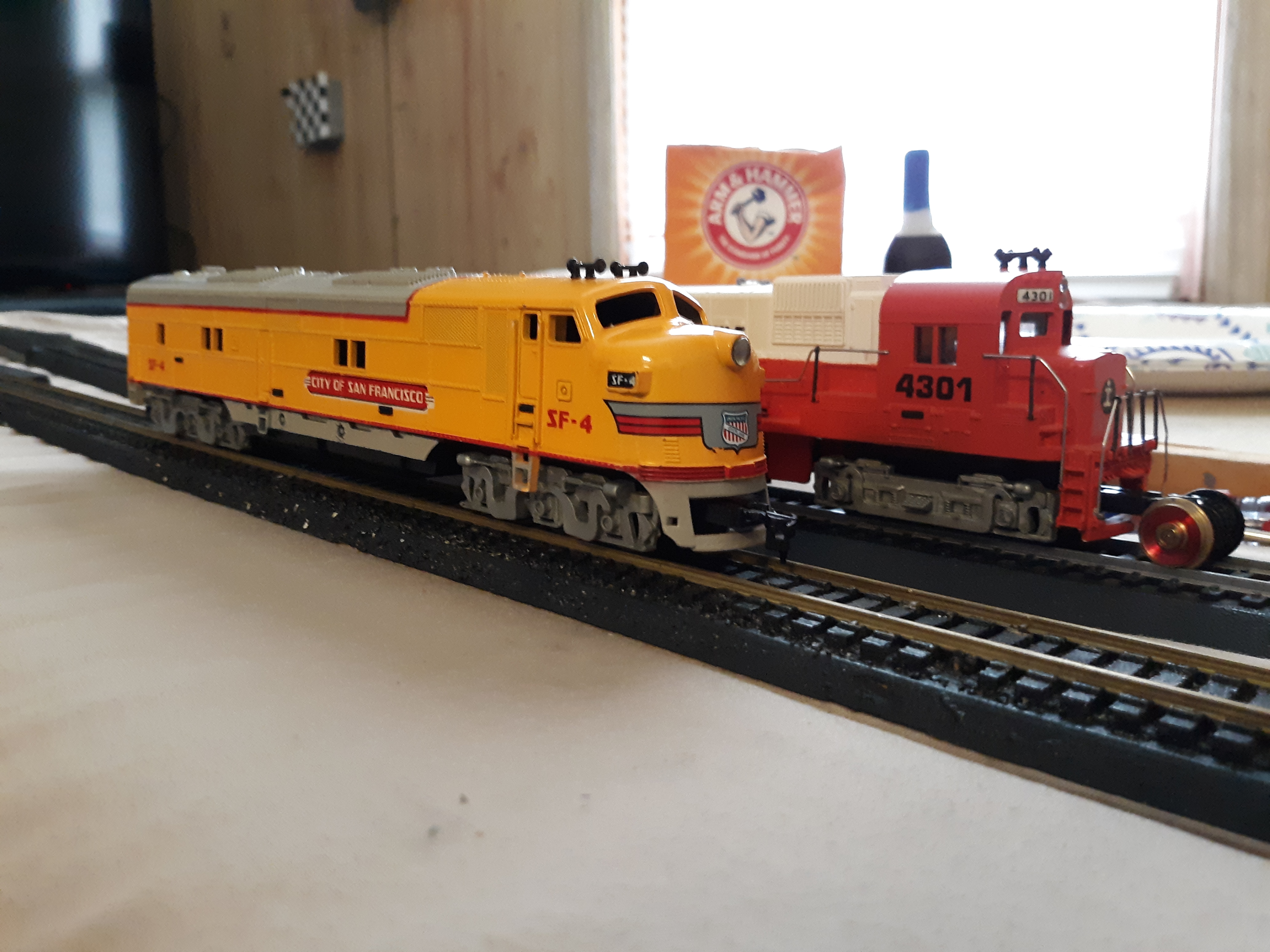

In the midst of the Anderson Lines System Shops, a smile adorns the grease covered face of the shop's tired mechanic. After many years of problem-plagued operation, the line's beloved City of San Fransico E7A runs again!
After throwing me for a loop, I finally figured out the problem with my E7A. It wasn't the pinion gear, or armature. It was a combination of multiple problems.
Movement and time have a tendency to eventually tear any drivetrain apart. That's all it takes really. Movement and time... In the case of my E7A, the #2 geared drive axle (pictured under the ICG's coupler) developed an issue with the gear in the forward direction which a caused the locomotive to shake violently when traveling forward.
Now how does a shaking wheelset stop the motor dead in its tracks you may wonder? Well that's where movement and time comes in. Over time this shaking caused the conductive headlight mounting to come loose on it's post to the point where it started moving around. Moving around so much that it would start vibrating against the motor block. And since the motor block and light mount represent the positive and negative terminals respectively, a giant short would occur, sometimes to the extent that it shut down my transformer's safety fuse. Since the vibration didn't occur in reverse, the light wouldn't shake, and the locomotive would usually run. I had the track sitting up on my bed, and that's when I finally noticed the short through the cab window. A new drive axle, and a little super glue and baking soda to the light mount fixed the issue, and got the unit running beautifully.

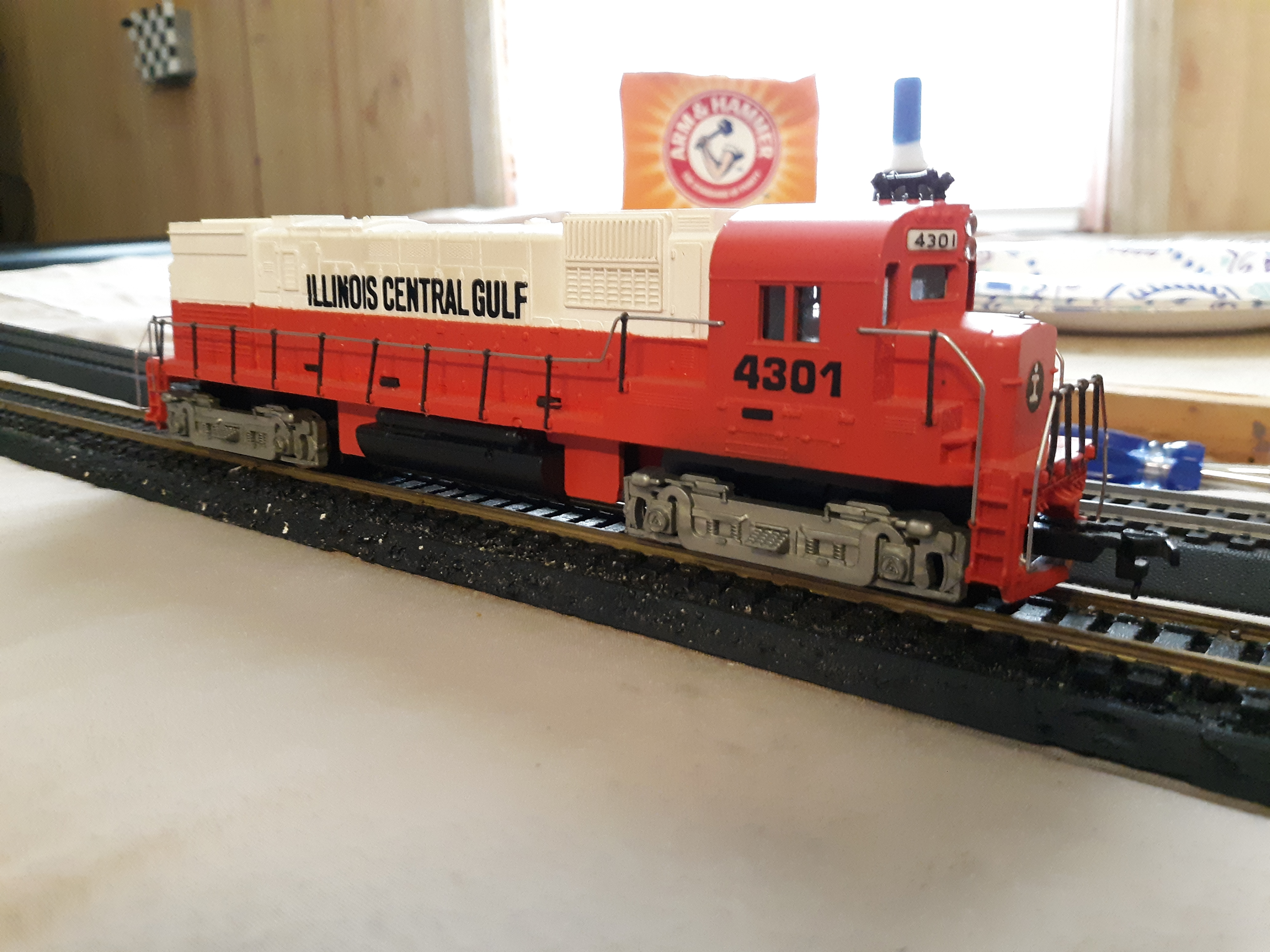

I didn't need my new ICG locomotive for parts, however it didn't run. I cleaned the armature, but the big gear was frozen up, and the pin on the motor block that held that it on snapped when I went to free it. My UP SD24 used up my spare, so this unit will be a dummy until I find a replacement part. Besides, it's always good to have an extra pinion gear around. Also this unit displays beautifully.
