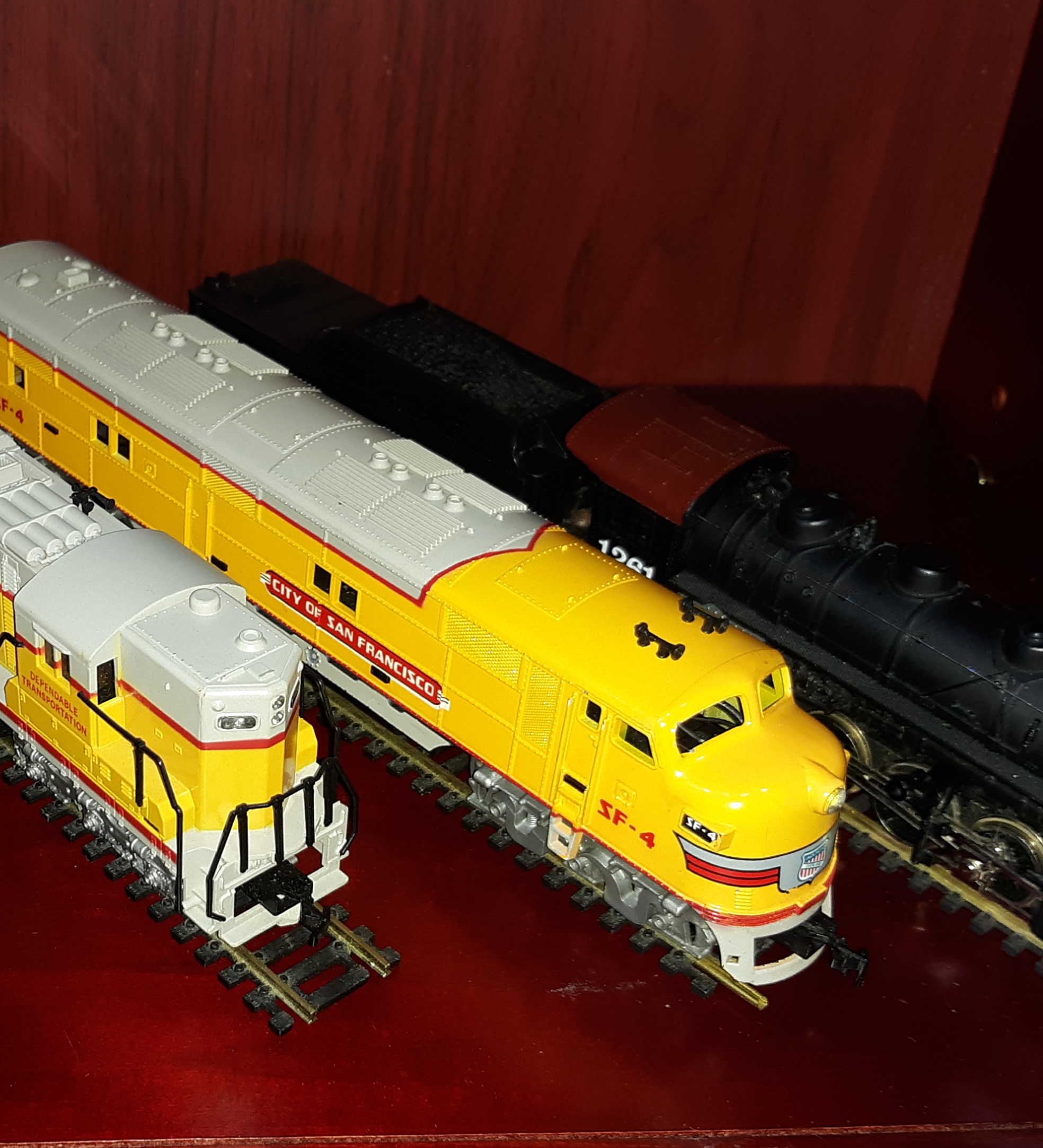

So I'm still having issues with the Powertorque in my Tyco E7A, and I'm at a loss now. I cleaned the armature, the bushings look good, springs look good, magnets looked good. I rebuilt it, and the powertorque winds up good when set on the rails without wheels. However with wheels on it won't move forward, or if it does it is choppy until it kicks the safety reset on my transformer. It runs okay in reverse. The pinion gear isn't binding or too nawed up, so that's what's making me wonder. Any help is appreciated.

That City of SF really is a classic beauty. Best of luck to you.
