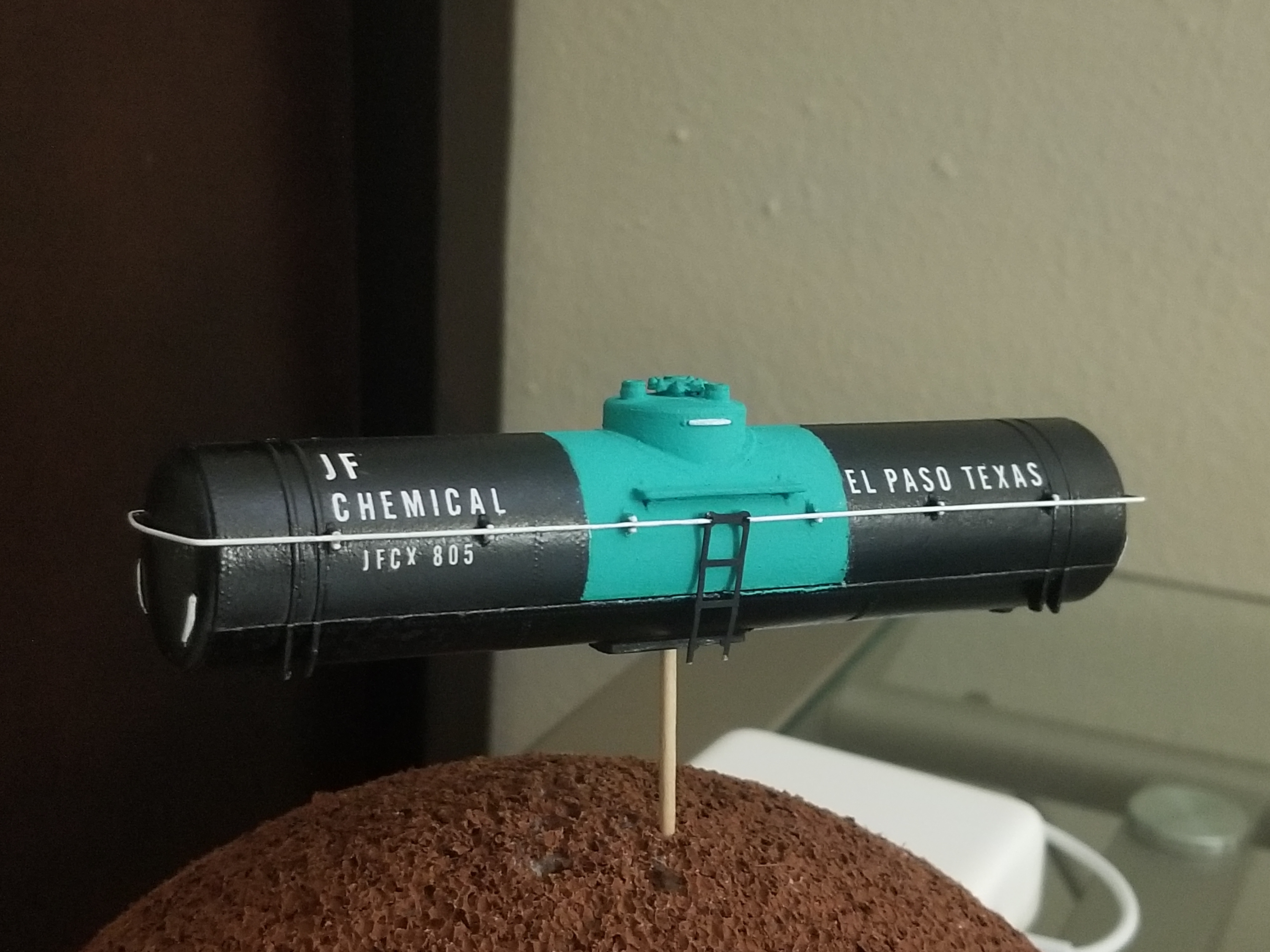

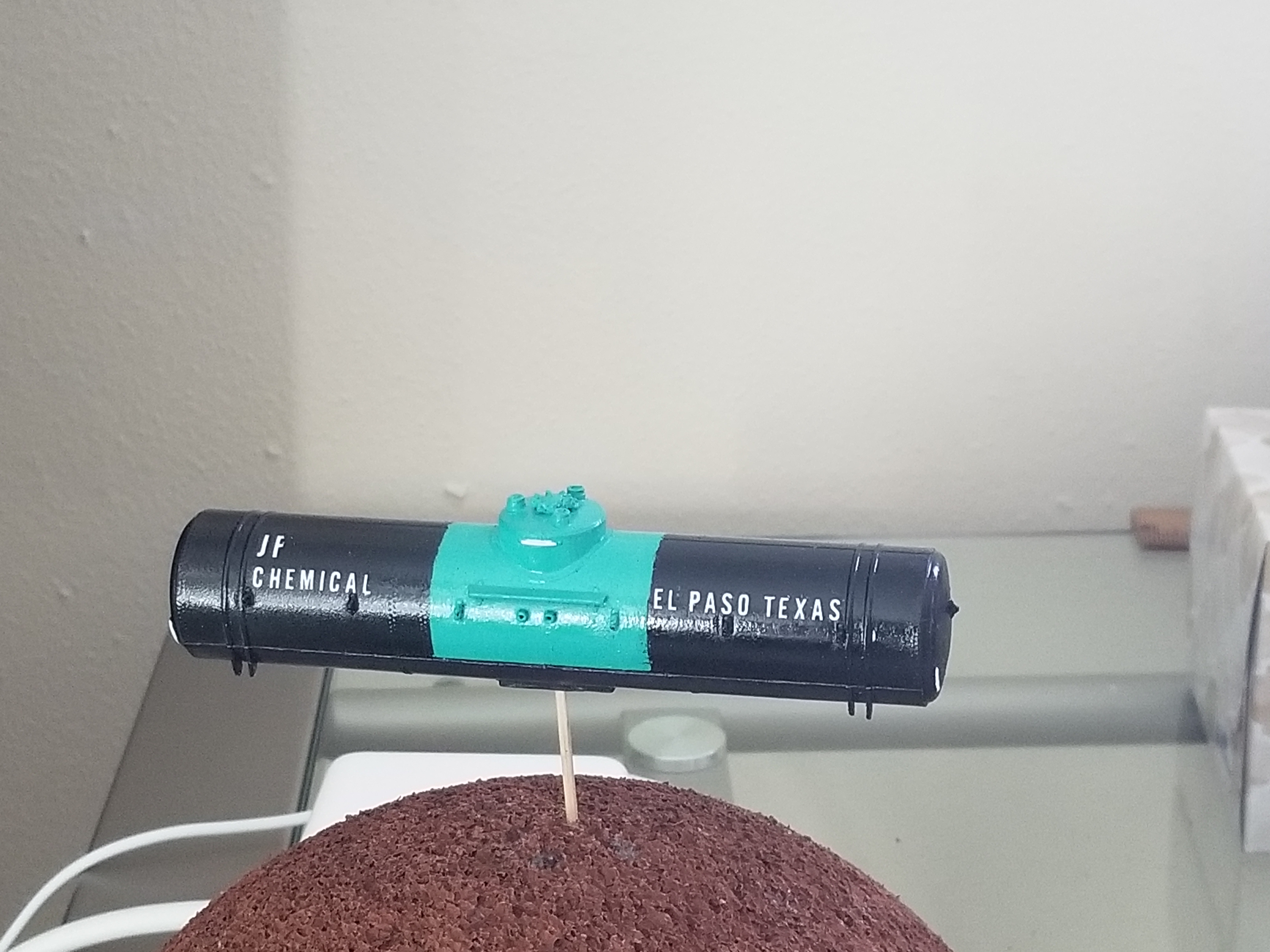

Here's the real thing. Beware of counterfeits!
But I do like the jade stripe you added. I have two more of these 62 footers by Athearn to build for the JFCX but will do them in jade with a black drip stripe by the domes.
Edited by - el rojo grande on December 18 2020 12:42:50 PM
BlaxlandAlex3
Jupiterpfp2
 Posted - December 18 2020 :  8:29:21 PM Link directly to this reply  Show Profile  Add BlaxlandAlex3 to Buddylist
Thanks guys! I was contemplating on JFCX or JFX reporting marks. looks like I made the right choice going for JFCX!
Maybe I'll make an all jade one sometime in the future... yours does look nice!

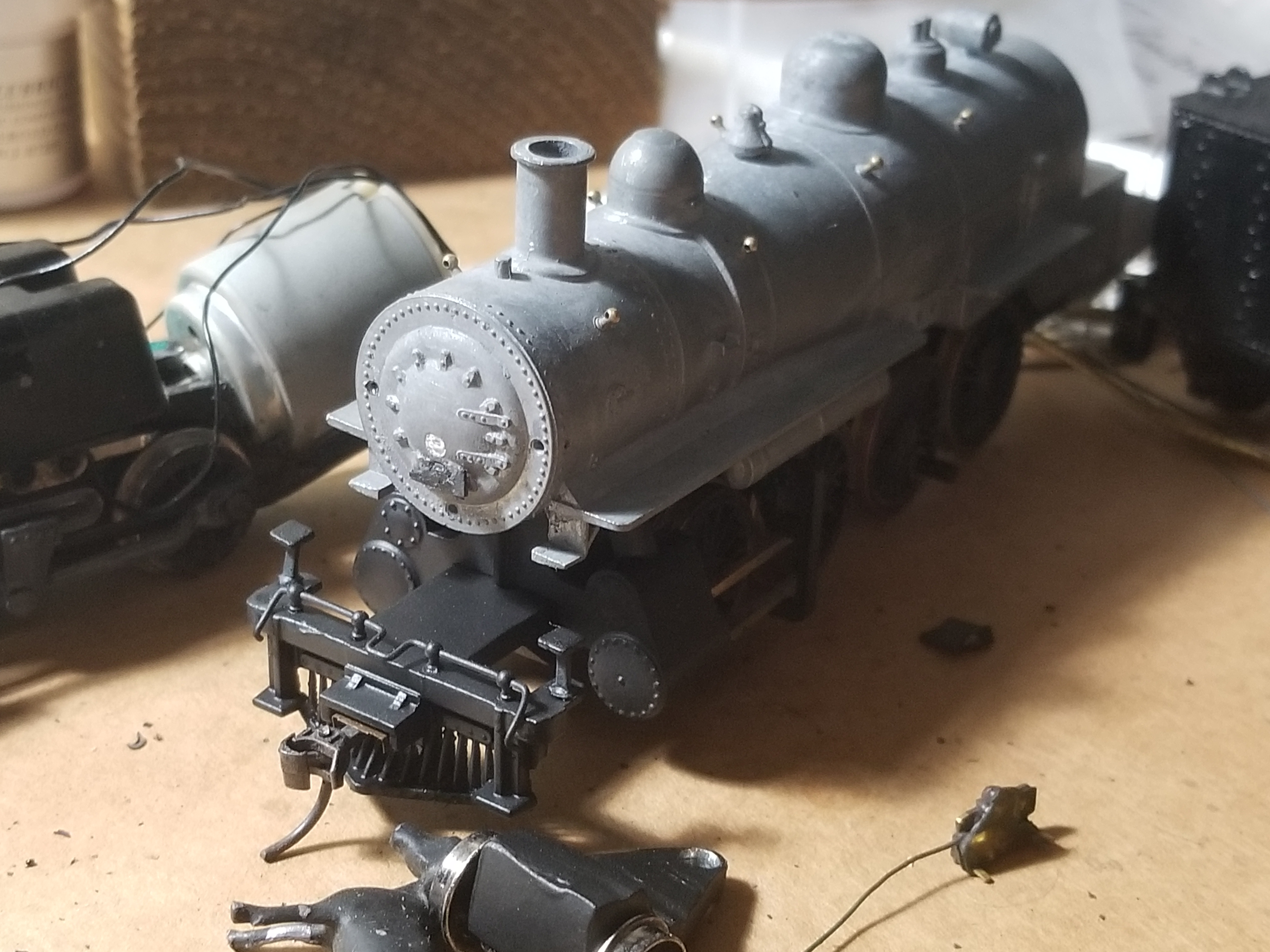

So I disassembled the engine and sentenced it to the DOT 3.

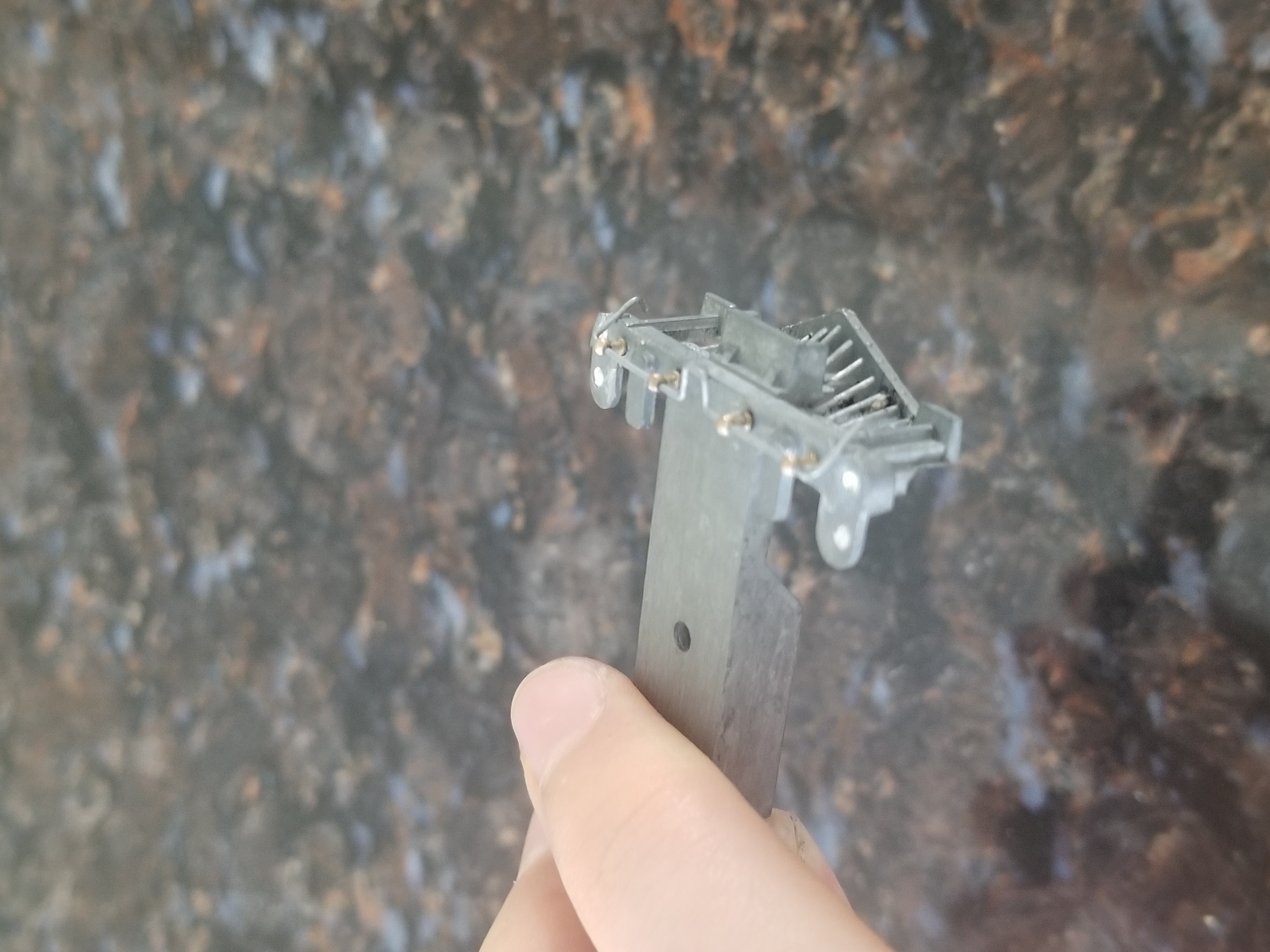

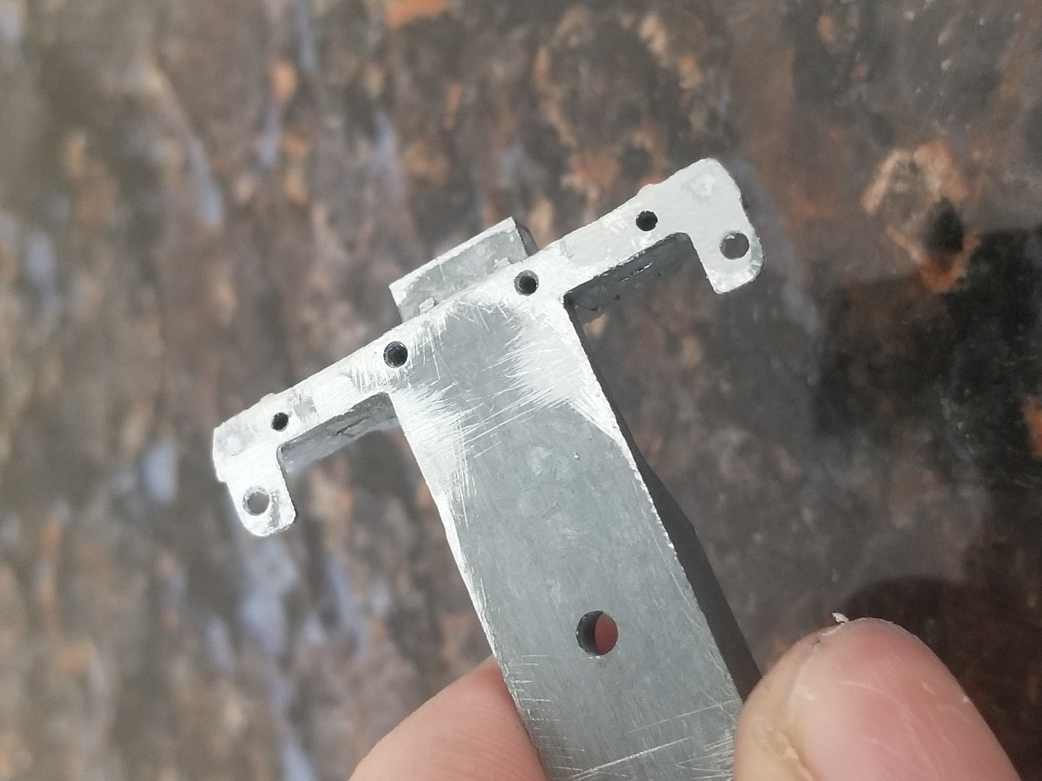

Once the whole engine had been rid of the old paint, I made some changes to the pilot. I filed away these odd two protruding metal things that served no purpose, looked weird, and arent on the real C-9, so they're gone now.

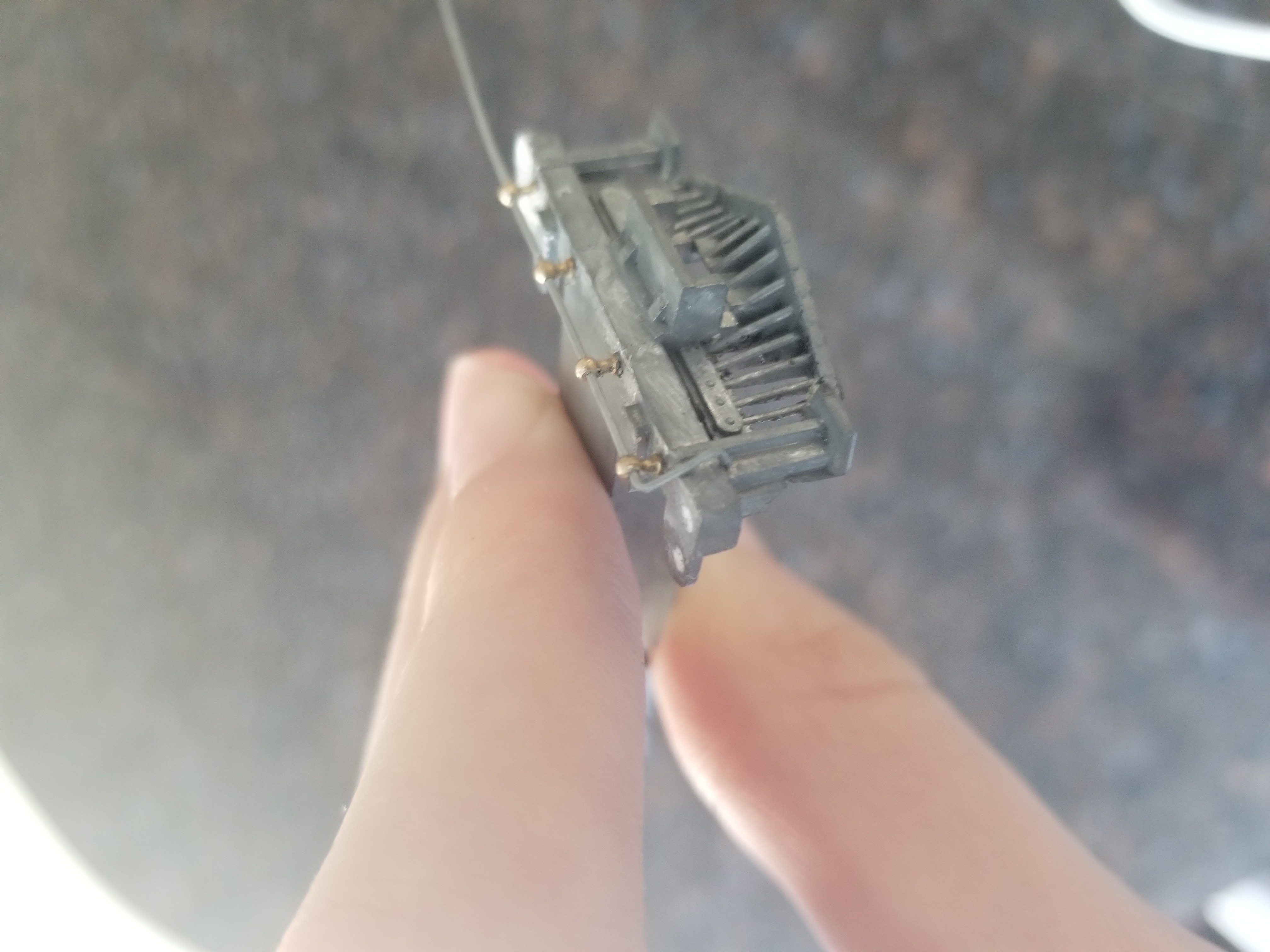

I had an implied uncoupling lever on the front on the old version, but the middle ring part was large and awkward, and looked terrible. I also hadn't bothered to make those funny shaped parts on the end. I dont know how to describe them, but you'll see it on the completed bar.
However, to make this new coupler bar, I had to move the end stanchions in some. So I filled old holes and drilled new ones as shown above.
As shown here, I have the stanchions in, and am making the bar. You can also see the funny end part I was talking about earlier.
Here I've got the bar completed and installed. With crisp sharp edges, and all the right parts, this looks sooooooo much better than what I tried to do a few months back. Go compare the two!

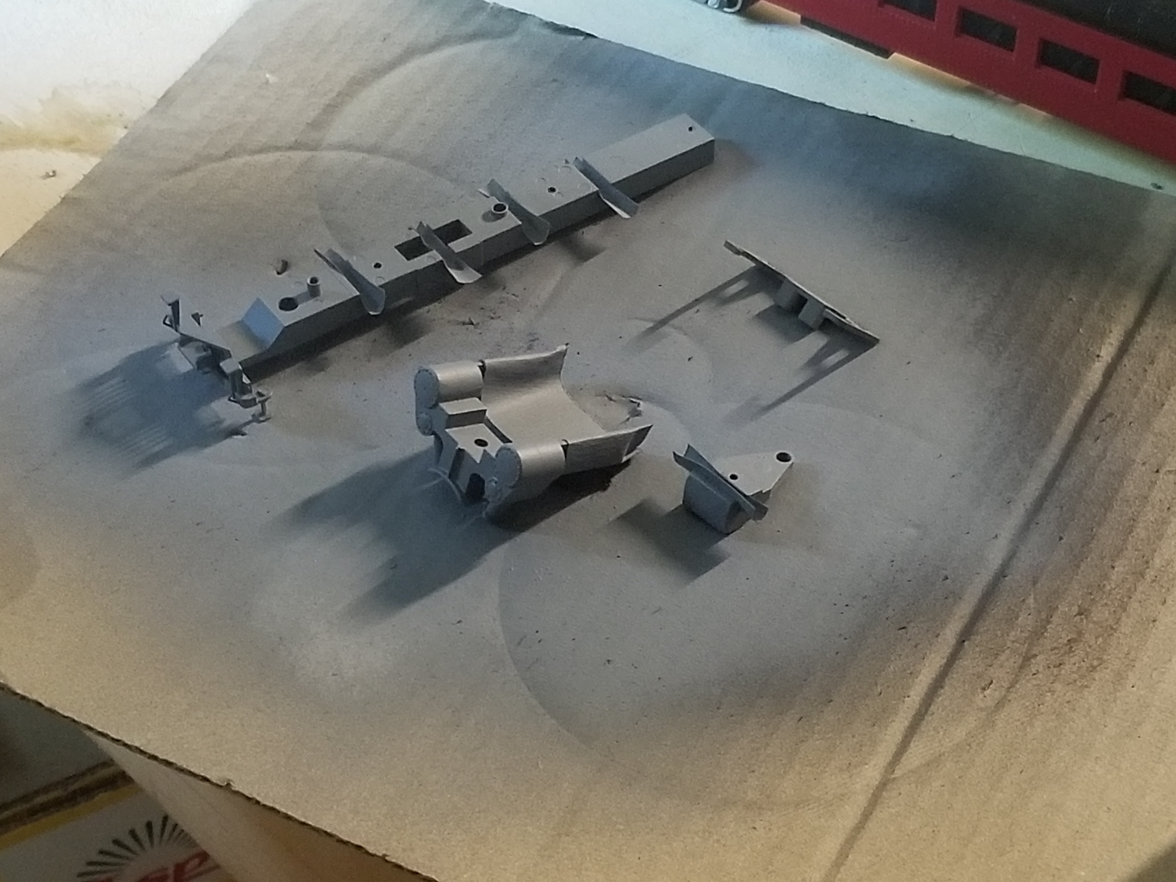

Next, I added the two step details, and applied a coat of my favorite krylon primer to the frame parts.
Once it was all said and done, matte black followed. This is the only picture I have of it in that state

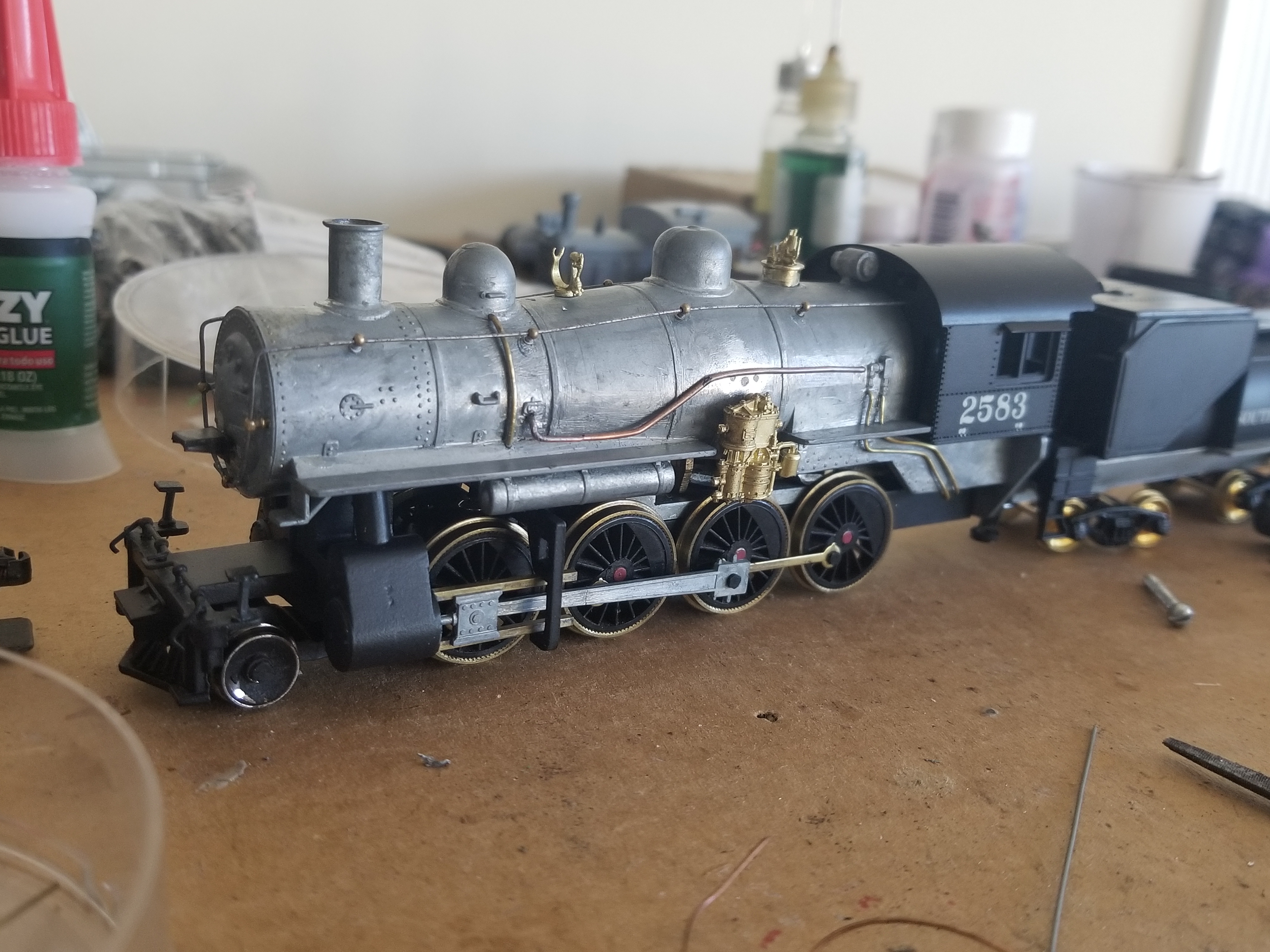

Where did we leave off? Ah, the frame was completed and painted. Once again, the locomotive sat untouched for some time, as I attended to other things. Then, two weeks ago, I went to the first train show of 2021, which was also the first train show I had been to since covid began. Let's just say, it was a very good start to the year! I may share the things I got under the flea market finds thread, but uh, I have the big lazy sooooo yeah

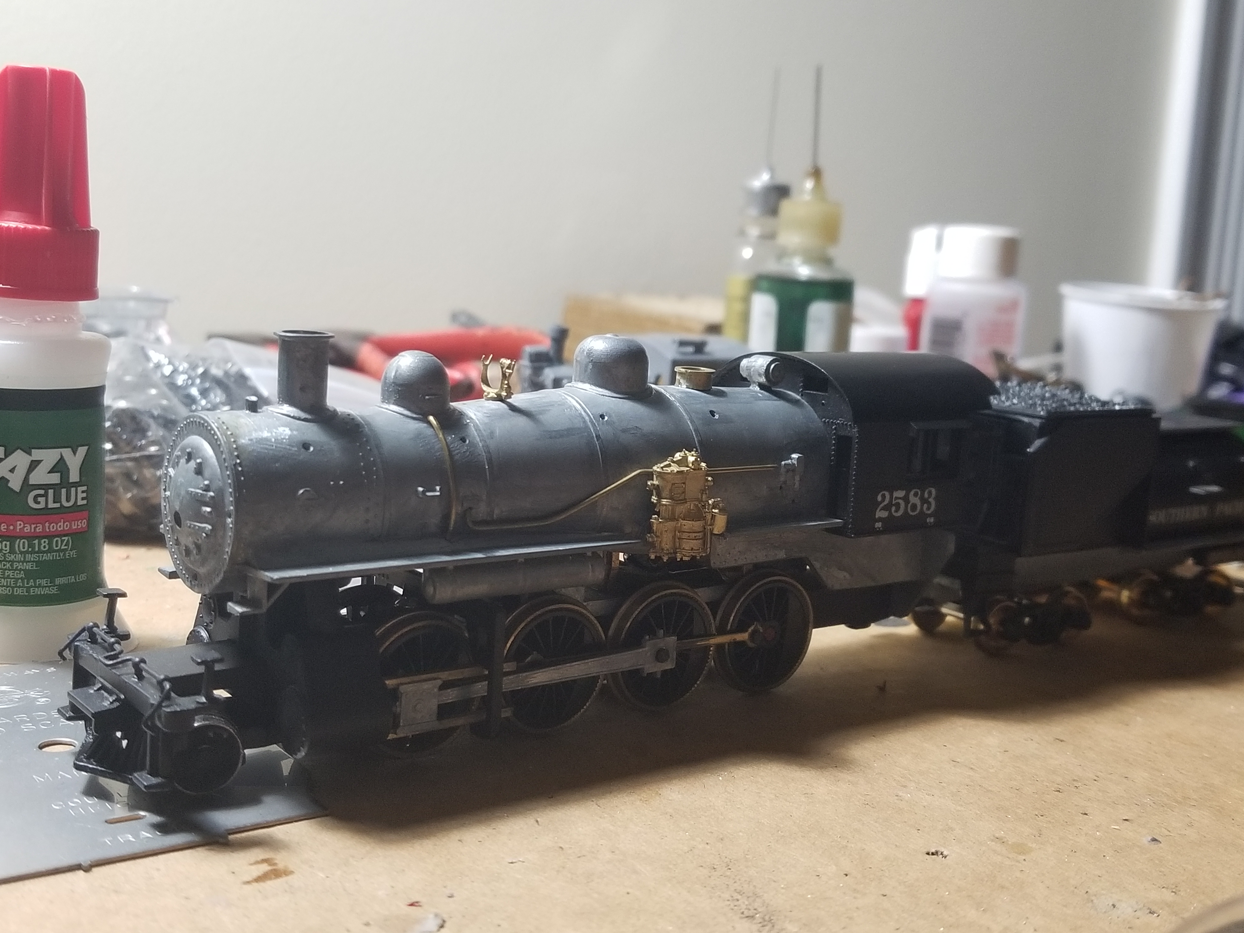

One of the things I pretty much stole at the show was an MDC 2-8-0 unbuilt kit and an MDC Santa Fe built locomotive kit. Got them and their parts for 40 bucks total. I was ecstatic.
A bunch of very useful parts and details were included, and upon further inspection I found that a lot of the parts were for the 2-8-0, which had holes drilled by the previous owner, and the parts ready to be added. So, I pulled out the two consolidations and got to work.

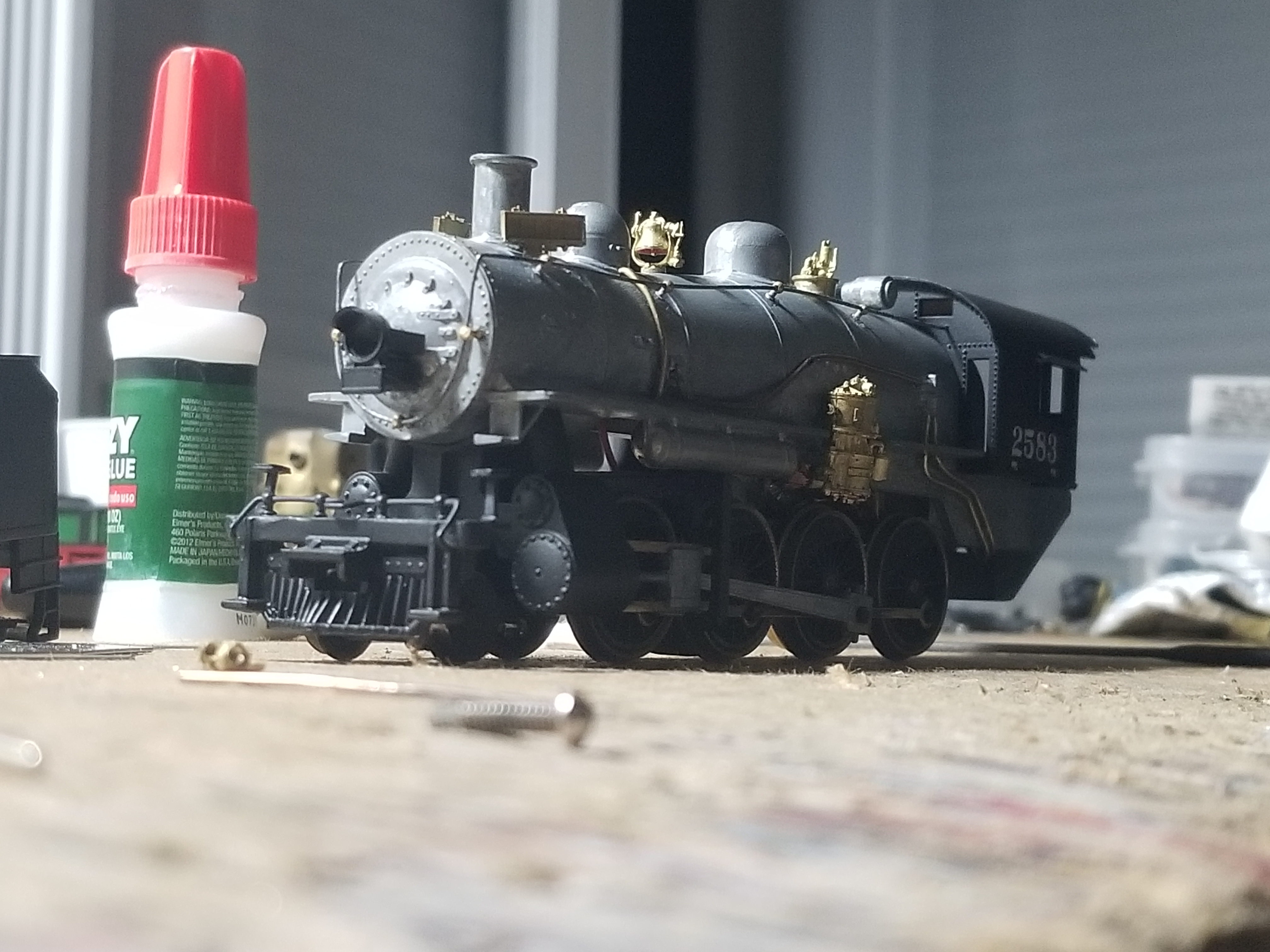

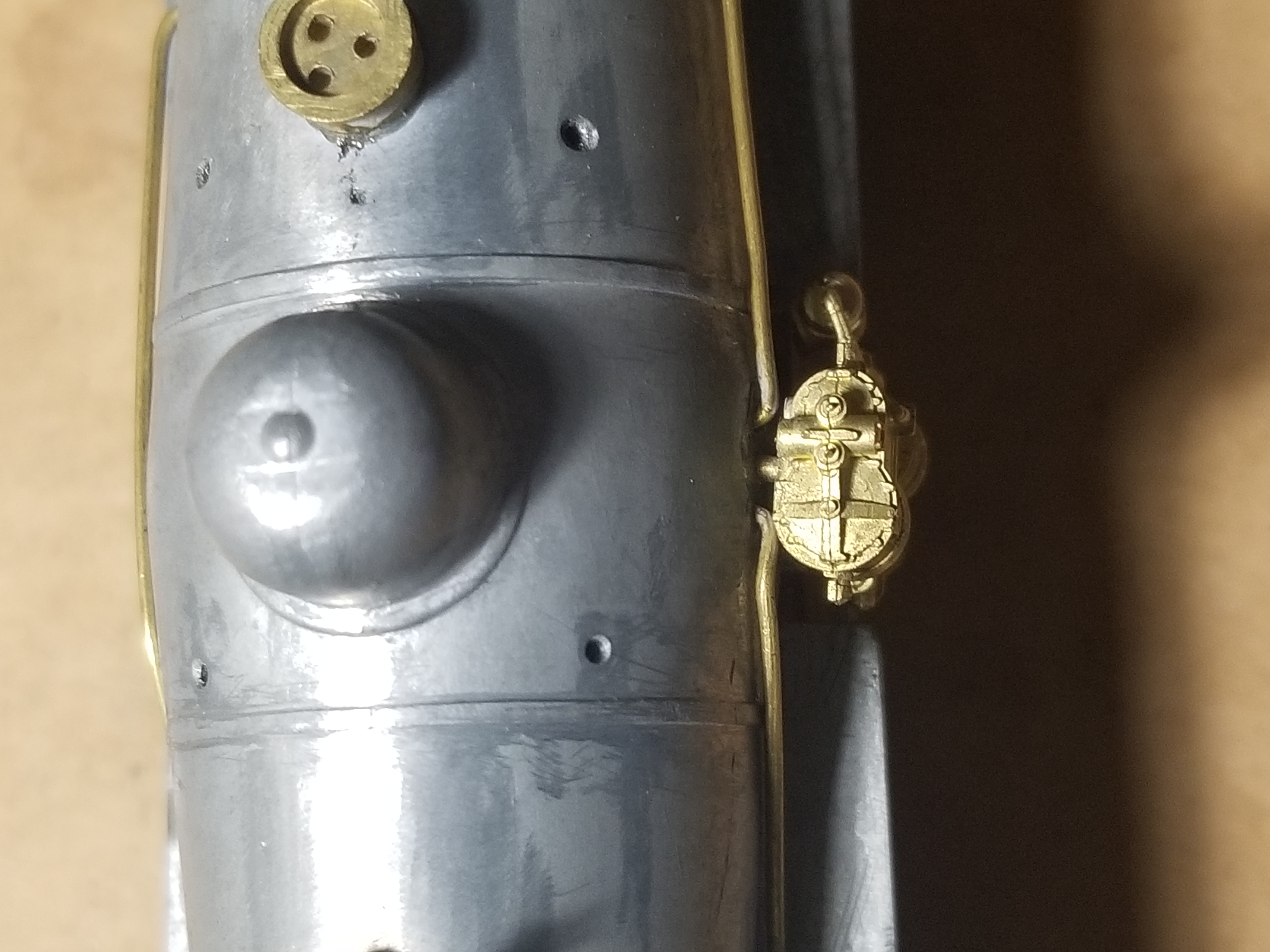

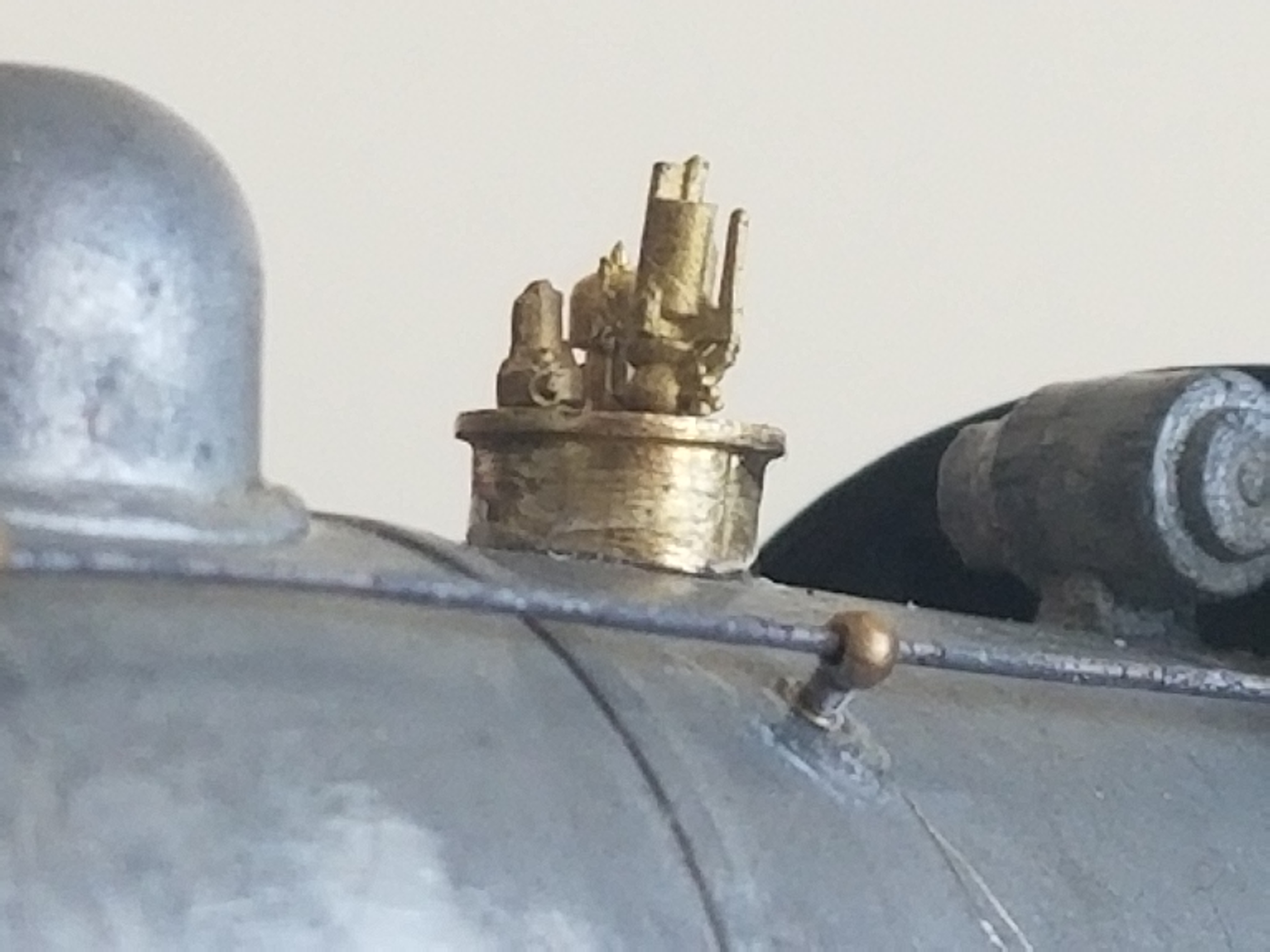

I began adding the details, but the first glaring issue was the compressor. It was wayyyy too high.
Lowering it would be a challenge as the "piping" for the injector is broken up to accommodate for the compressor.
I contemplated leaving it as is, but it bugged me too much, so I filled in the holes, bent a new wire, and glued the compressor on below.
Much better!

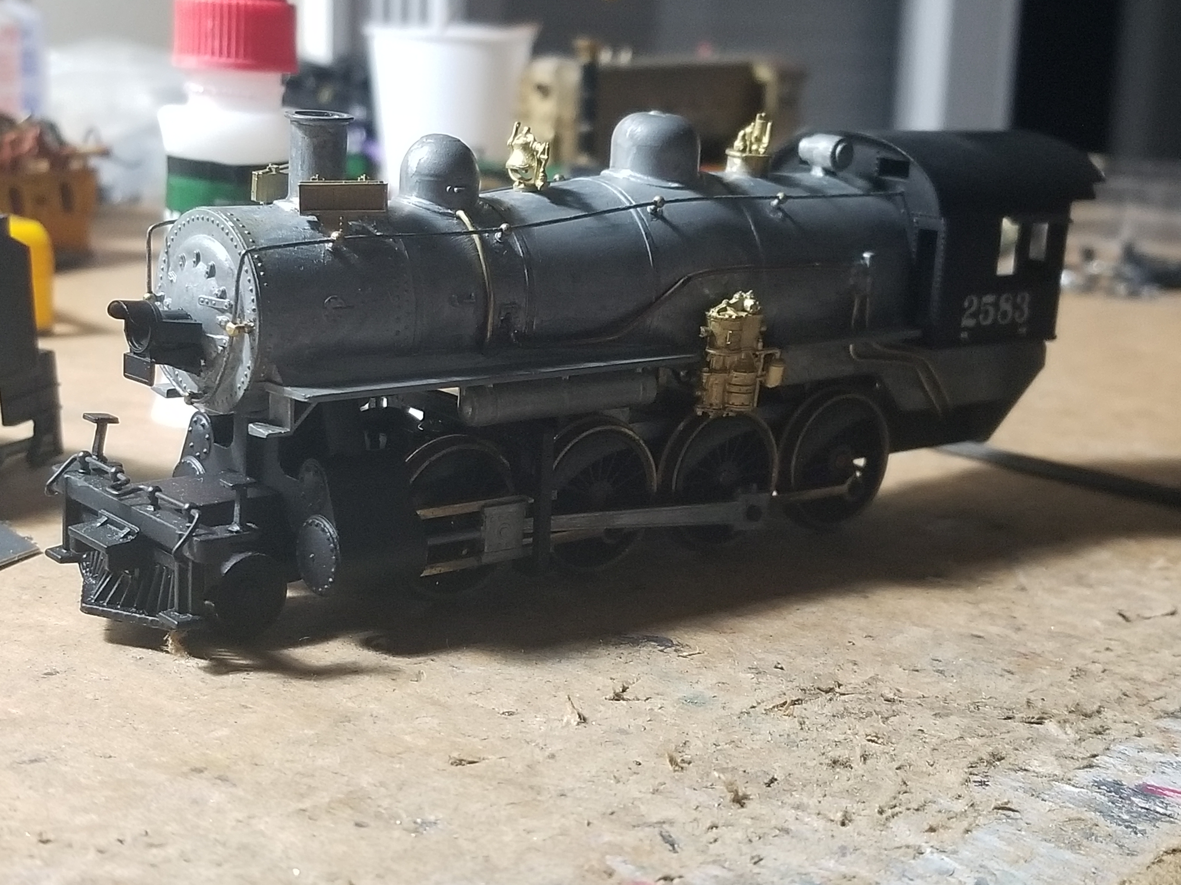

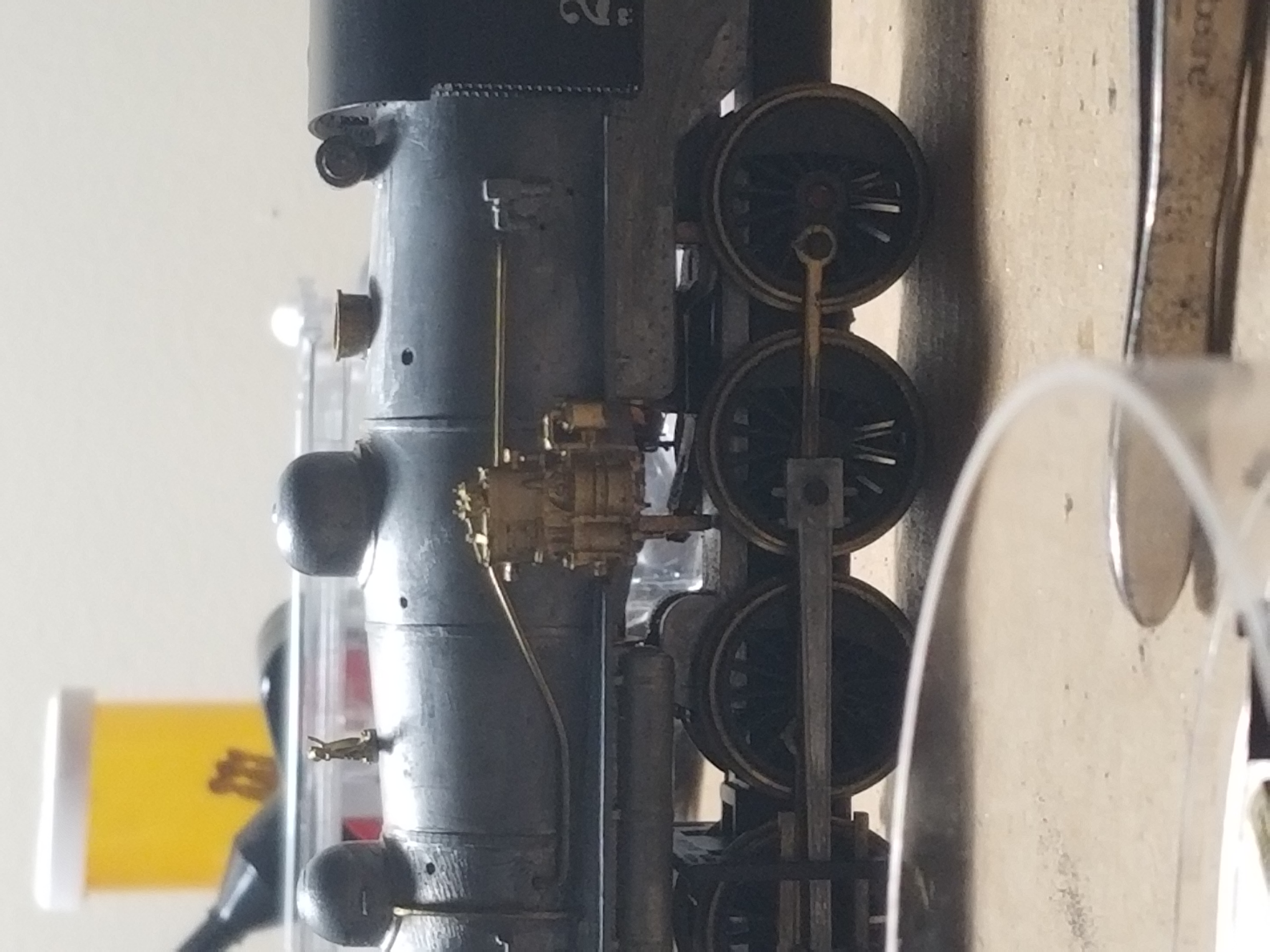

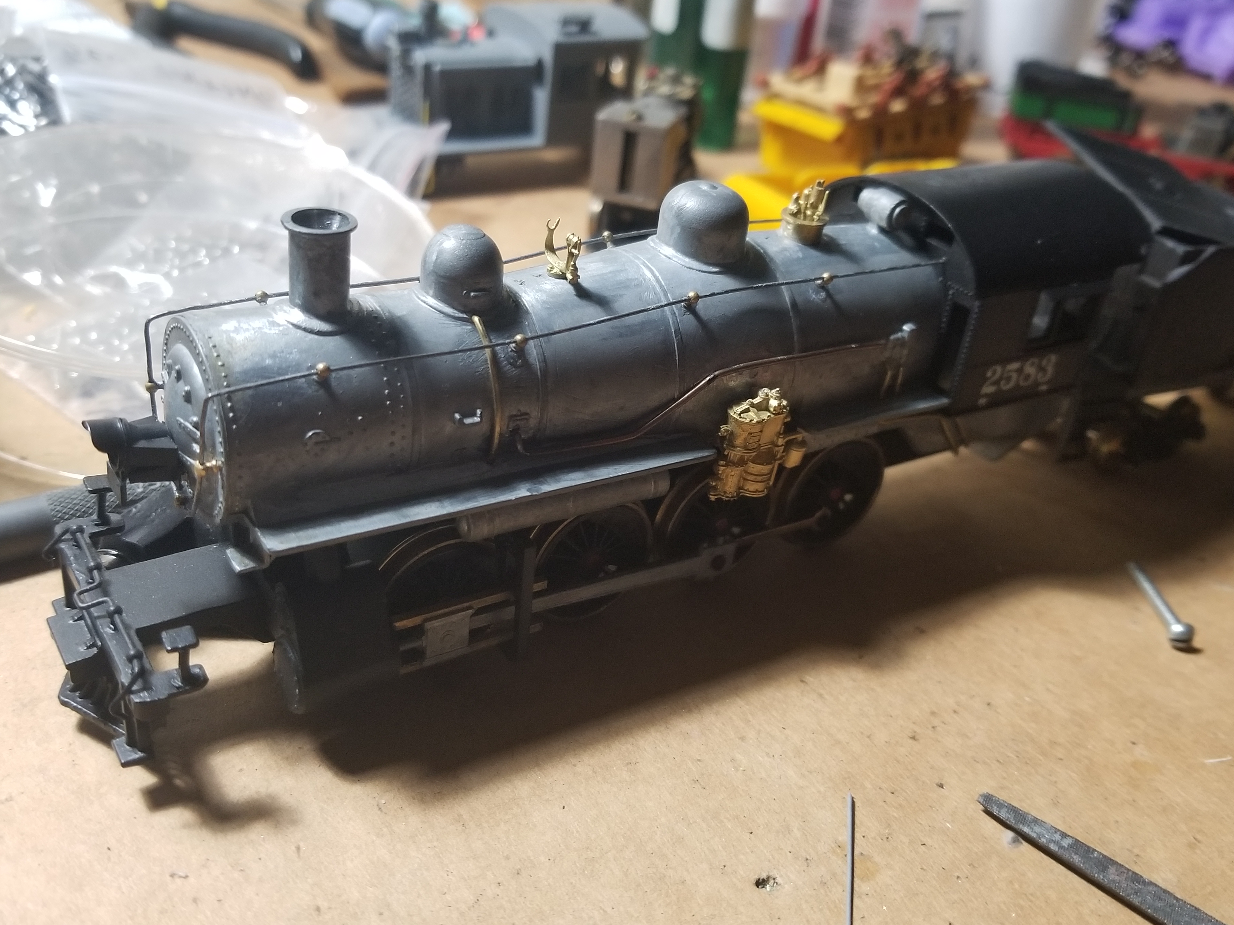

At this point, I also fitted the handrails and the injector piping.
And assembled the steam turret (I think it's called a turret)
And then the headlight (I drilled a new lower hole and filled in the old hole to get that SP low headlight arrangement)
Next I glued on the new number boards, they aren't perfect, but they'll do.

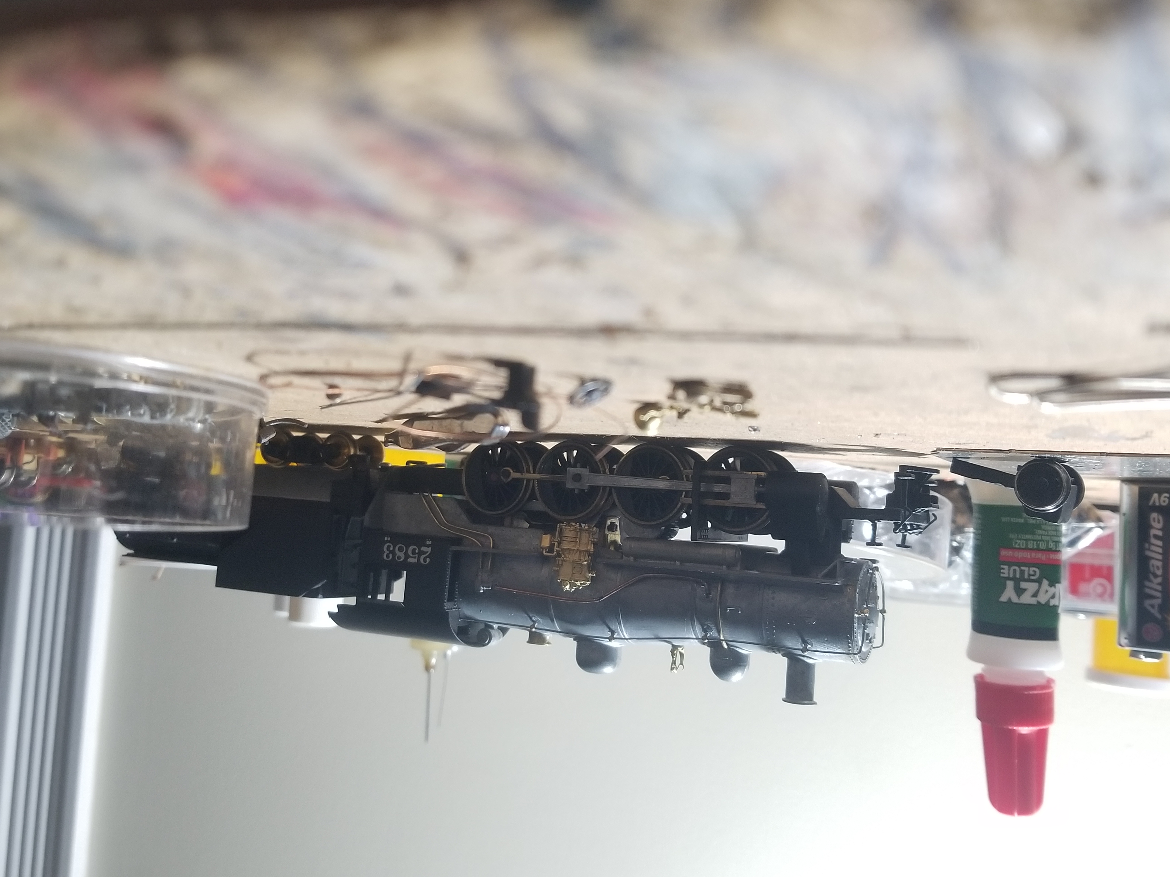

I threw on the pilot truck for testing as well.
I guess I didnt take any pictures of the marker lights, but I did drill new holes and insert some better castings which you will see in the coming posts.
And just like that, it was done! Next up, paint!
Edited by - BlaxlandAlex3 on February 01 2021 5:46:00 PM
