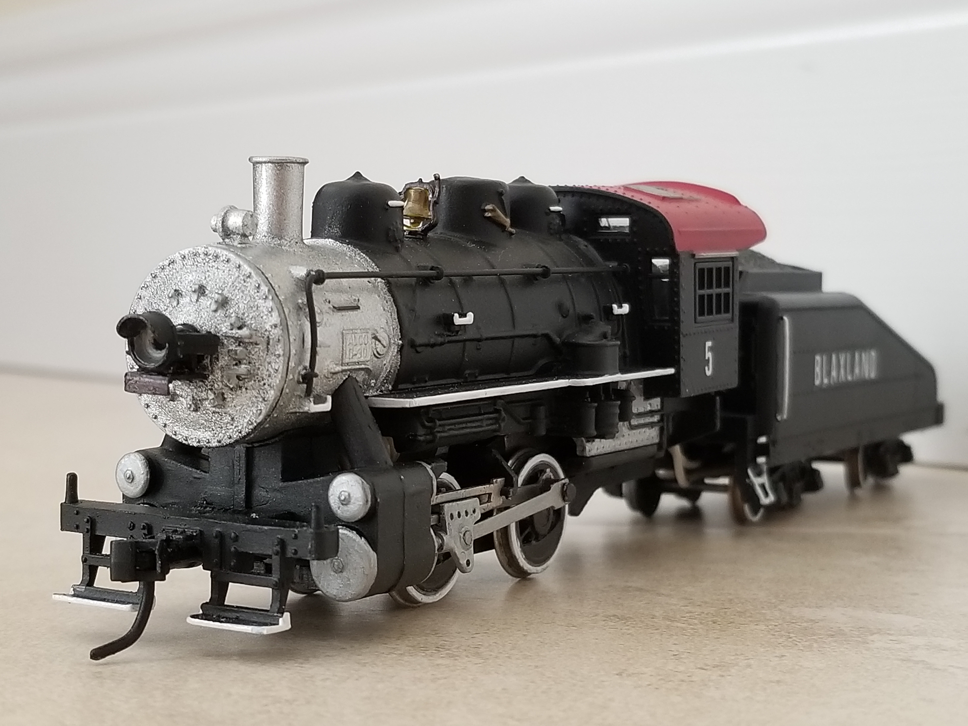

Finished the Shifter, Blaxland #5 at last.
 Posted - June 26 2020 :  10:12:53 PM Link directly to this reply  Show Profile  Add RP model railroads to Buddylist
NICE

 Posted - June 27 2020 :  08:53:23 AM Link directly to this reply  Show Profile  Add BlaxlandAlex3 to Buddylist
NICE
Originally posted by RP model railroads - June 26 2020 :  10:12:53 PM
Thanks!
