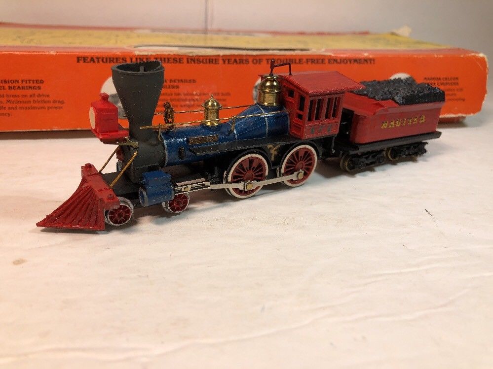

Original Jupiter Remotor: I bought a cheap can motor from China to remotor my old Jupiter just for the heck of it. Haven't started it yet although the tender is disassembled.
TYCO Plymouth Transformers Diesel: I may just get a donor chassis and plop the shell on it. I've tried everything and it still doesn't move. I'd get rid of it but it is a sentimental piece to me.

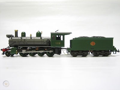

Mantua/Tyco 0-4-0 Shifter (Blaxland #5): With Redneck Justin's help, I concluded that the Mantua 2-6-6-2's smokebox front is a perfect fit! Ordered one on Thursday, hoping it arrives today. If it does it just needs to be painted silver and then have the headlight installed.
Bachmann 0-6-0 Saddle tanker: Done, but needs a cab. This one will most likely be sitting on the table for awhile.

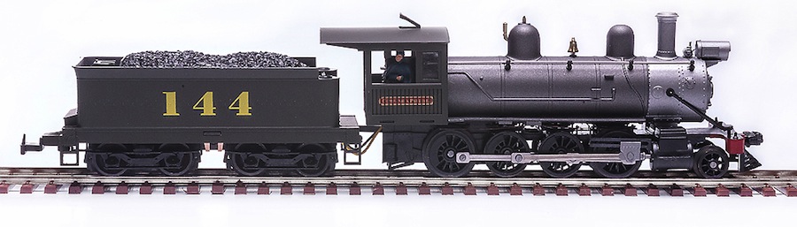

If I don't kitbash my 4-6-0 and my Tyco 4-6-0 I may paint it up like #144. I would do the green of #112, but I have no Green paint.

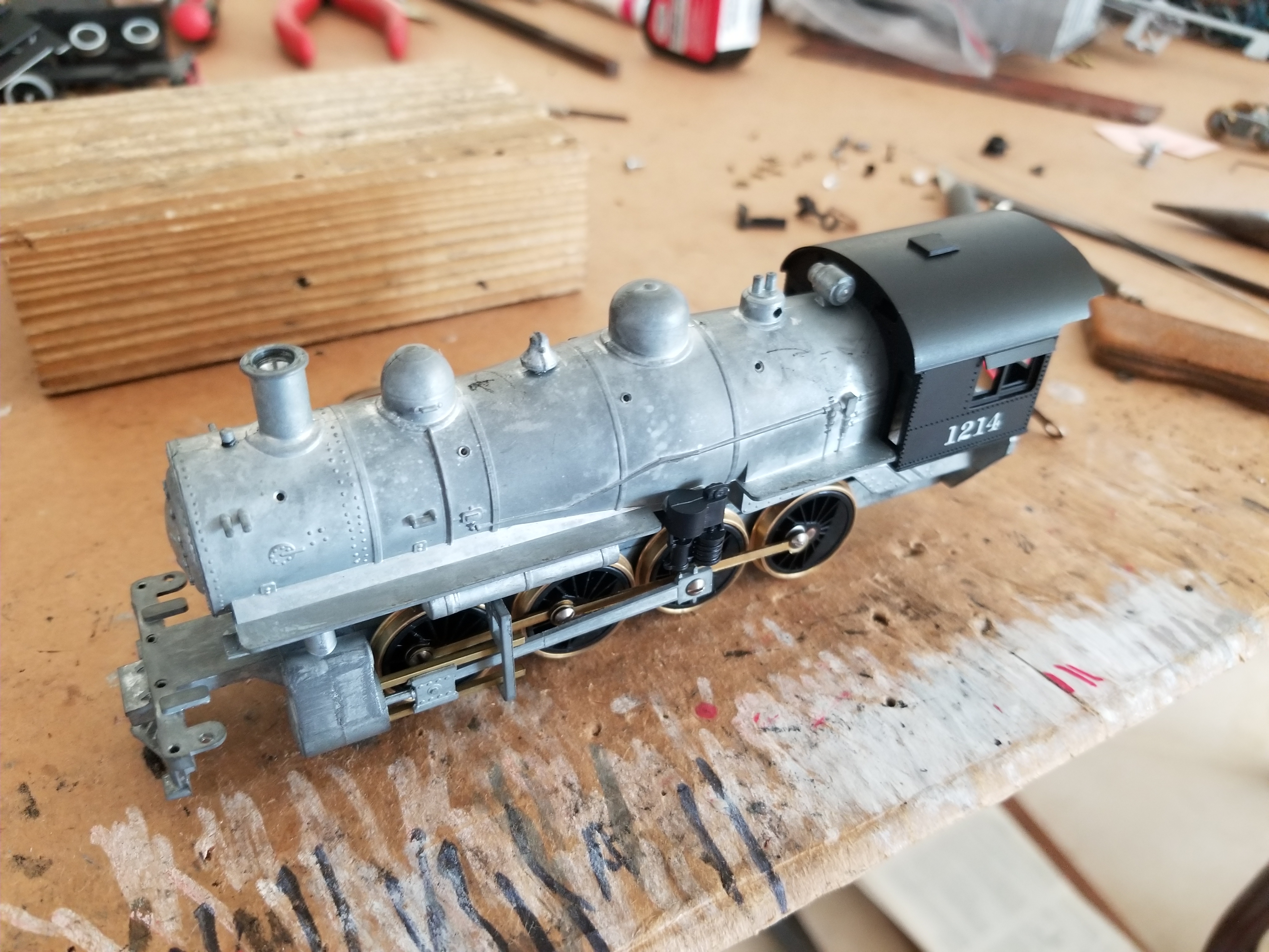

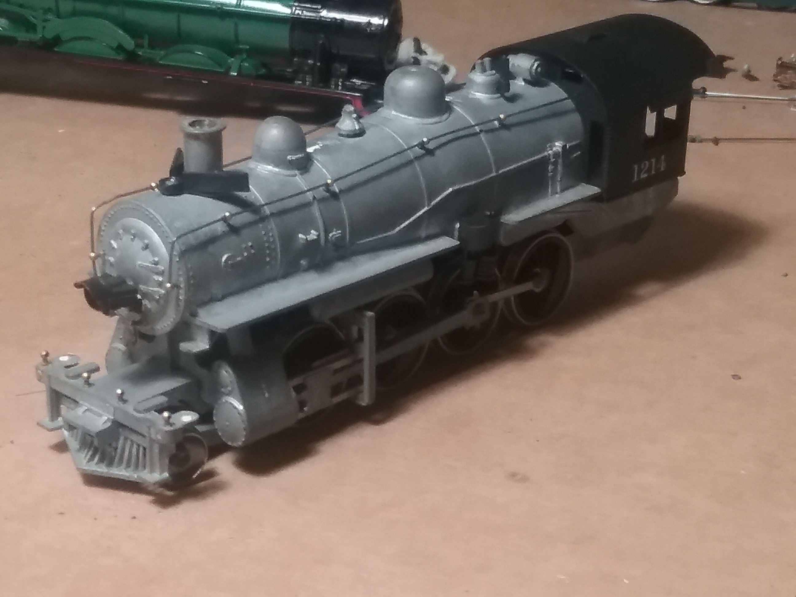

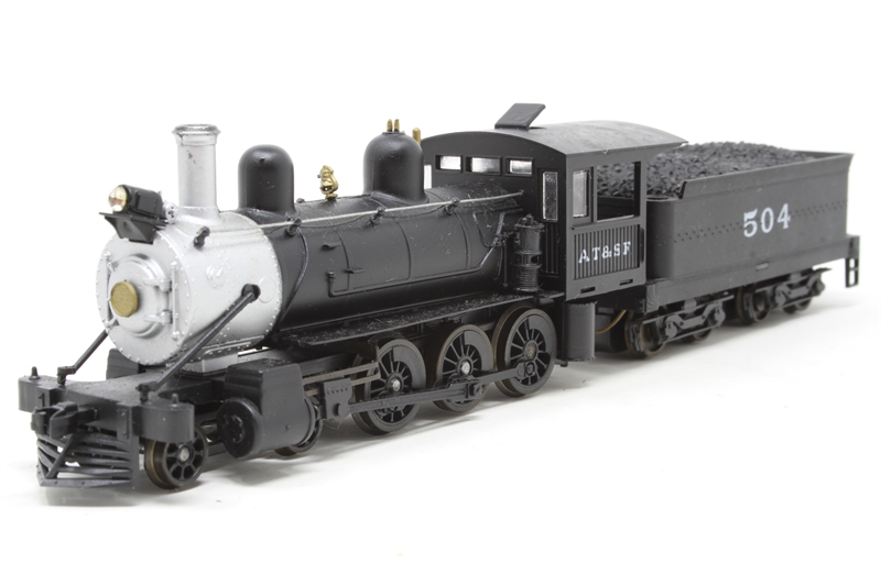

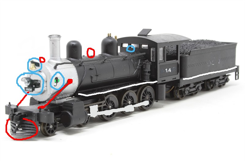

Played around a bit in Pixlr and came up with this:
Here is how mine currently looks: (Not my photo)
Here is how it will look when I finish it:
As you can see I have made minor mods.
Red - Removed Parts
Blue - Replaced/ Added Parts

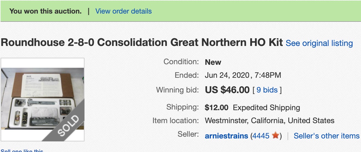

New Project!
Roundhouse Harriman 2-8-0
I will be swapping out the tender for a vanderbilt

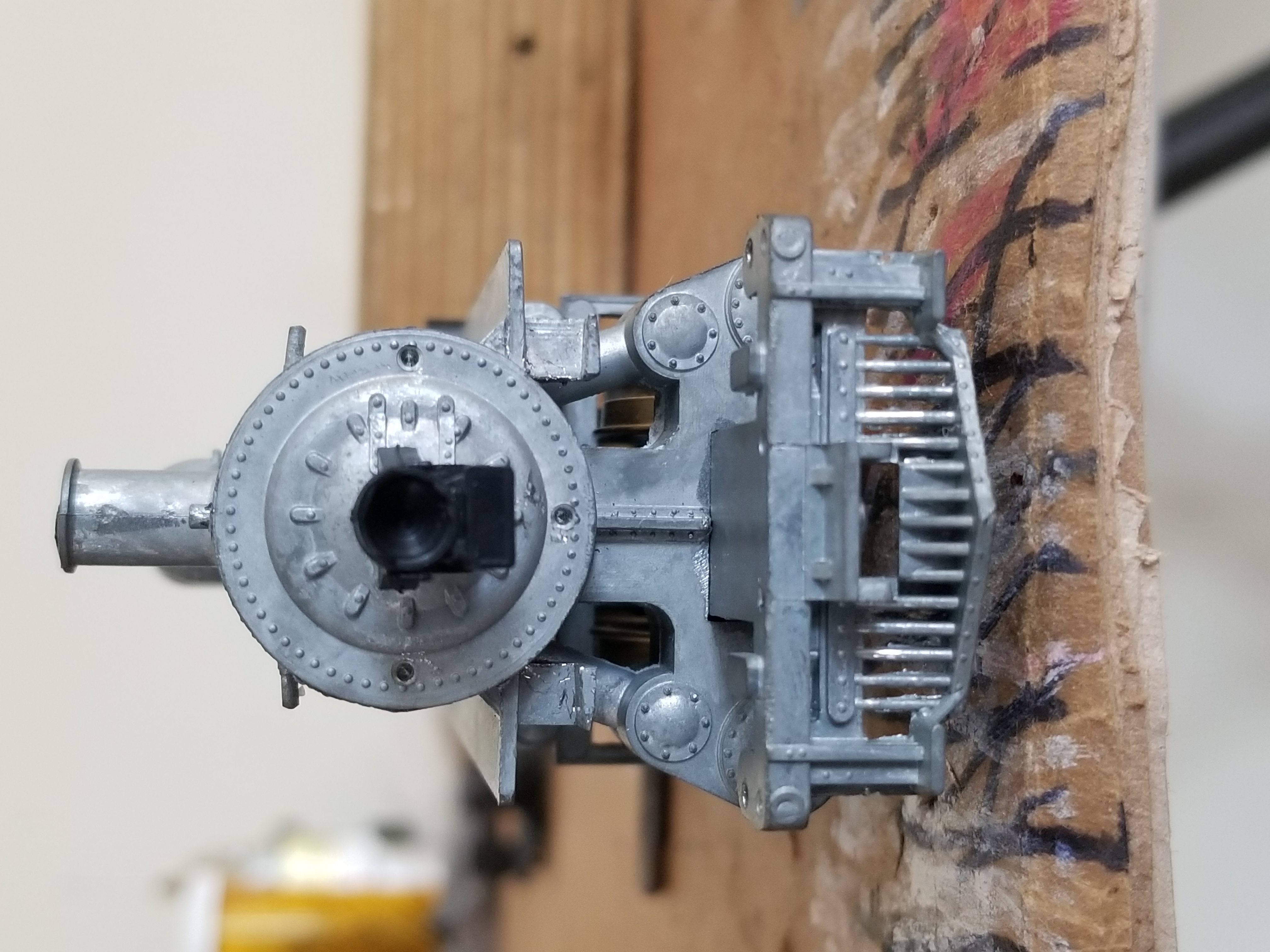

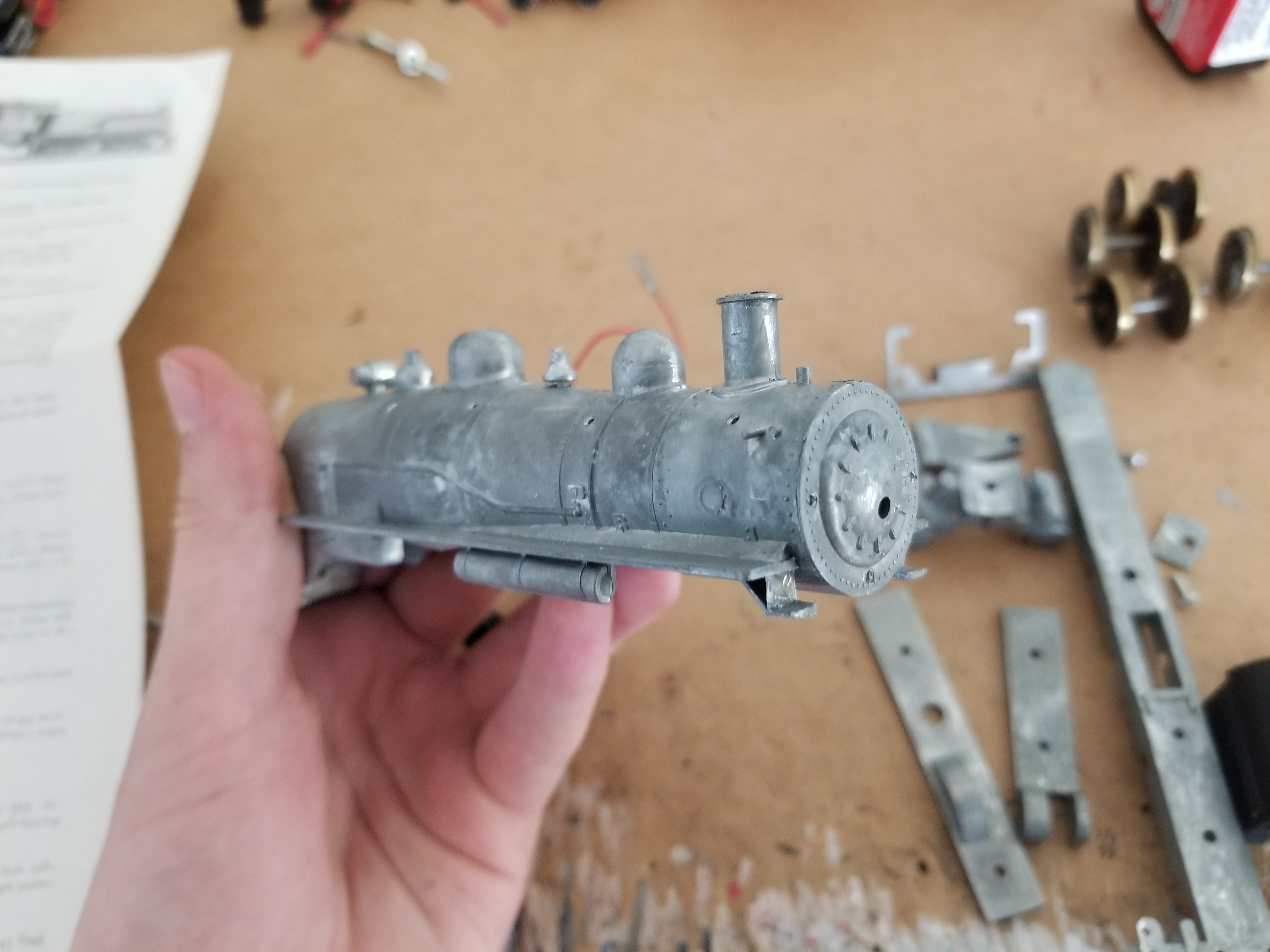

The 2-8-0 kit arrived in the mail today. Everything looked complete and in order so I set to work. First order of buisness was to deflash everything. And oh boy, is there a lot to do! I spent about 45 minutes removing the flash from the metal boiler, cylinders, frame, and the sprue joint on the cab. Everything looks pretty good now. I'm going to begin assembling the chassis as it says in the instructions.
I did accidentally break off one of the metal nubs for I think the marker lights (I think you can see it on this side). But hopefully I wont run into trouble without it. I'll also have to see how the headlight looks if I want to fill in the hole given and drill a new one for a more SP style low headlight. And as stated I'll be swapping out the tender for a Vanderbilt sometime in the future. I will assemble the loco, then disassemble, paint, and reassemble.
BlaxlandAlex3
Jupiterpfp2

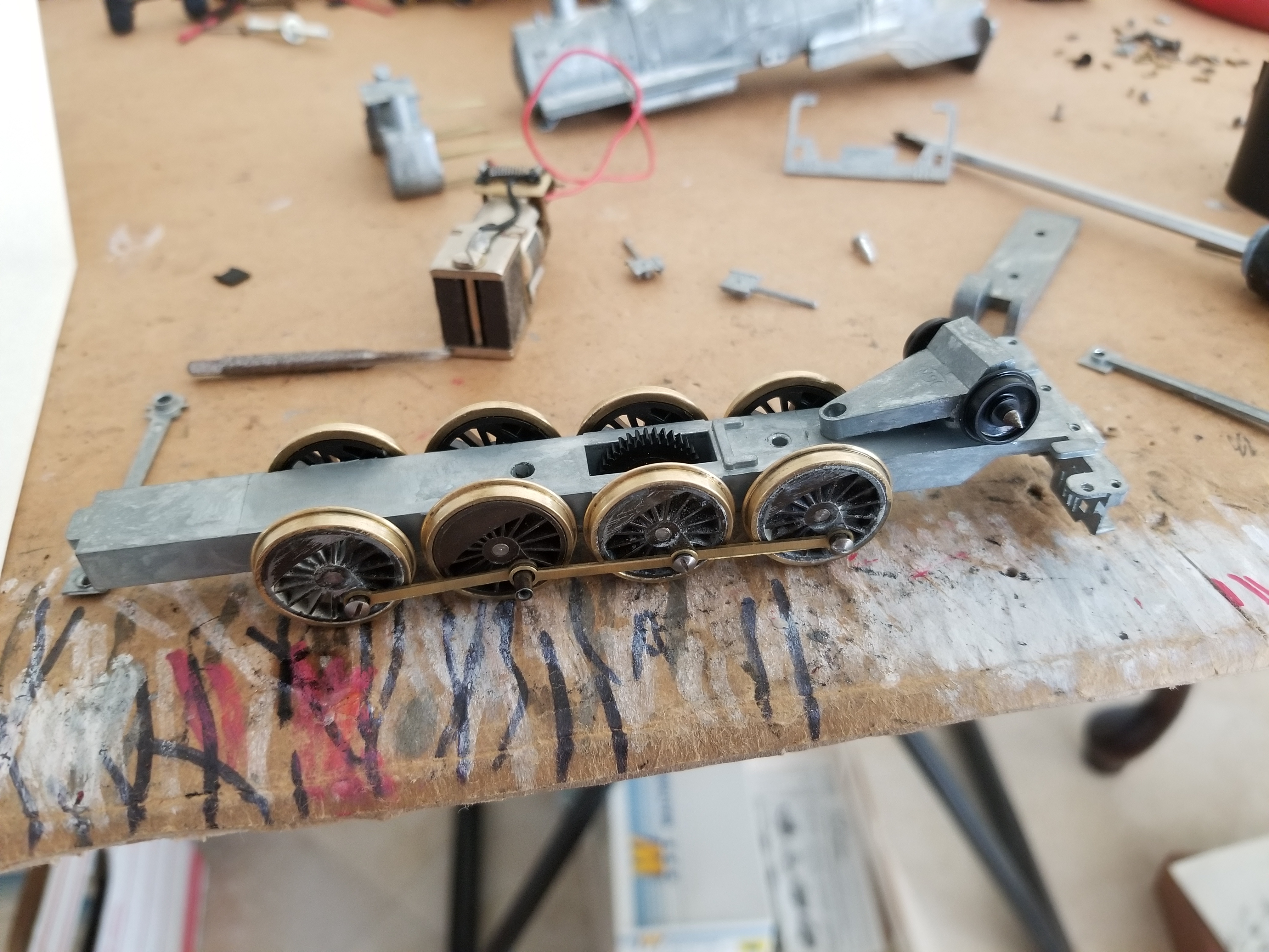

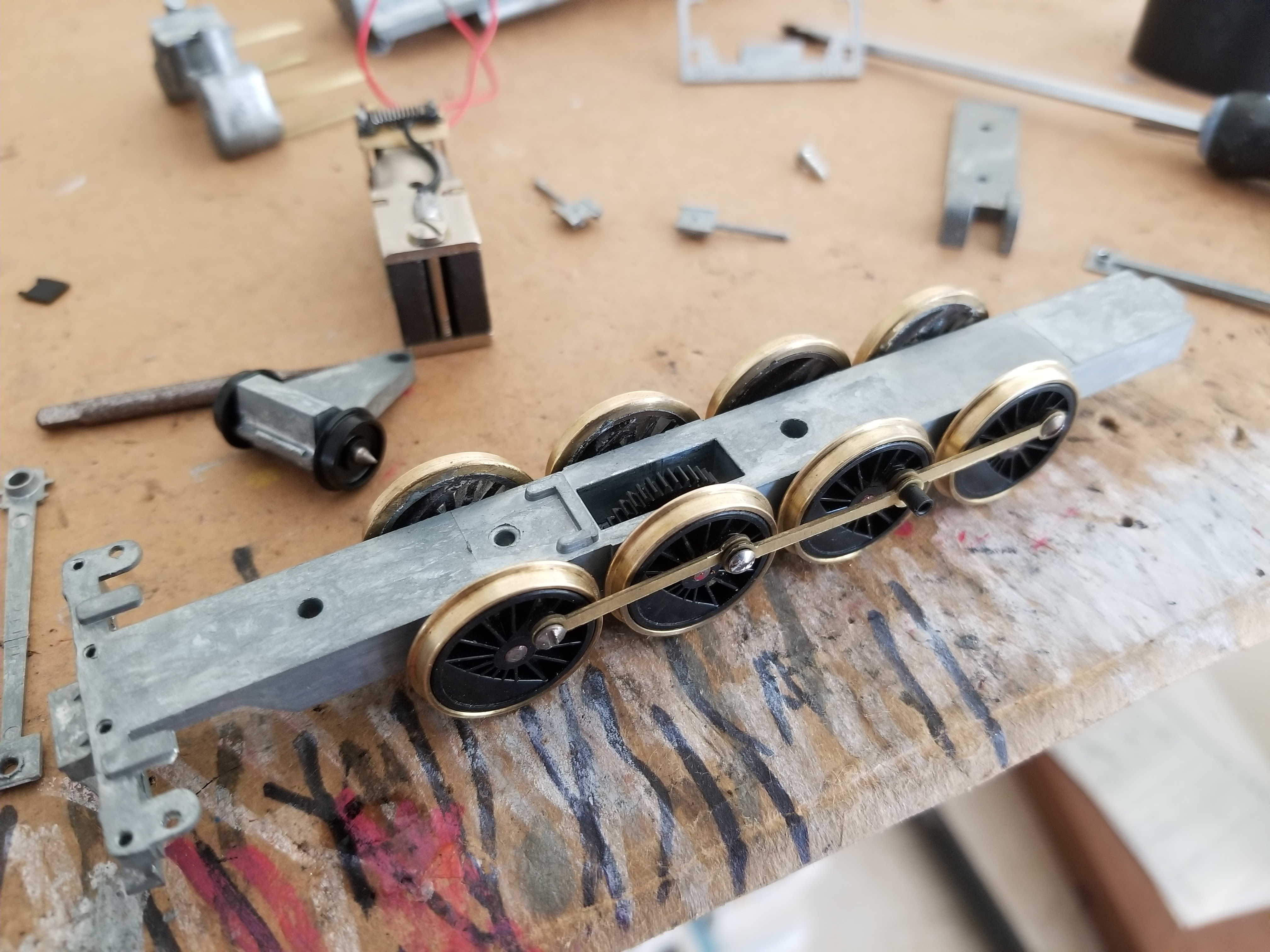

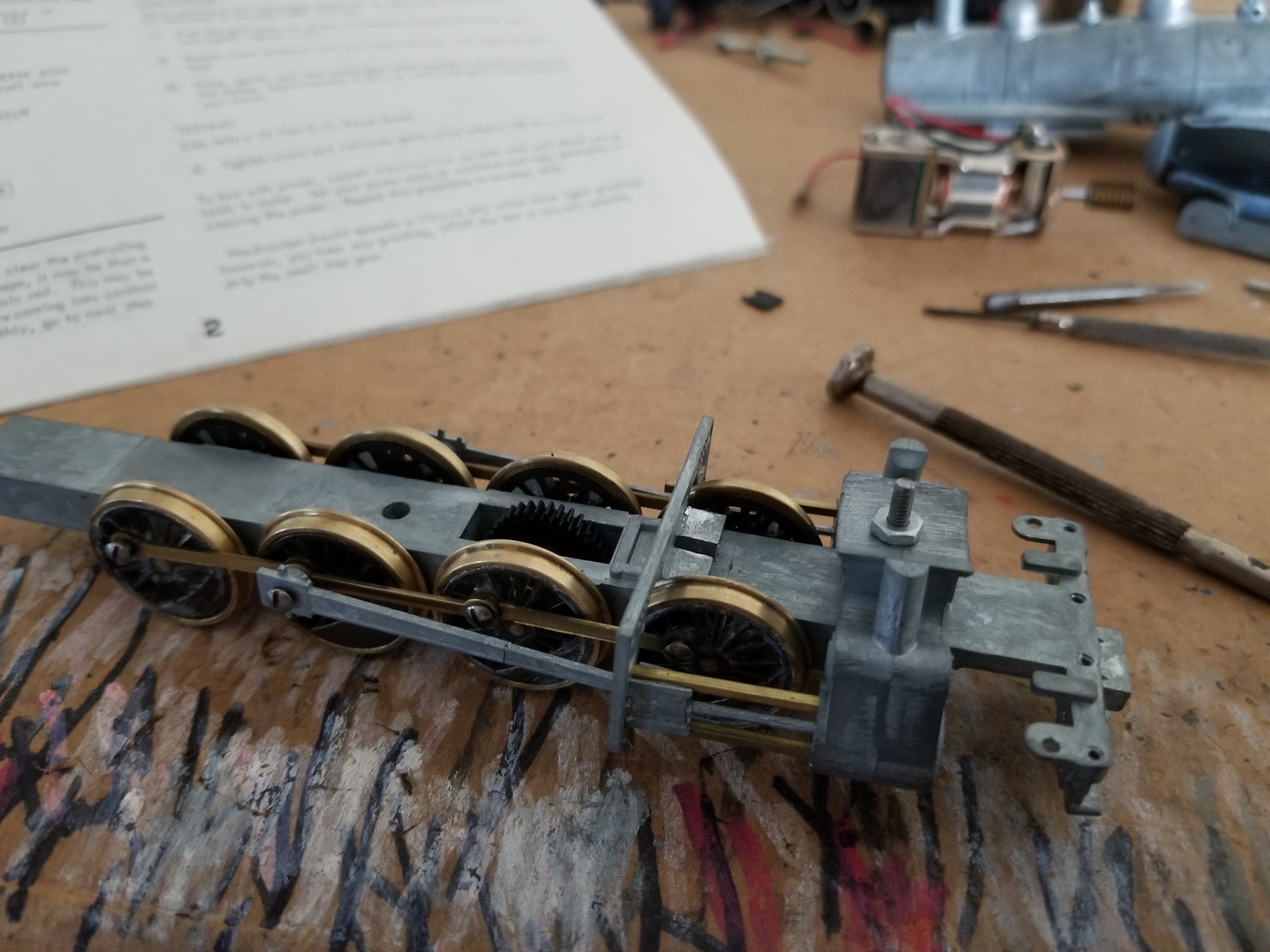

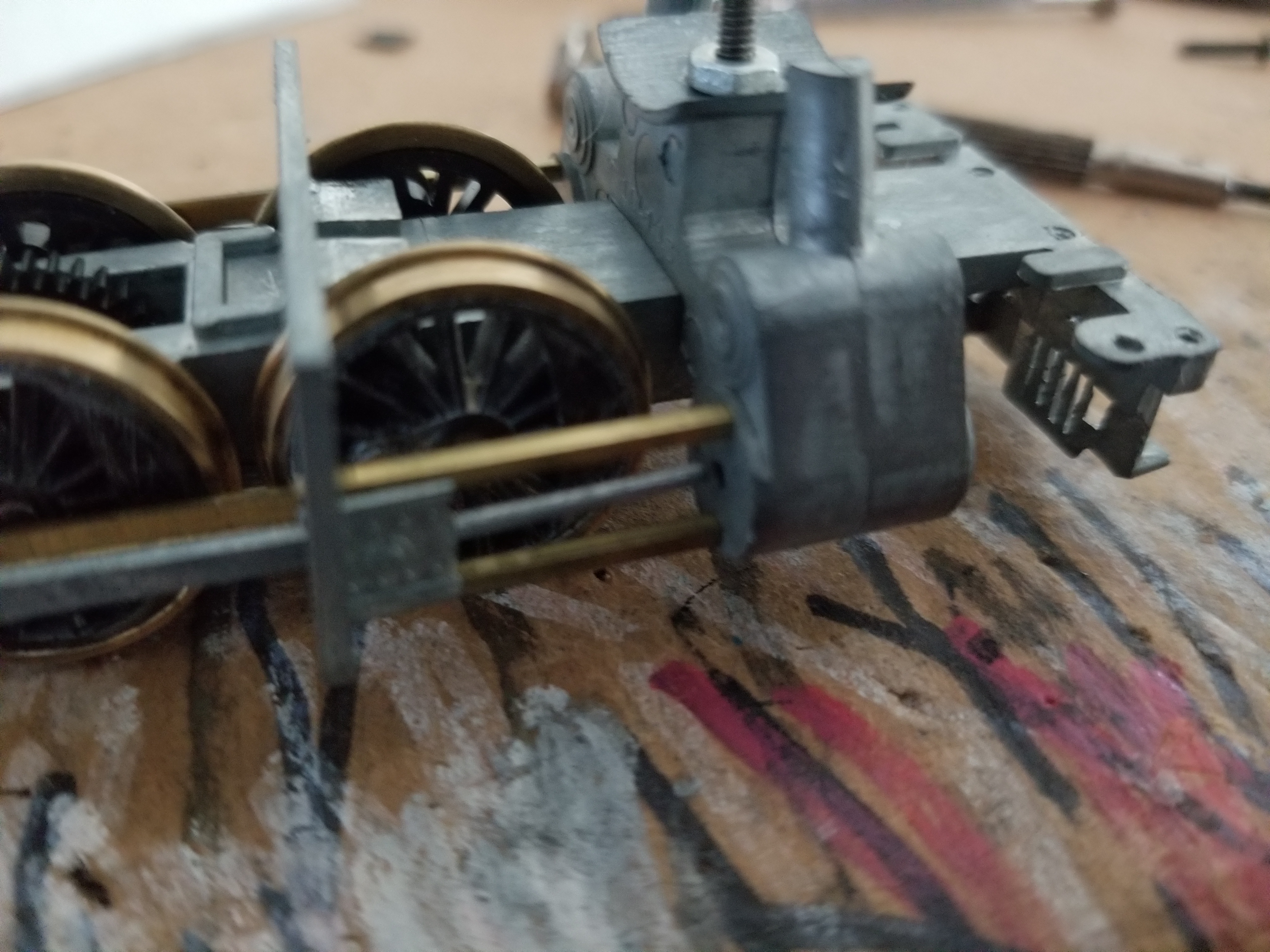

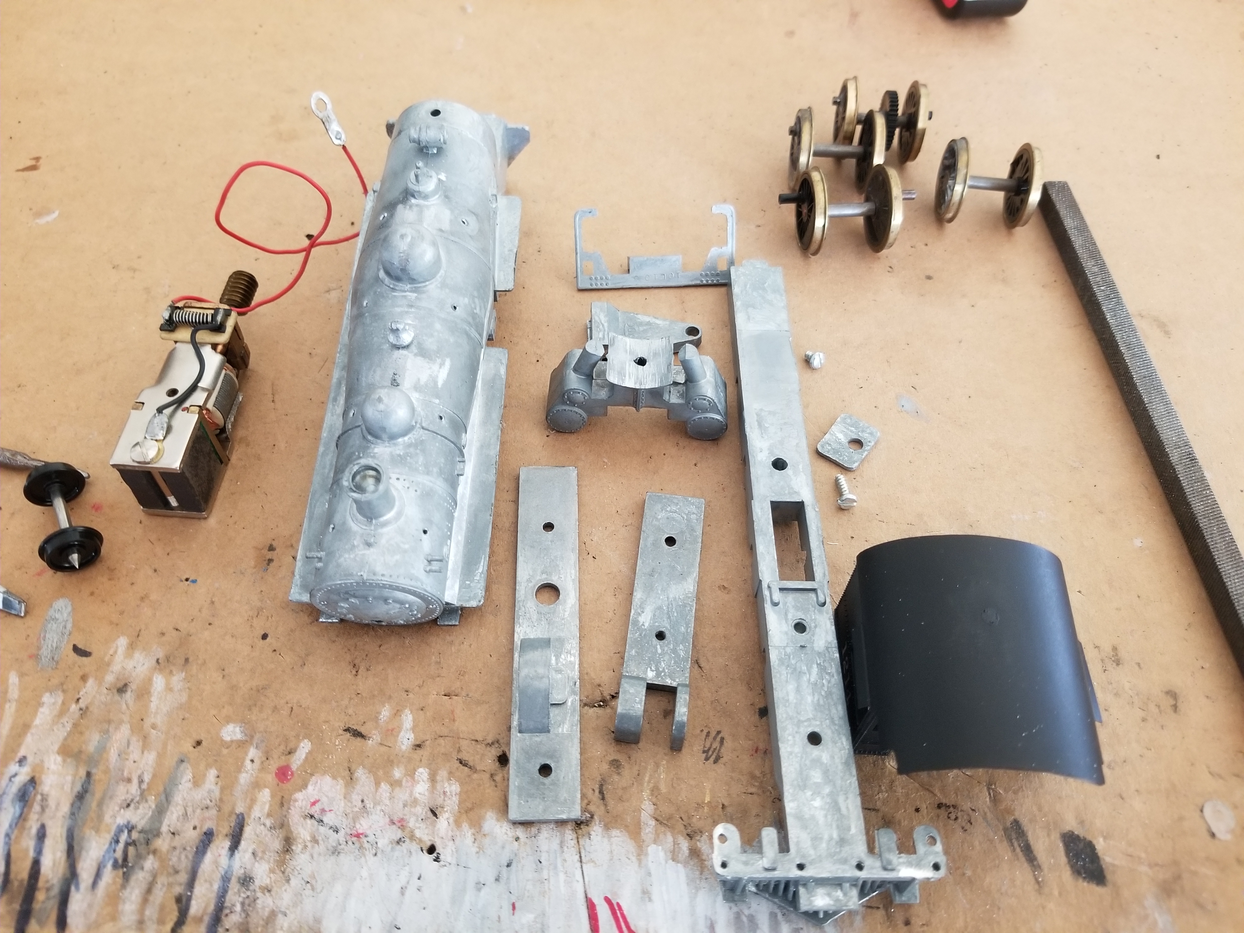

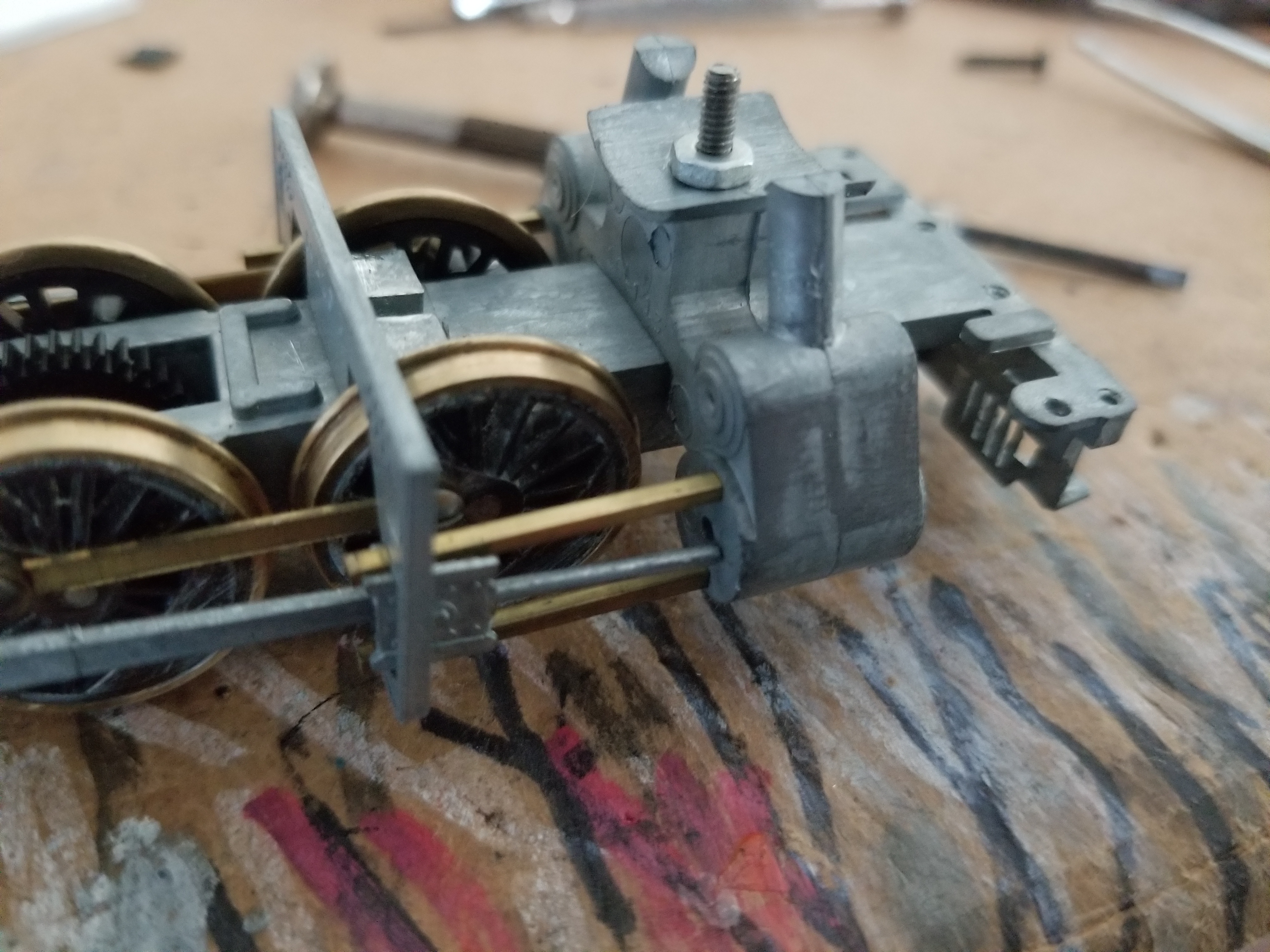

 Posted - June 29 2020 :  4:37:05 PM Link directly to this reply  Show Profile  Add BlaxlandAlex3 to Buddylist
Cant say I didnt think things would be smooth sailing! But then again, a smooth sea does not make a good sailor. Continuing work on the chassis, I screwed in the connecting rods.
So far so good. The wheels are rolling freely. However the trouble came when I put together the cylinder and yoke. I mated the cross head with the side rod, and tested it. Turns out, the crosshead bar thingy that goes into the cylinders is not long enough!
This isnt good. When it slips out, it then jams the mechanism. This is a simple fix, just a matter of gluing something circular to the end, but I will wait until the boiler is on. Maybe that will change something.
Then, I ran into the next issue! the screw used to fasten the yoke is too thin. This is also simple. Just a matter of finding a bigger screw.
I will try and fix these issues today so I can hopefully move to the body tomorrow.

 Posted - June 29 2020 :  6:13:39 PM Link directly to this reply  Show Profile  Add BlaxlandAlex3 to Buddylist
Also if anyone has any tips or tricks on how to improve this engine, I am all ears. Fixed the yoke/ crosshead problems but now the motor jams when it comes in contact with the idler gear. I've checked it over, loosened up things but it just full on jams. When I turn the gear with my hands it feels loose enough, I dont know what the issue is! Help!
 Posted - June 29 2020 :  7:08:52 PM Link directly to this reply  Show Profile  Add scsshaggy to Buddylist
If the mesh isn't right between the worm and the idler gear, you might get that:
If the worm barely touches the idler gear, it might sometimes try to skip a tooth and jam. At the opposite extreme, with the threads of the worm scraping the bottom of the idler gear teeth, you could come to a point on the gear where it's just too tight to turn.
You can engage the gears more deeply by shimming the back of the motor up, or not as deep by shimming up the front of the motor.
With the motor mounted, look closely at the mesh between the worm and the idler gear and see if either is the case.

 Posted - June 30 2020 :  08:22:59 AM Link directly to this reply  Show Profile  Add BlaxlandAlex3 to Buddylist
I ended up fixing the issue. Turns out it had nothing to do with the gears at all, but the screw that holds the motor to that plate! The screw was too long and would jam the armature! Substituted a very short screw and she took off down the rails. Testing the boiler also fixed the crosshead issue.
However gear meshing could be better. Things feel a bit tight. I'll try some slips of paper in front and rear of the motor and see if it does anything.
- I am going to fill in the original headlight mounting hole and drill a new one, lower, for a more prototypical SP style headlight
- I am going to try and get some more wire (I'm out) to try and make the handrails the wrap around the smokebox front.
- I am going to change the marker light mounting setup to be somewhat like the way Redwoods did on his 4-6-0

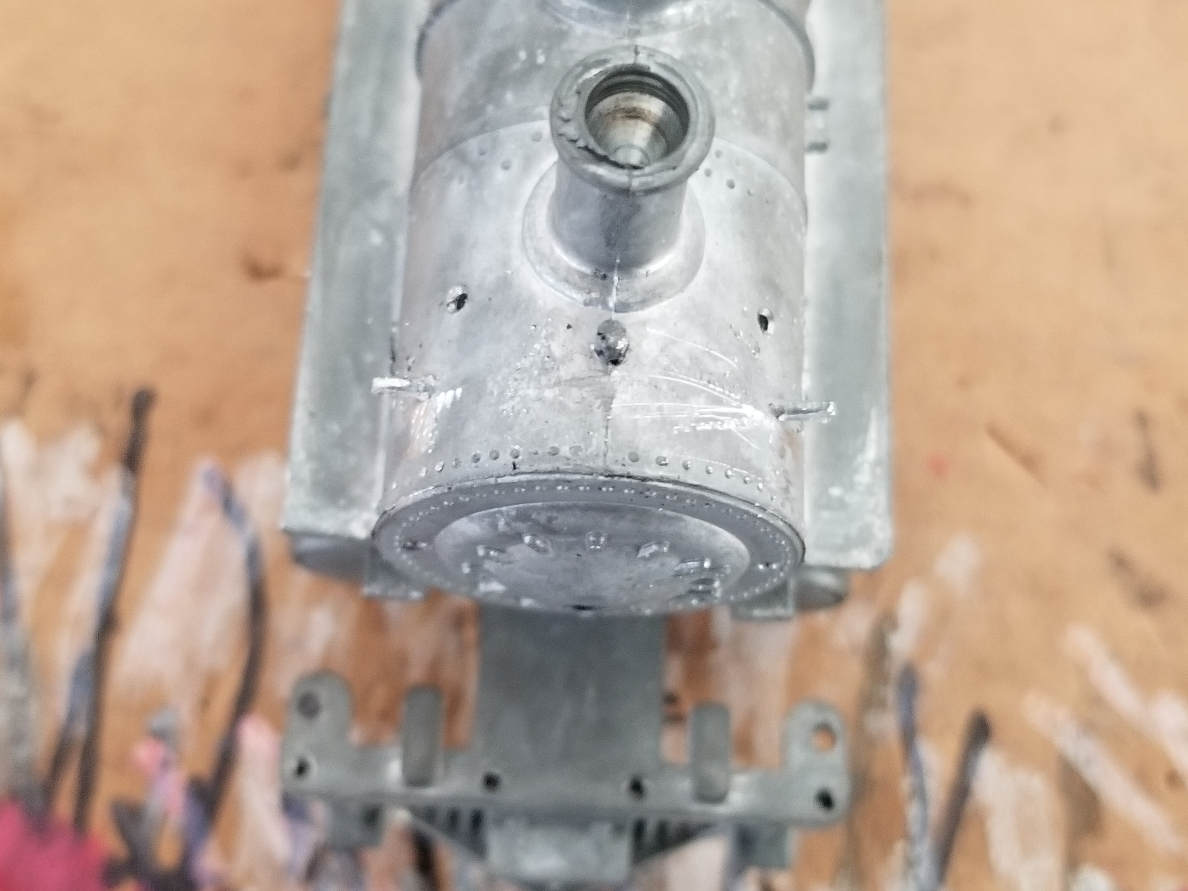

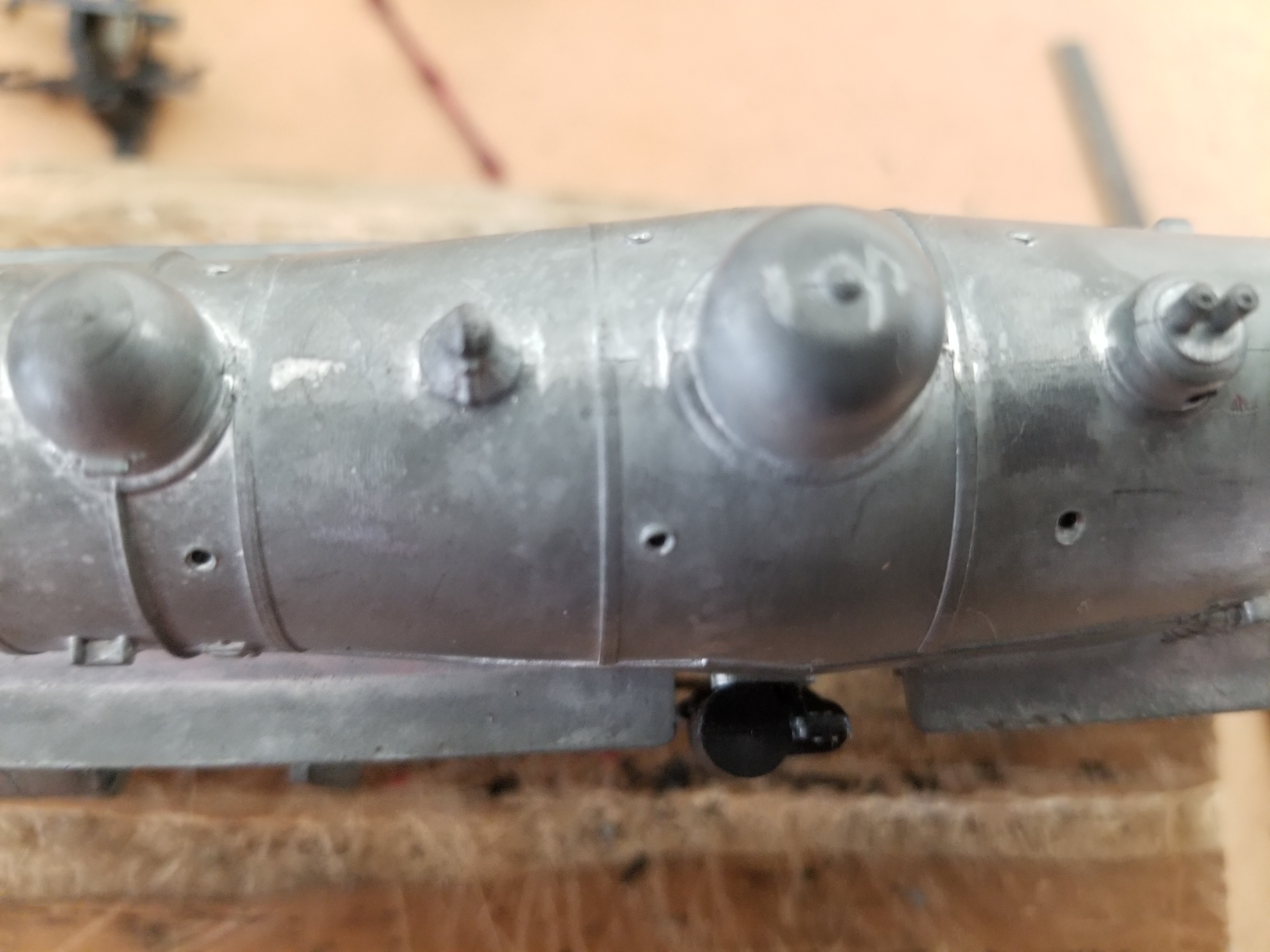

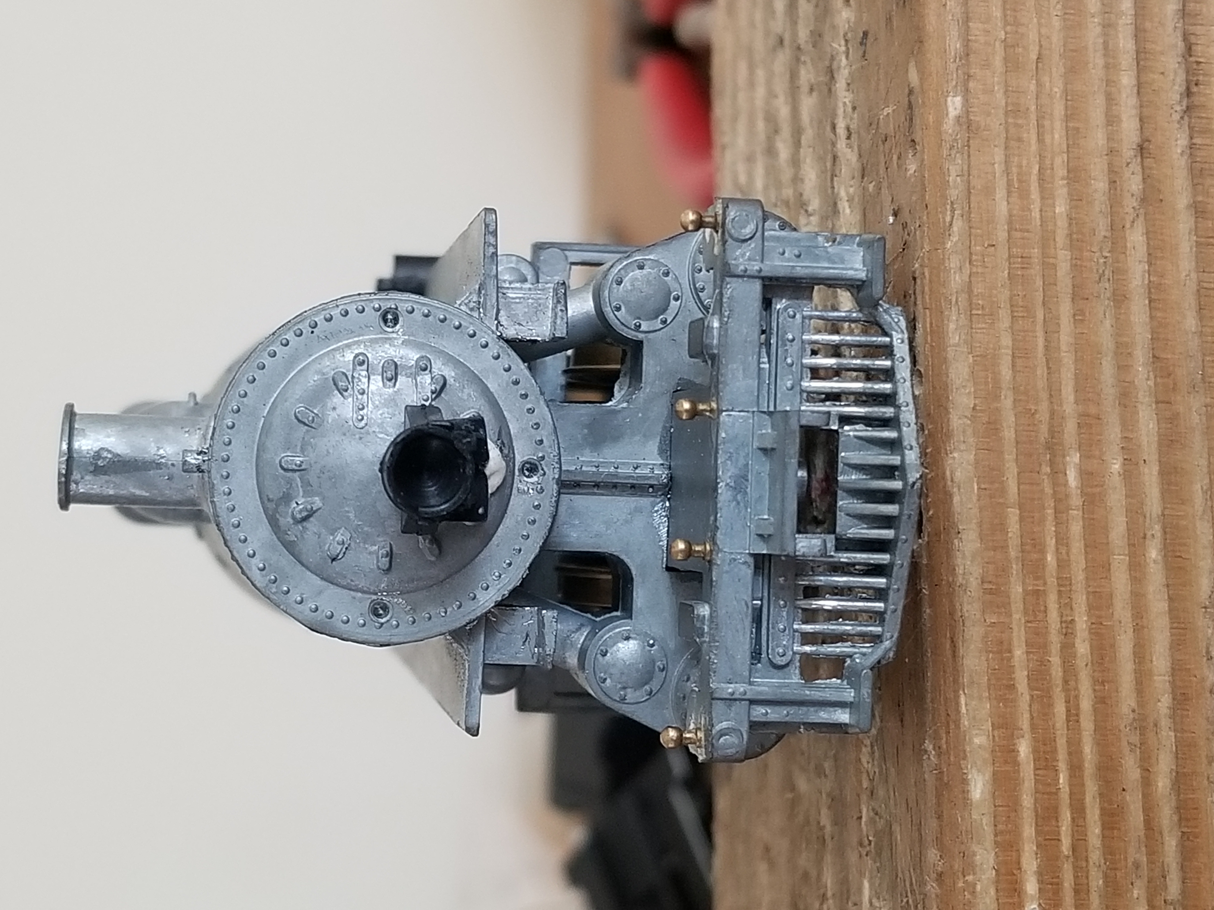

With the chassis assembled, it's time for the body. I installed the compressor and hatch on the roof of the cab.
This headlight arrangement was too high, so I decided it was time for putty. I filled in the old hole and drilled a new one. I also filled in two small metal pits, and the holes for the pilot steps. I had accidentally cut off the steps mounting holes so I'll just glue them onto the putty. I also installed the coupler cut bar stanchions.
Now THAT looks more ESPEE! (I have some clay holding it in place until I glue it)
The holes I filled
Here I was deciding whether or no to keep the marker light posts. After looking over prototype photos I determined the markers are father towards the boiler front. I ended up filing them all off. I will make new ones out of wire.

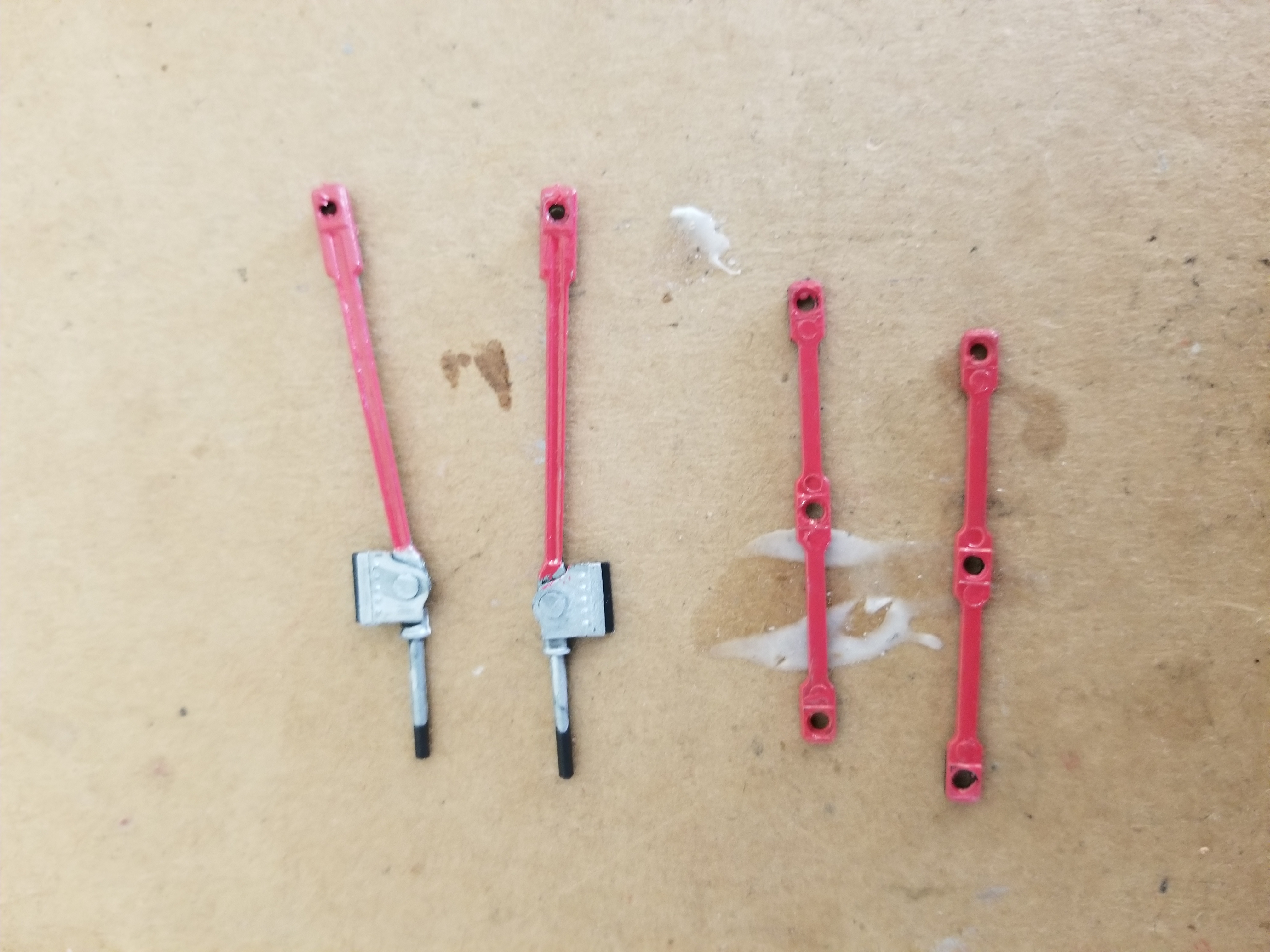

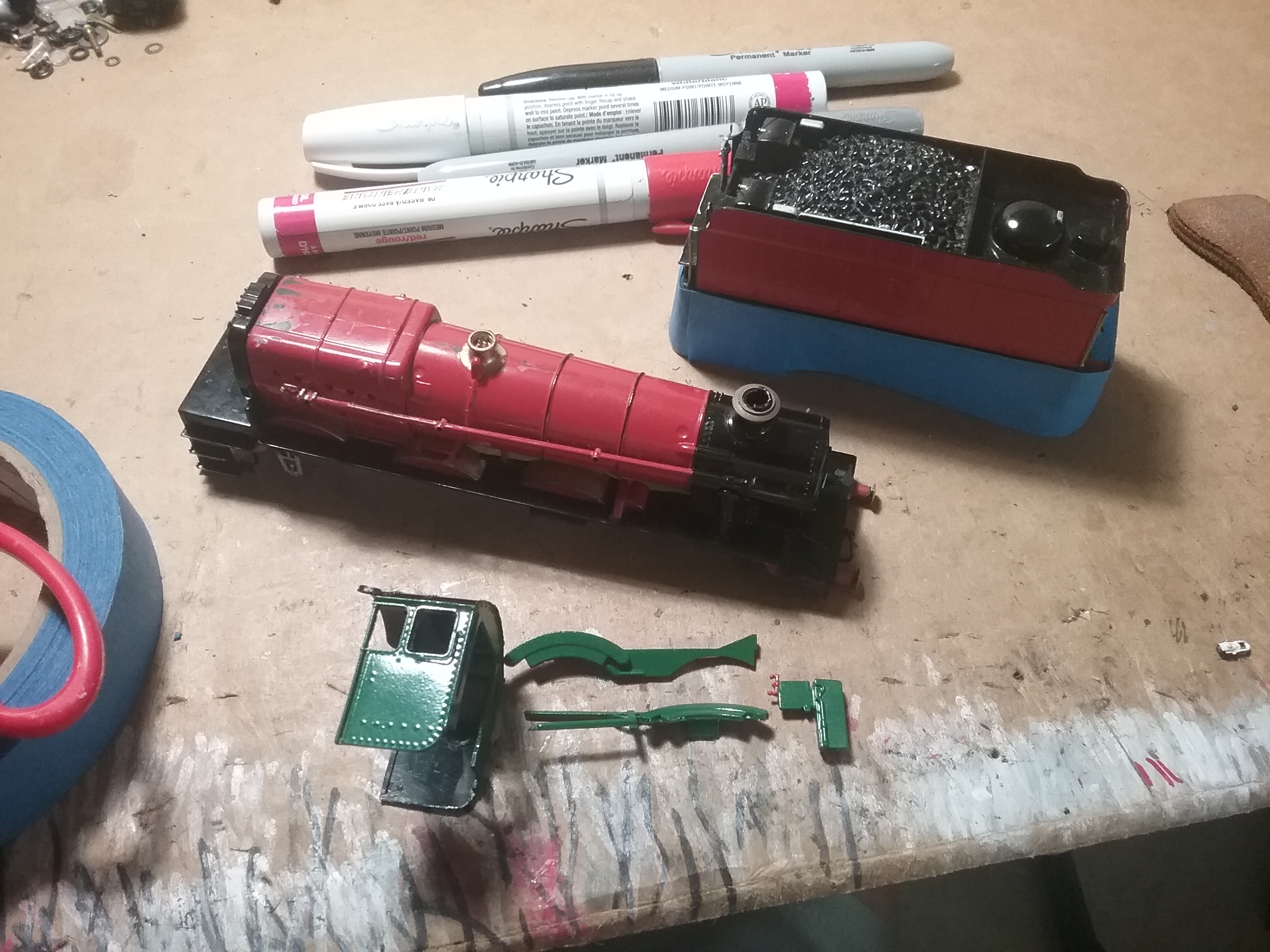

So in between getting the final walthers coil cars done for brian, I worked a bit on the Brazilian 4-6-0. I havent broken down into the project yet but have done some minor things.
Here I began painting the rods red. The crossheads are red now as well although they are shown to be silver in this photo.

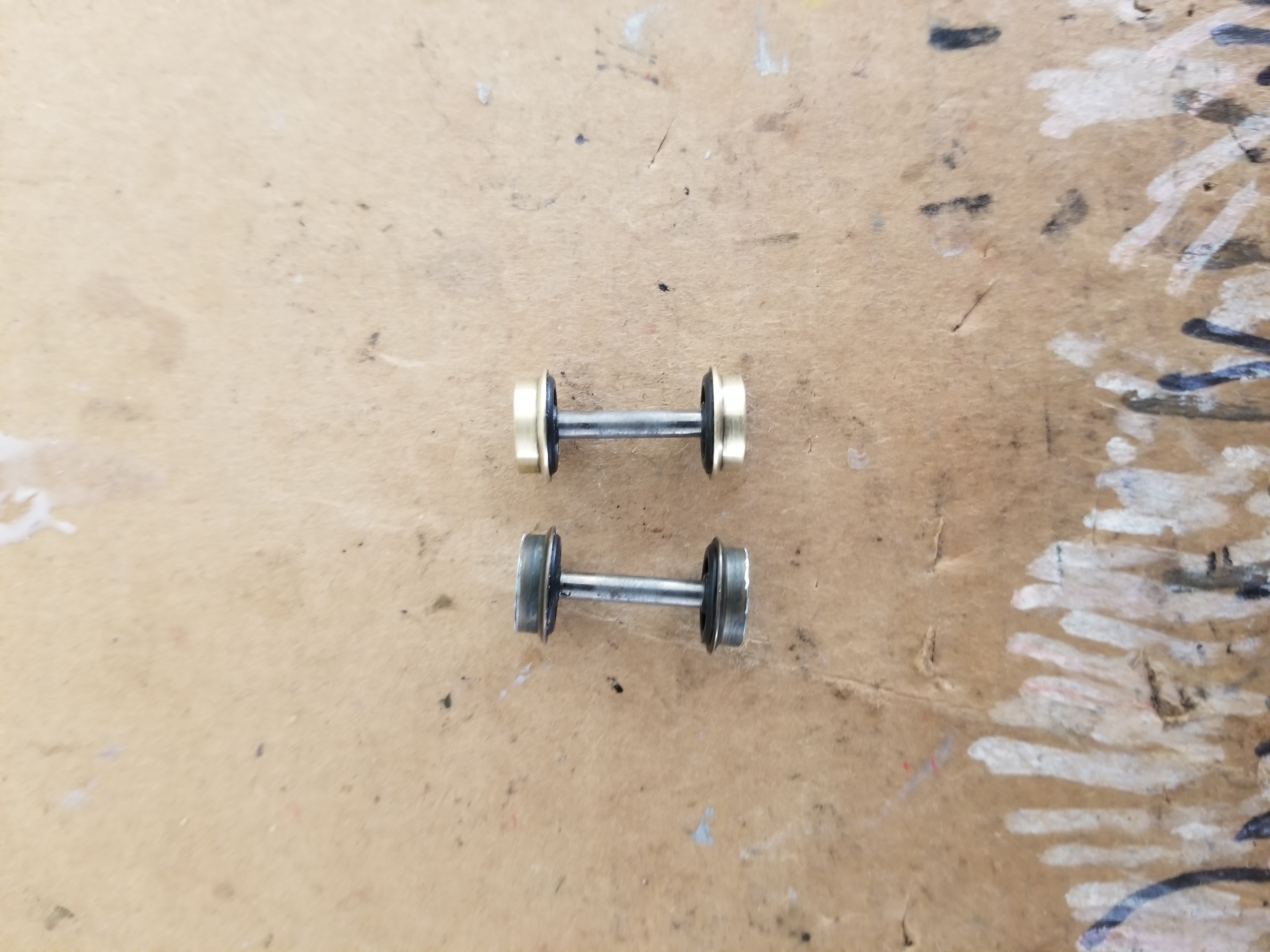

I also cleaned the wheels. Here is a comparison. Yikes!
As of right now I have only cleaned the pilot truck wheels. The way the loco and tender chassis are designed it appears they dont want you to take the wheels out. It's like a split frame that doesnt really split I can still clean them, itll just take longer. However I wont be able to clean the contact that goes to the drivers. Oh well.
The tender, loco, and cab shells were soaked in brake fluid to strip the paint. However the quality of this paint was astonishingly good that it may need to get stripped again.
I hate stripping paint!
My friend maverick who does ww2 modeling has some NATO green airbrush paint which looks pretty good for the green color I want. It also will be useful as GWR green but that is a project for another day he said he will let me borrow it if I solder some things for him. A done deal in my opinion!

Got the handrail wire I needed and bent the rails. Looks pretty good after some tweaking!
I threw the other parts together for pictures. We might be ready for the paint shop after some final adjustments!
In the background you can also see the Hall class which is pretty much done with its repaint aside from putting the body back together and touch up. The problem is that stupid cab isn't going back on properly so I might have to modify it a bit. Not sure why it isn't going back on right.

With some adjustments of the gear mesh and the completion of a coupler cut bar I started painting. The yoke, cylinders, pilot truck casing, and bottom plate are being painted black. The frame and boiler have been primed. She's coming together!
The hall class repaint is essentially done. Just fiddling around getting it all back together!
