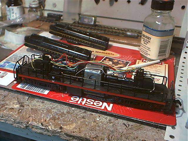

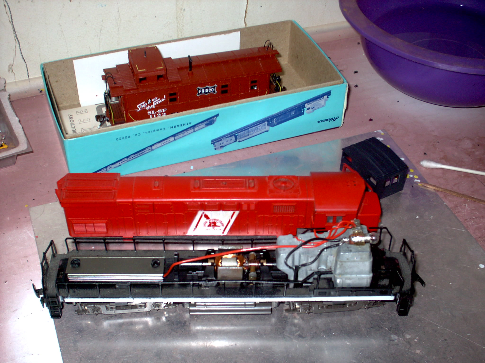

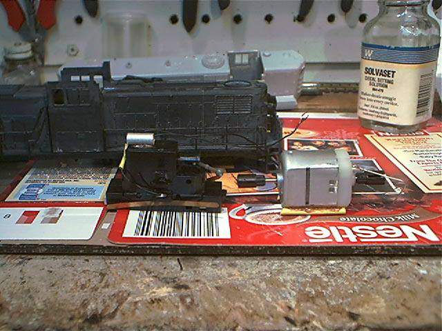

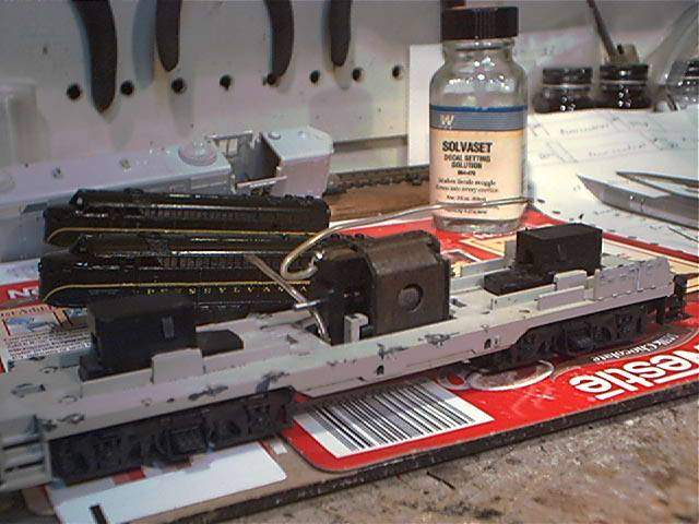

Here's a photo of the dual drive Model Power RS-2 chassis.
This is an AHM GP-18 I am piecing together.
These are from an IHC C-415. The motor and driveshafts were improved but the truck gearboxes are the same as the MP RS-2 and AHM GP-18
Ray
