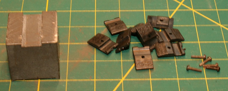

This kit consists of a cutting jig, screws, clamps, and detailed instructions...
Note: I forgot to take a picture of the kit when I first opened it, the above
picture is an approximation of what was in the kit.

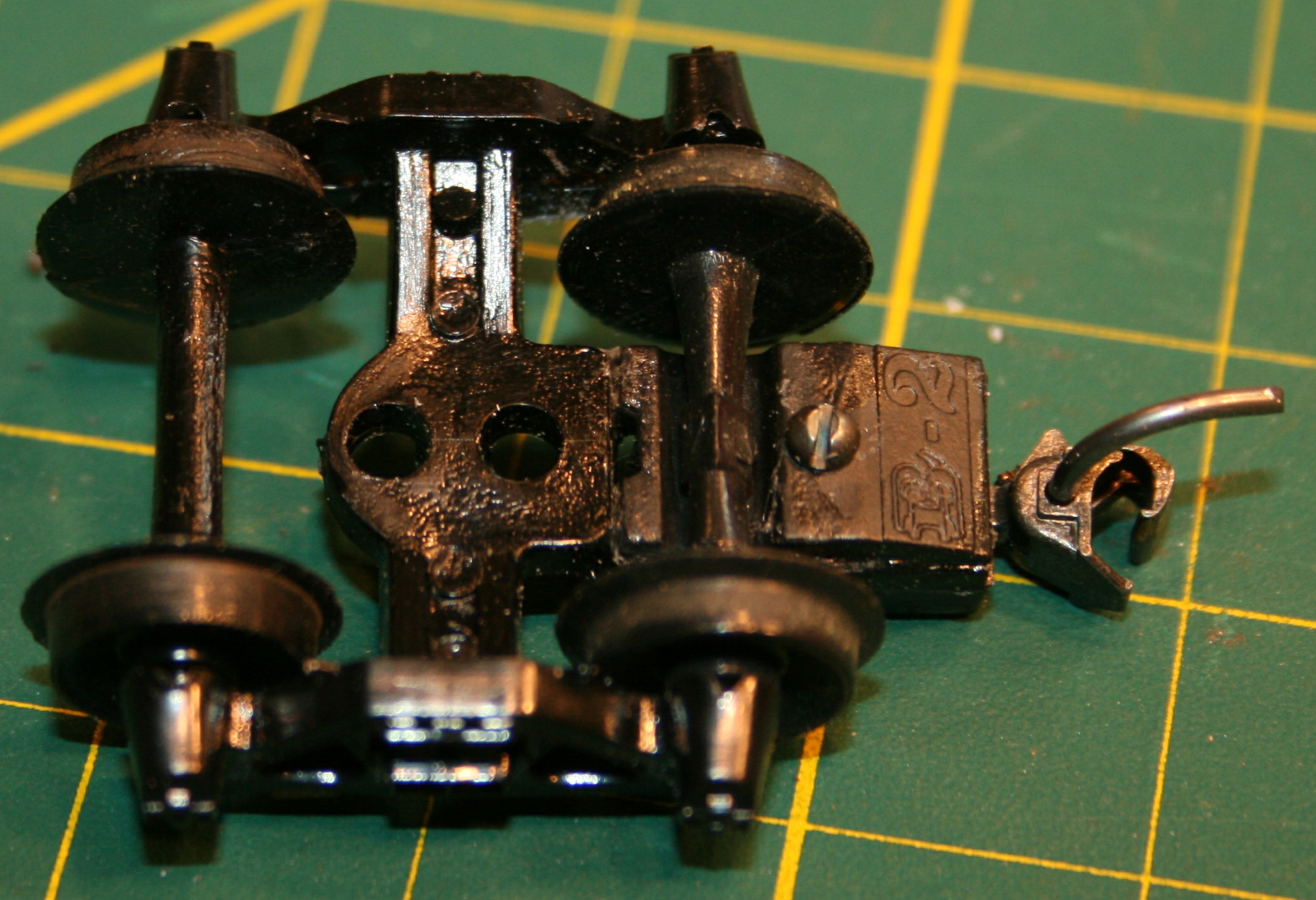

As you can see from the instructions, the jig in this kit is used to modify Talgo
style trucks used by Tyco, Life-Like, and others to accommodate Kadee draft
gear and couplers.
This is how the process works...

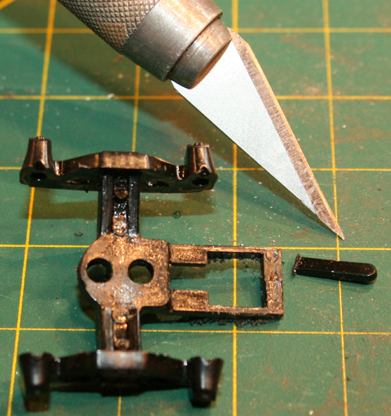

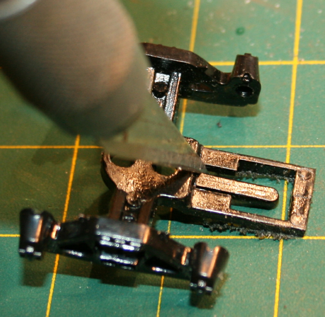

Step One: After removing the wheel sets, cut off the "Pin Bar"

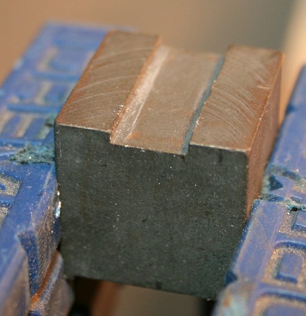

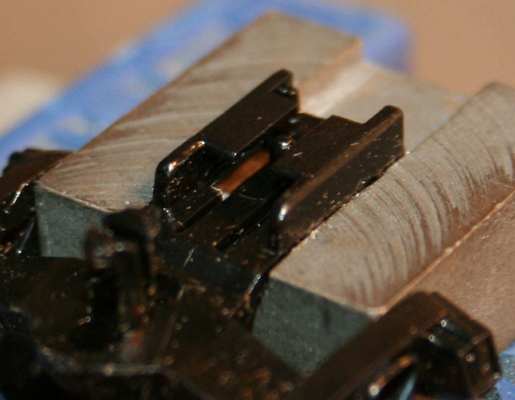

Step Two: Secure the steel cutting jig in a vice...
Step Three: Place the truck in the jig...

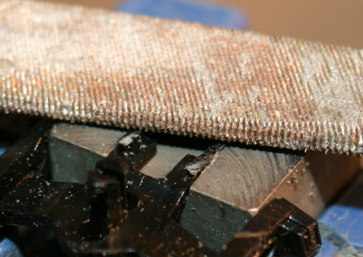

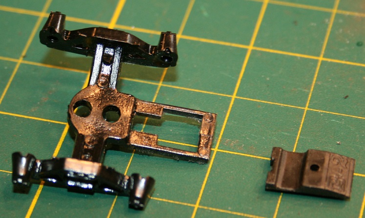

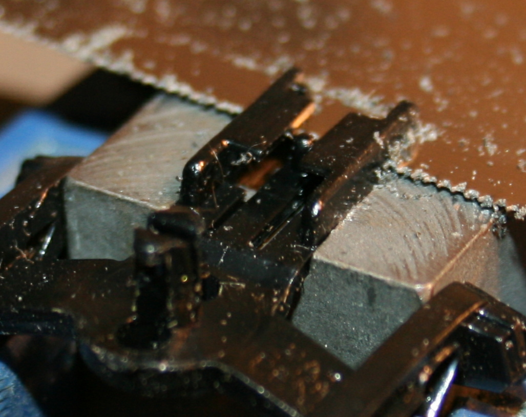

Step Four: Using first a razor saw and then a file, trim down the the truck's "hitch assembly" level
with the surface of the jig....

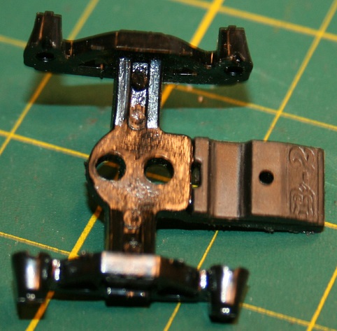

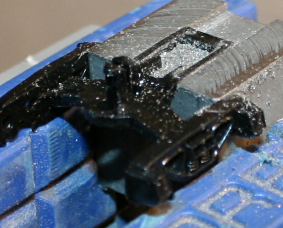

Step Five: Glue the "Clamping Unit" to the underside of the "hitch assembly"...

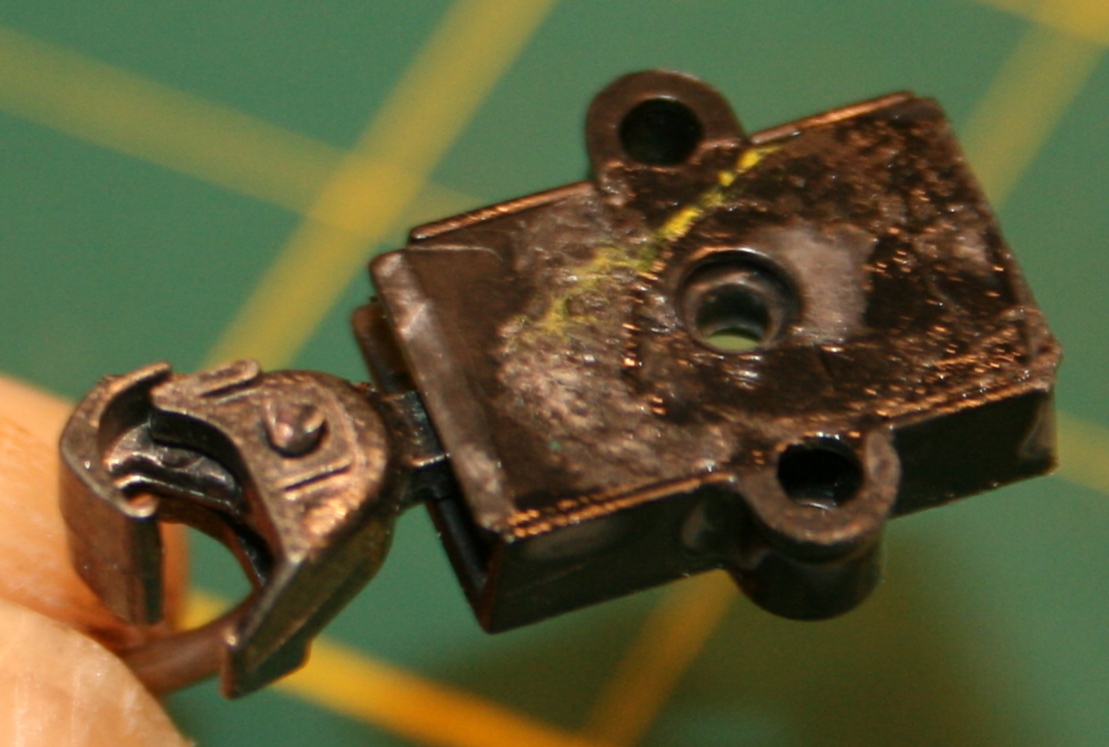

Step Six: This kit is designed to use the Kadee # 9 coupler draft gear (Kadee #9 couplers

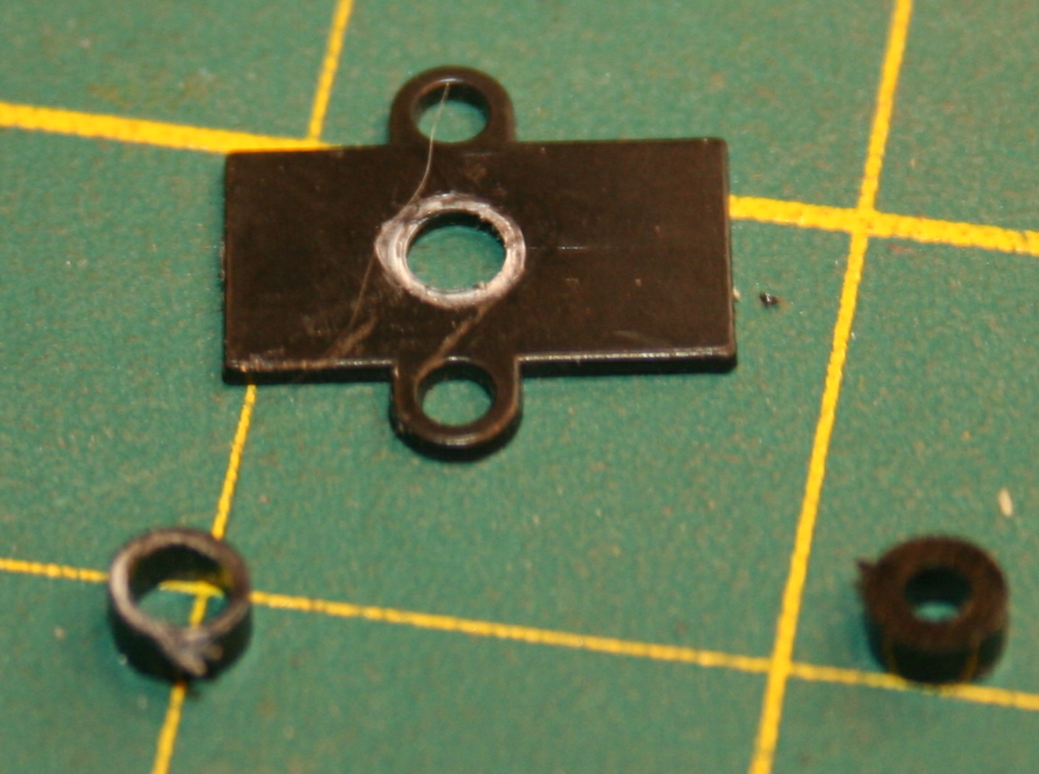

are the same as #5 but the center hole in the draft gear box is smaller), but I modified #5 coupler draft gear
boxes for this project. To use the screws that come with the kit I had to replace the centering
post on the draft gear top plate with a new one with a smaller hole...
Step Seven: Assemble the coupler draft gear box....

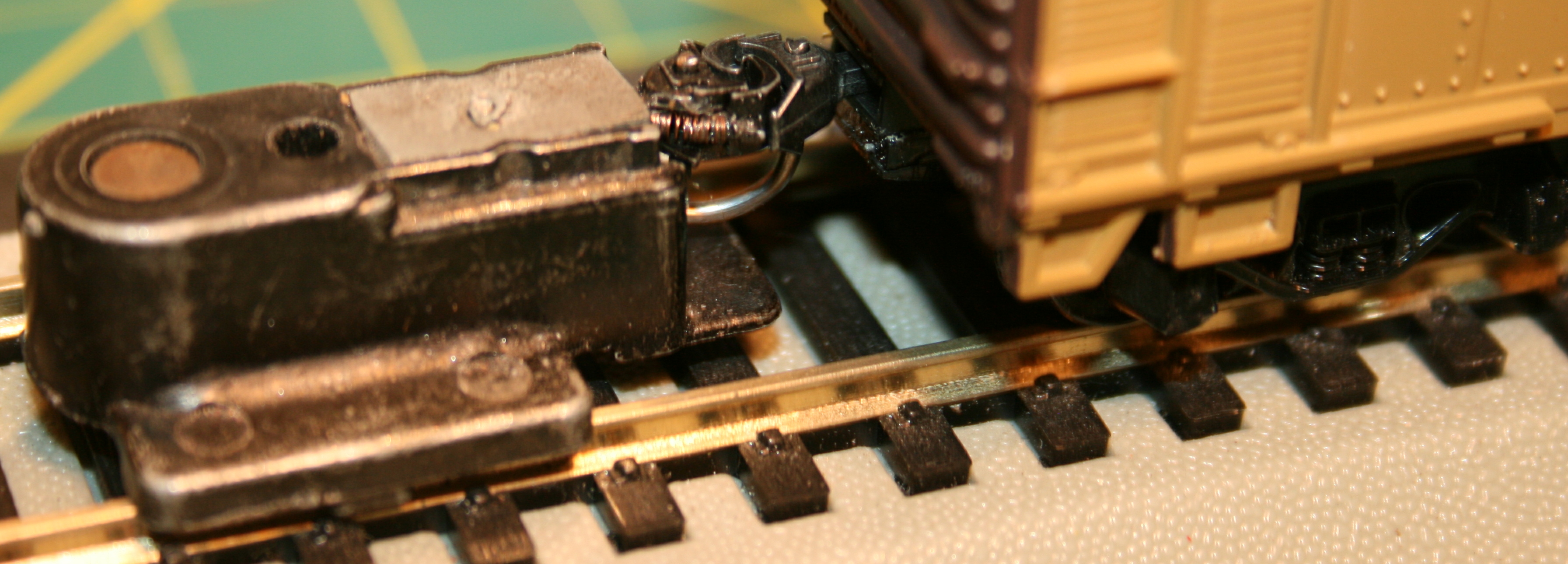

Step Eight: Attach the Kadee draft gear box to the modified Tyco truck using
a screw supplied with the kit...

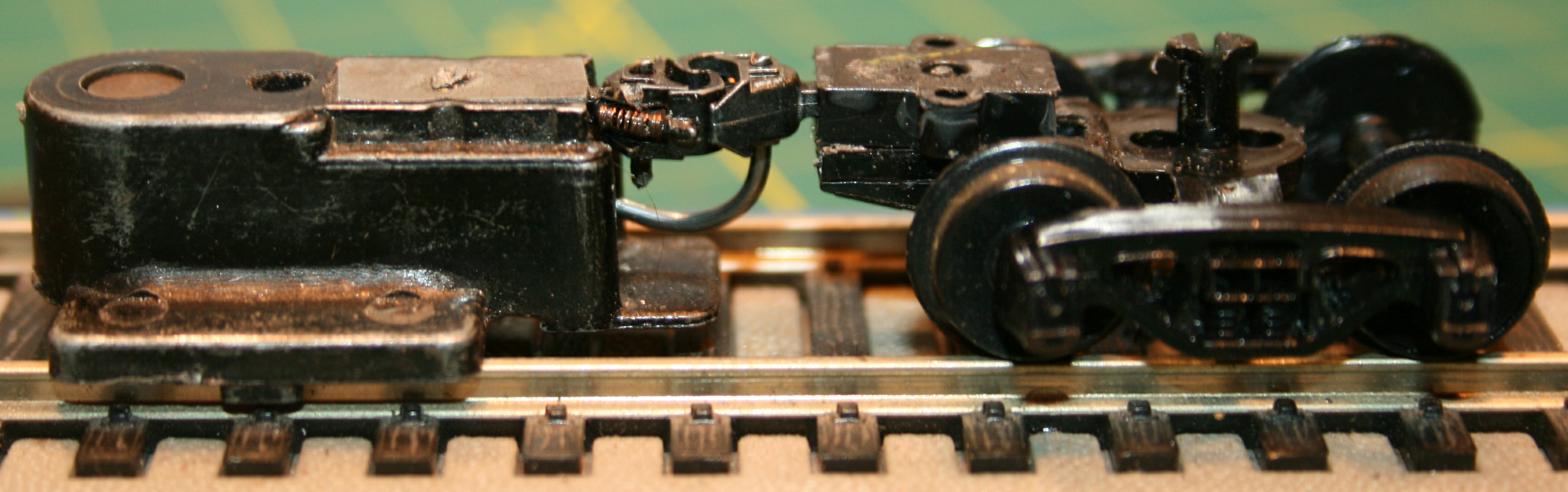

Step Nine: Put the wheel sets back into the truck and check the coupler height
with a Kadee height gauge, my sample's height came out perfect without any modification!!!!
Step Ten: Attach the modified truck onto the car...
In summary, this is a successful product that works as advertised,
I especially liked the fact that the height of the Kadees came out perfect
on the first try!
