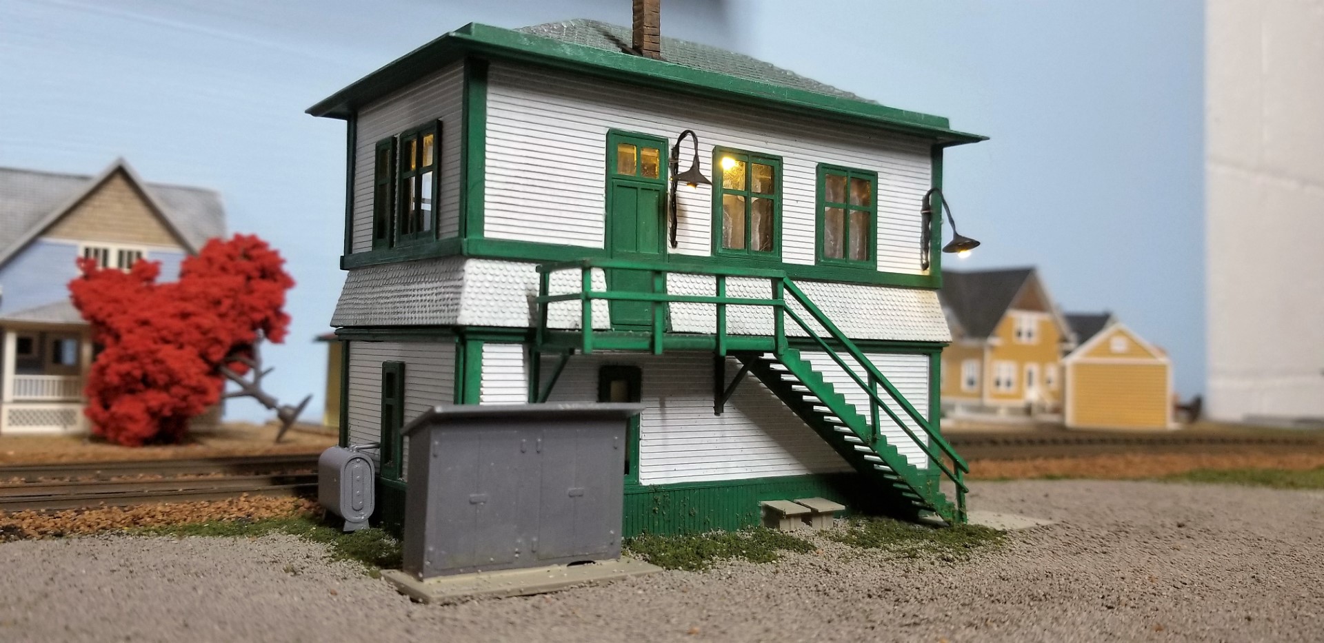

Whoa! That Matchbox truck alone looks incredible, along with the Signal Tower. Very realistic work here.

Awesome work! Love that interior on the signal tower and the kitbashed engine shed.

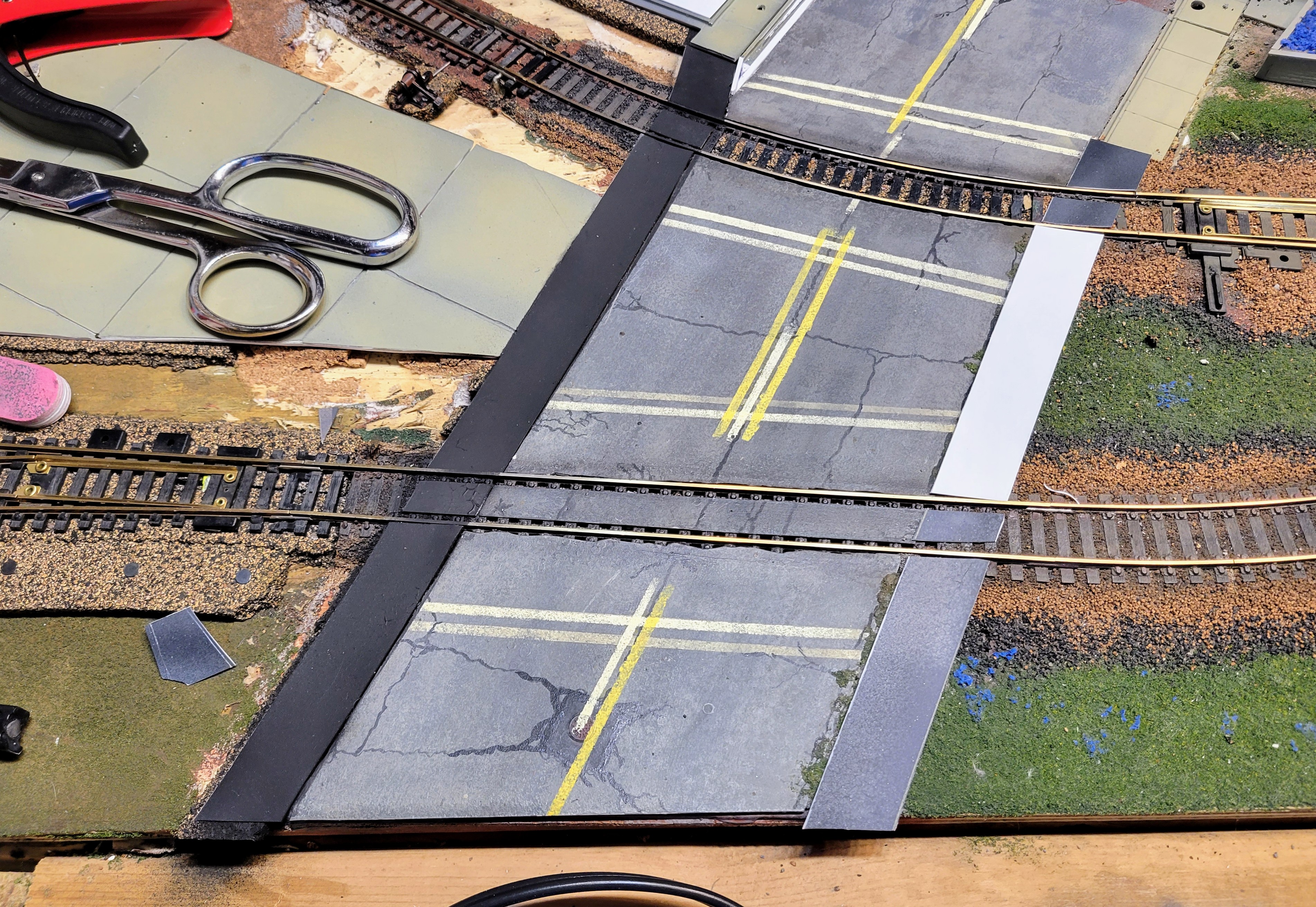

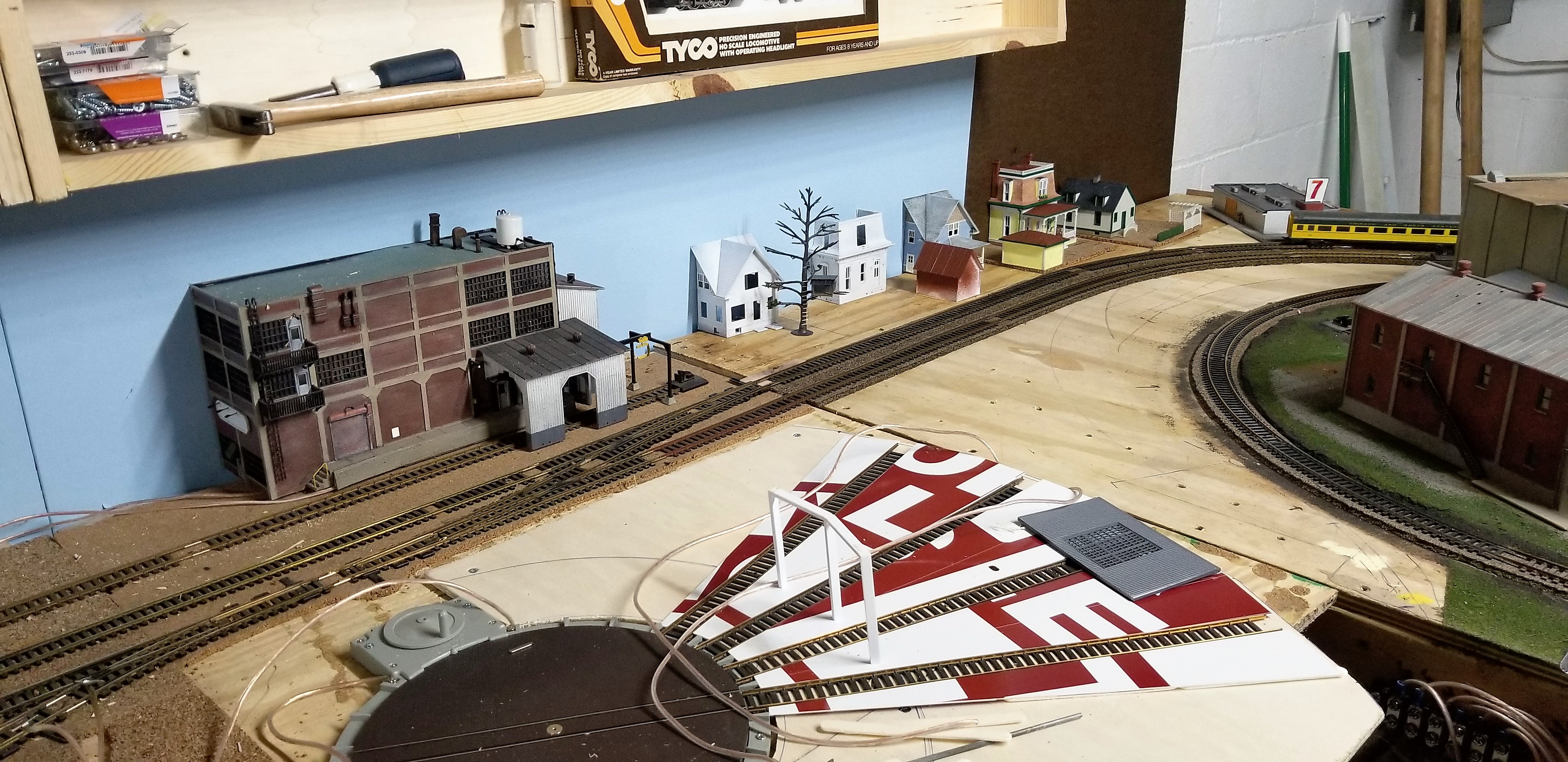

After a year of not touching the layout, I've decided to make some changes. I added a switch to make a larger loop. Switching was one thing the magazines said I wanted but it turned out I just like to run my trains In circles .
And I redid the crossing to add pedestrian access.
And the finished crossing. It still needs a crossing shanty. I want to build one like the TYCO animated crossing guard to put here that will match the one I got from Goodwill.

When I rebuilt Henley, one of my goals was to minimize switching on the mains. Switches tend to invite trouble, and I wanted things to run
without having to go back in and endlessly tinker trying to get them
right. Your road work is very impressive. Lot of frost heaves. I guess
Joe's infrastructure money hasn't hit town yet.

Looks great! I understand the affinity for just watching the trains run! I'm not sure if it's been said already, but what was your technique for painting the roads?

 Posted - February 01 2023 :  02:22:52 AM Link directly to this reply  Show Profile  Add Bamos to Buddylist
These roads are styrene and I stipple several different grays on to add texture and then drybrush with a light grey. My next roads I'm going to do with mat board to add the texture as the painting is time consuming. And the weathering is just artist chalks. I find it easier to not over weather things without the fixative in the chalk.

Chops part of the problems were the switches. I had painted them, and it was causing power problems, so I am going through and stripping the paint from the closure rails and joints. They may not look realistic, but they operate much better.
I am also going around and lowering the grade crossings and moving my station and freight platforms further away from the track to make cleaning easier.

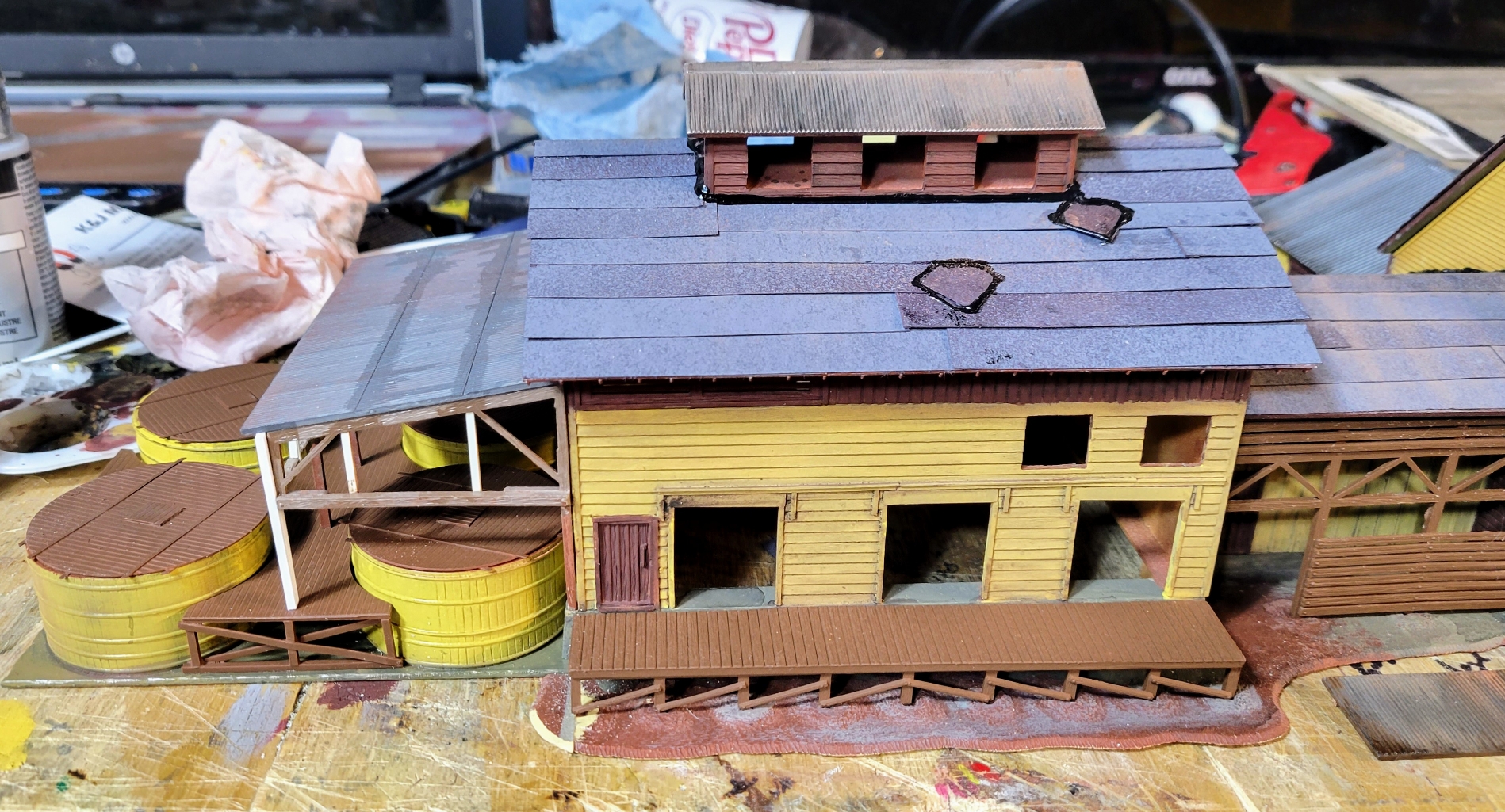

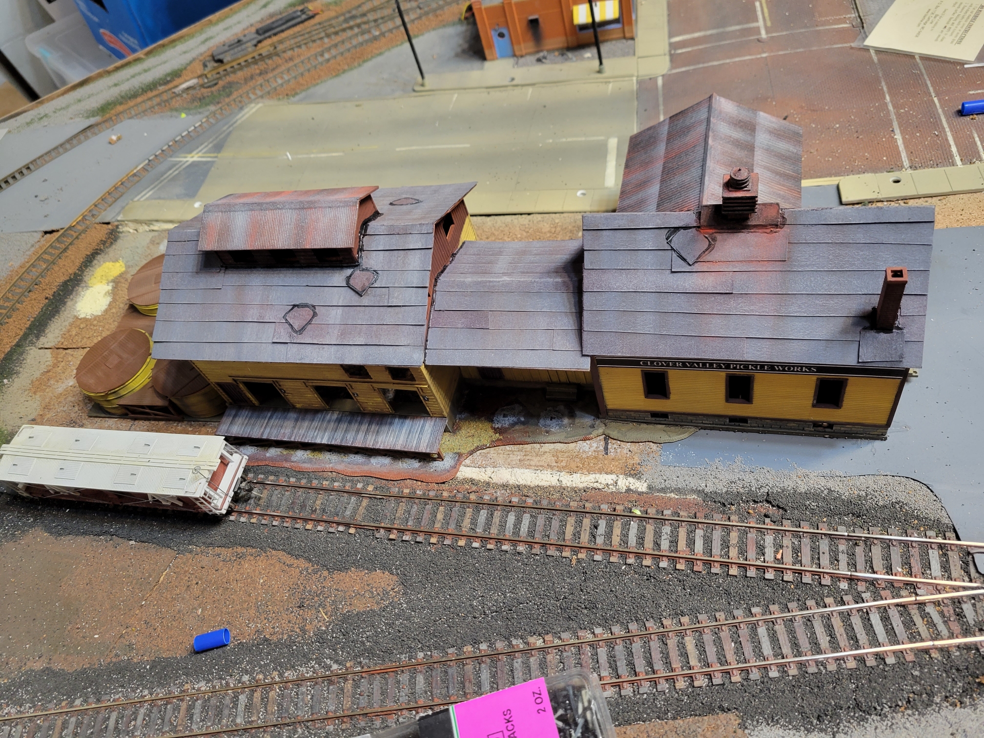

This is my project from the last two weekend's. It started as an old glue bomb Lionel building and a Walthers Electricorp Supply I picked for 50 percent off.

 Posted - February 08 2023 :  12:58:40 PM Link directly to this reply  Show Profile  Add microbusss to Buddylist
kinda looks like the Pickle Factory Model Power & other made
 Posted - February 11 2023 :  10:15:29 PM Link directly to this reply  Show Profile  Add RP model railroads to Buddylist
Good work, bamos! The detailing around the would-be replaced roofing is a nice touch.

 Posted - February 13 2023 :  07:16:03 AM Link directly to this reply  Show Profile  Add Bamos to Buddylist
Thank you RP. The roofing tar is Dollar Tree puffy fabric paint.
I had to stop on it to get some windows and details painted so since I was going to have the paint out I decided to work and some of the pickle cars. They weren't in very good shape when I bought them so I cleaned them up, made some repairs and scratch built some of the missing pieces.

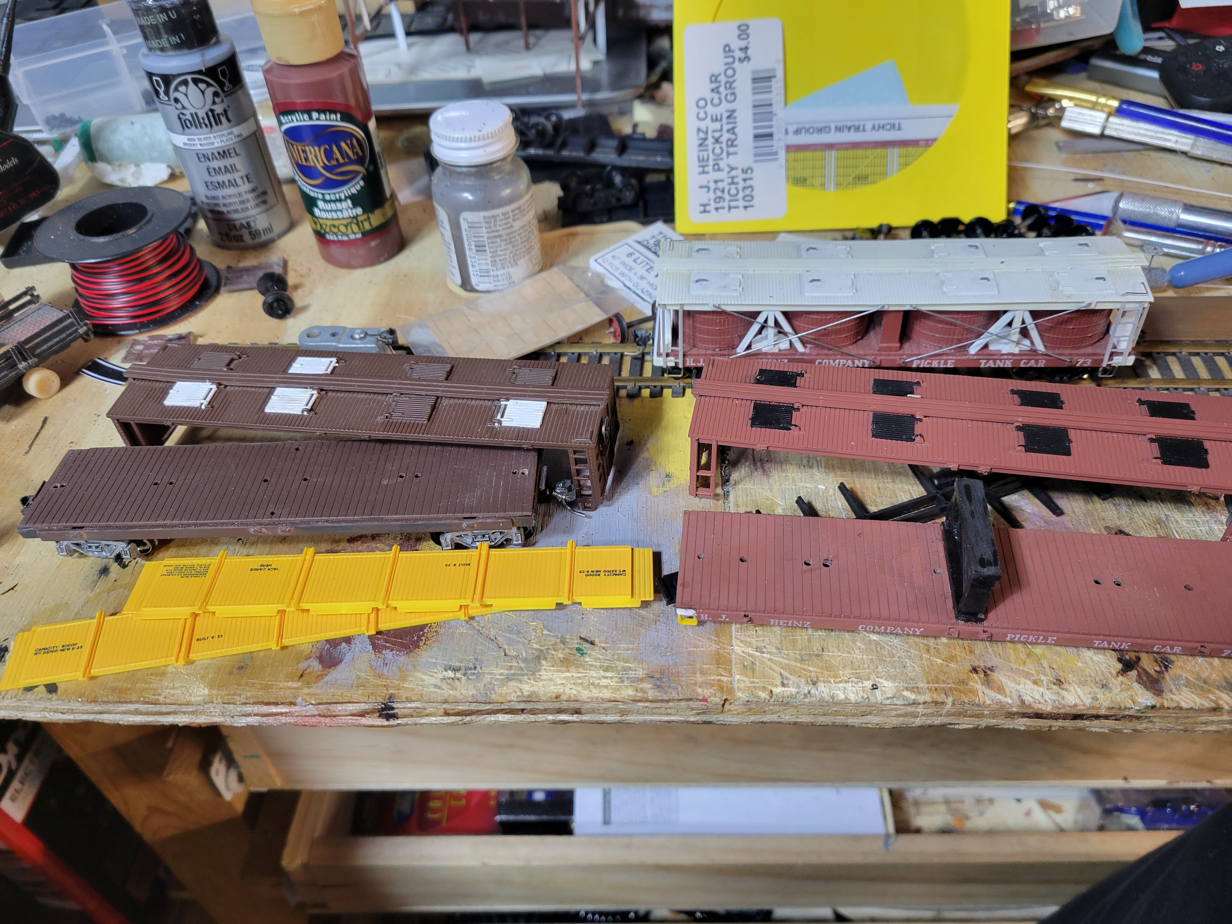

Yes Ben it will be supplier for Heinz and i just finished putting some dullcoat on 2 of the cars.

I got that 1 Pickle Vat car by Revell

Looks really great! The pickle plant has so much detail and is quite realistic looking. Also, I didn't know that is how pickles were transported.

That is an impressive amount of detail on the pickle factory. I also learned something about how pickles used to be stored and transported!

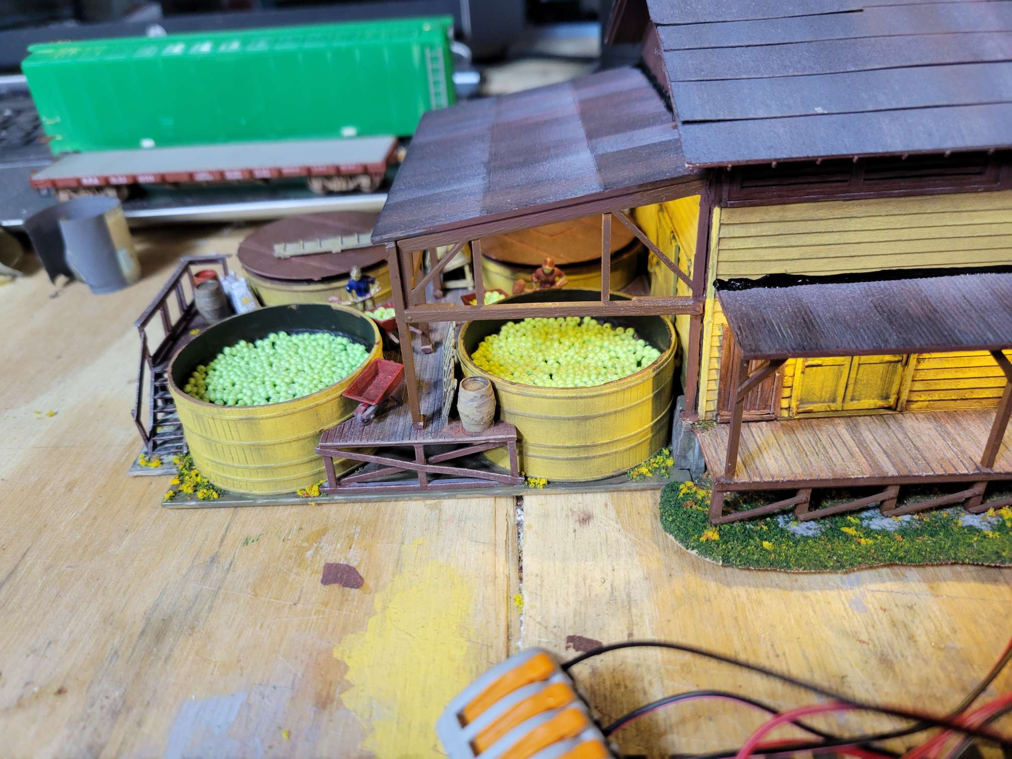

Been Working On lighting the pickle factory and finished the salting platform.

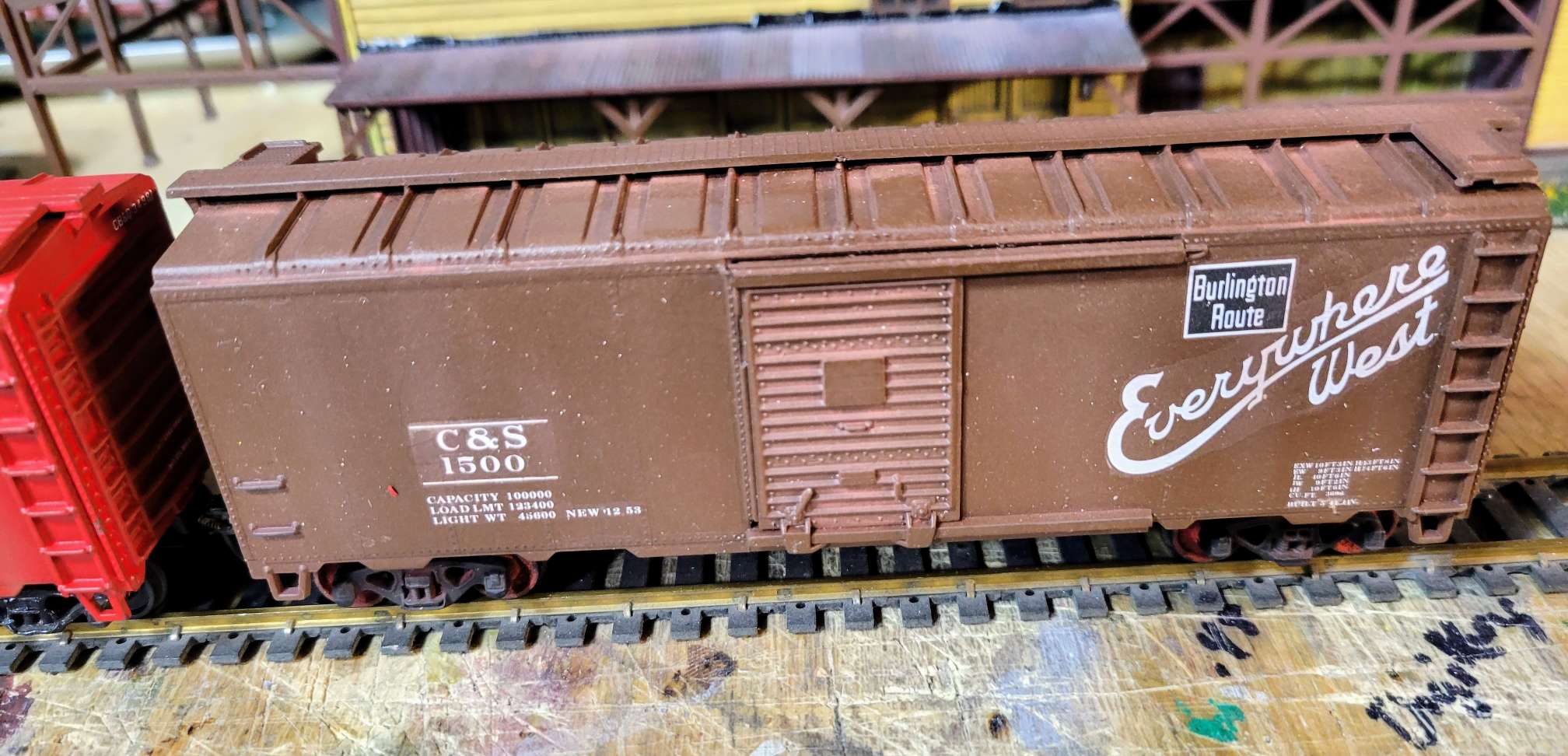

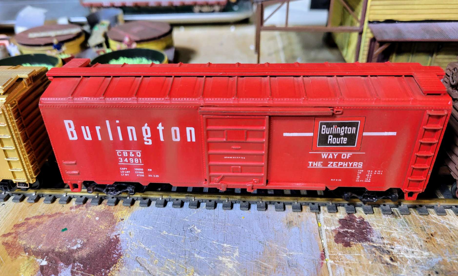

I've also been working on some cars from Ebay. I had some old decals I wanted to use so I bought some junk cars, the pickle car i posted already. The old Microscale decals were breaking apart but I got there in the end

Continues to amaze. Talking dollar cars and revamping them into
top shelf modeling. Love the pickle vats- that kicked it up to a new
level.
